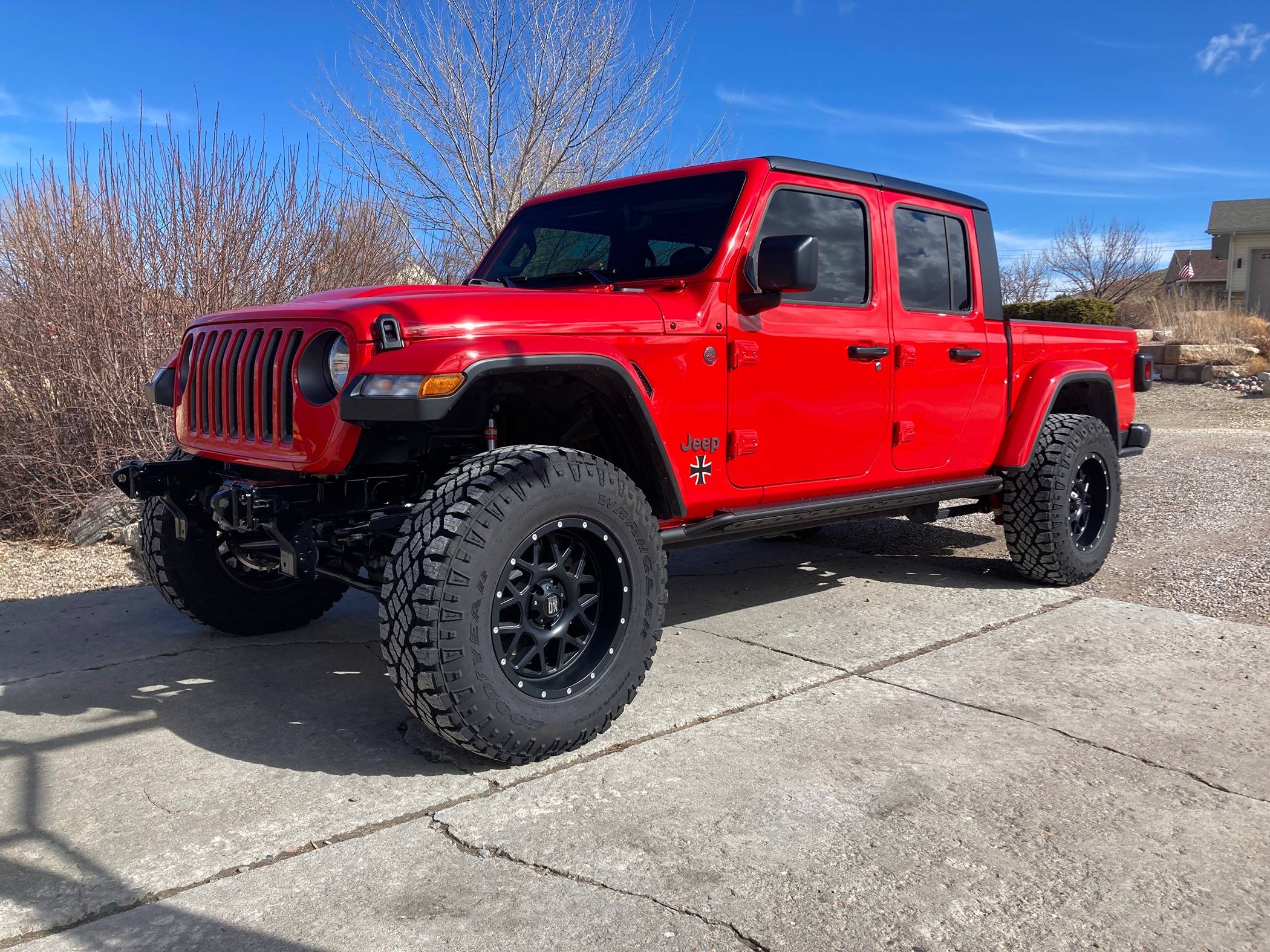

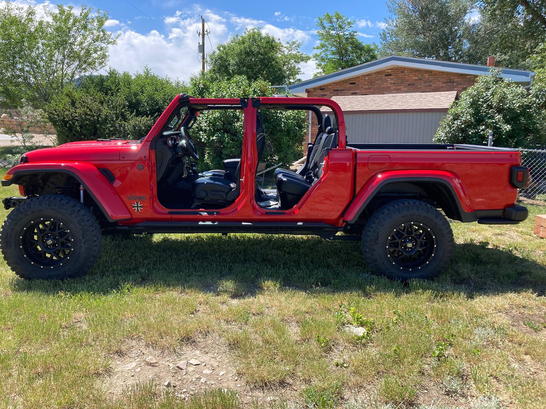

This is '23 JTR, stock rear, +2" coils and shocks front, with +5/16" LCA's.

The Synergy coils are a little softer than the stock JTR springs, honestly, after a couple beers, I can't tell the difference between this and a Mojave. It's really nice.

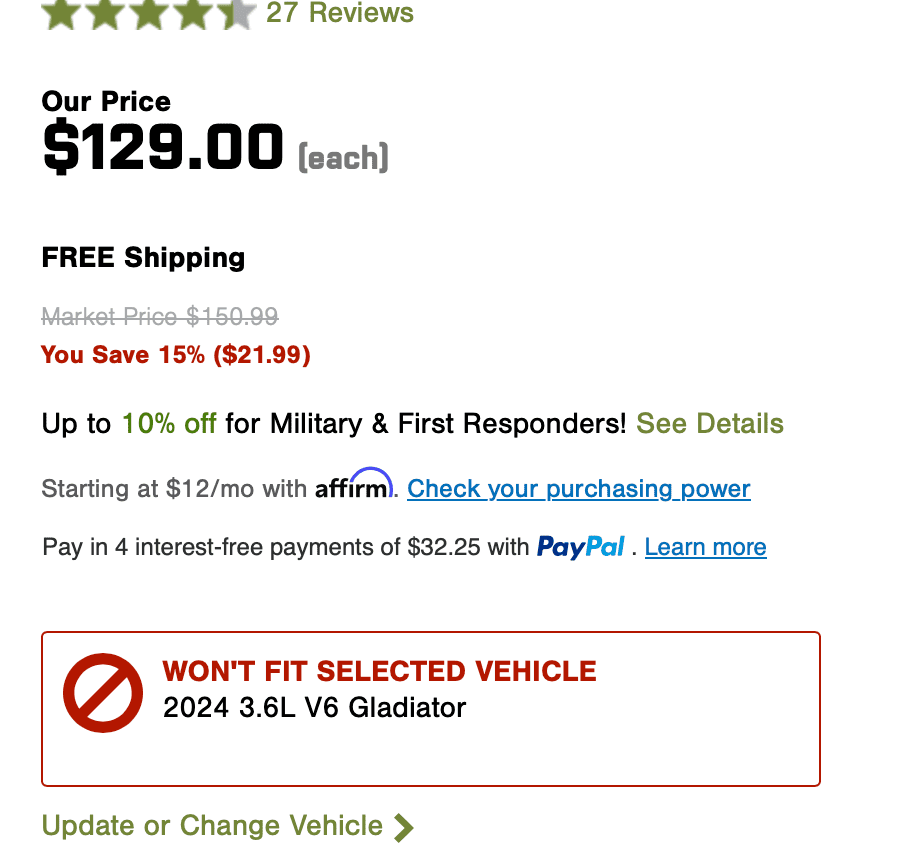

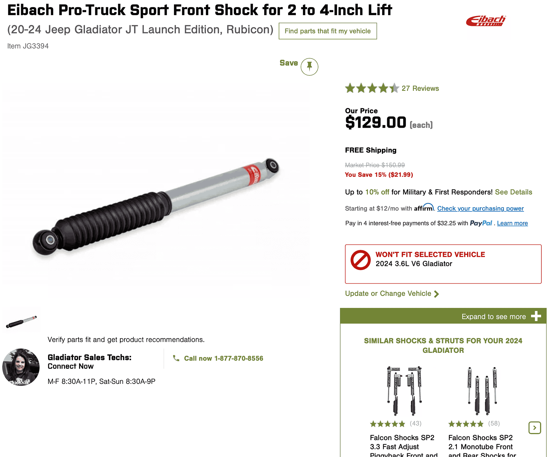

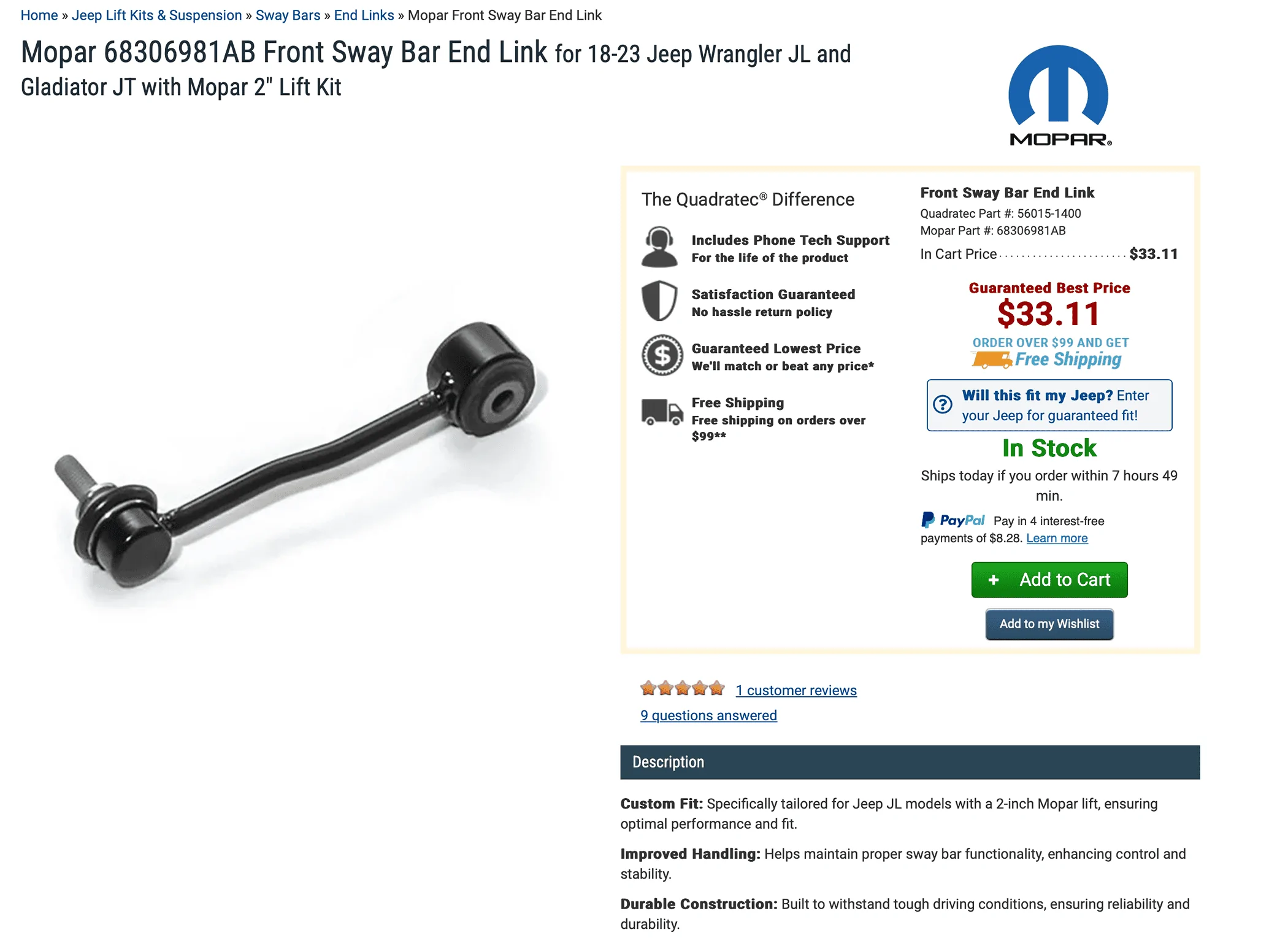

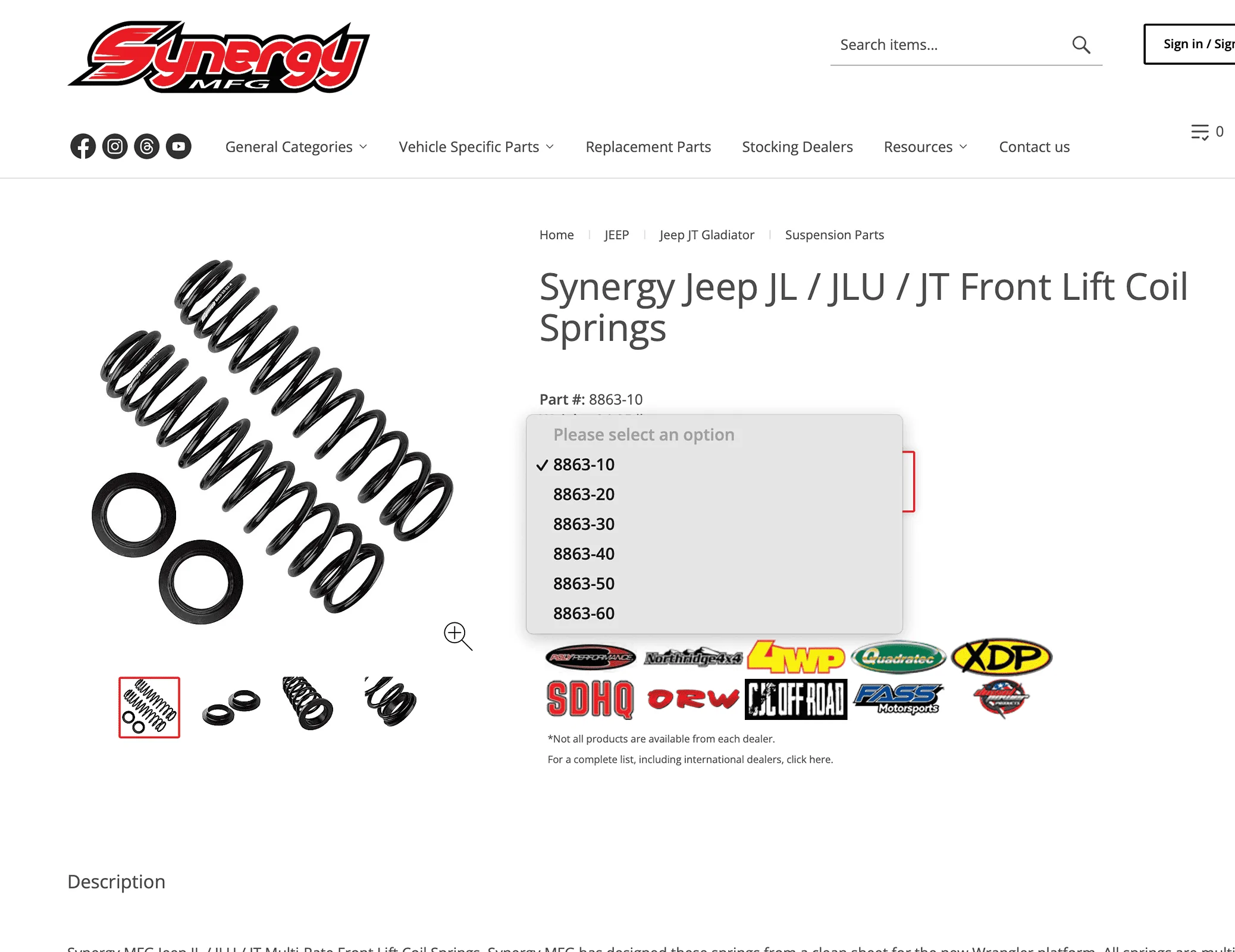

Thank you, so couple of things, I don't see the actually lift or the spacers?
The shocks it says it won't fit my 2024 ?
Front Lift coils there is a number of those?

The +2" coils are the lift, you wouldn't need spacers. The shocks, sway bar links, and LCA's are just parts needed to accommodate the 2 inch lift. The shocks should fit, they just haven't updated their website for 2024, but you can always ask them. With two 6 ton (tall) jack stands, two 3 ton (shorter) jack stands, floor jack, 3/8 impact and 1/2" torque wrench, you can install everything in your driveway in 4-6 hours, if it's your first time. There's a lift height chart on the spring page, for JT 2" lift, you would order PN 8863-20. Those springs have a lifetime warranty.

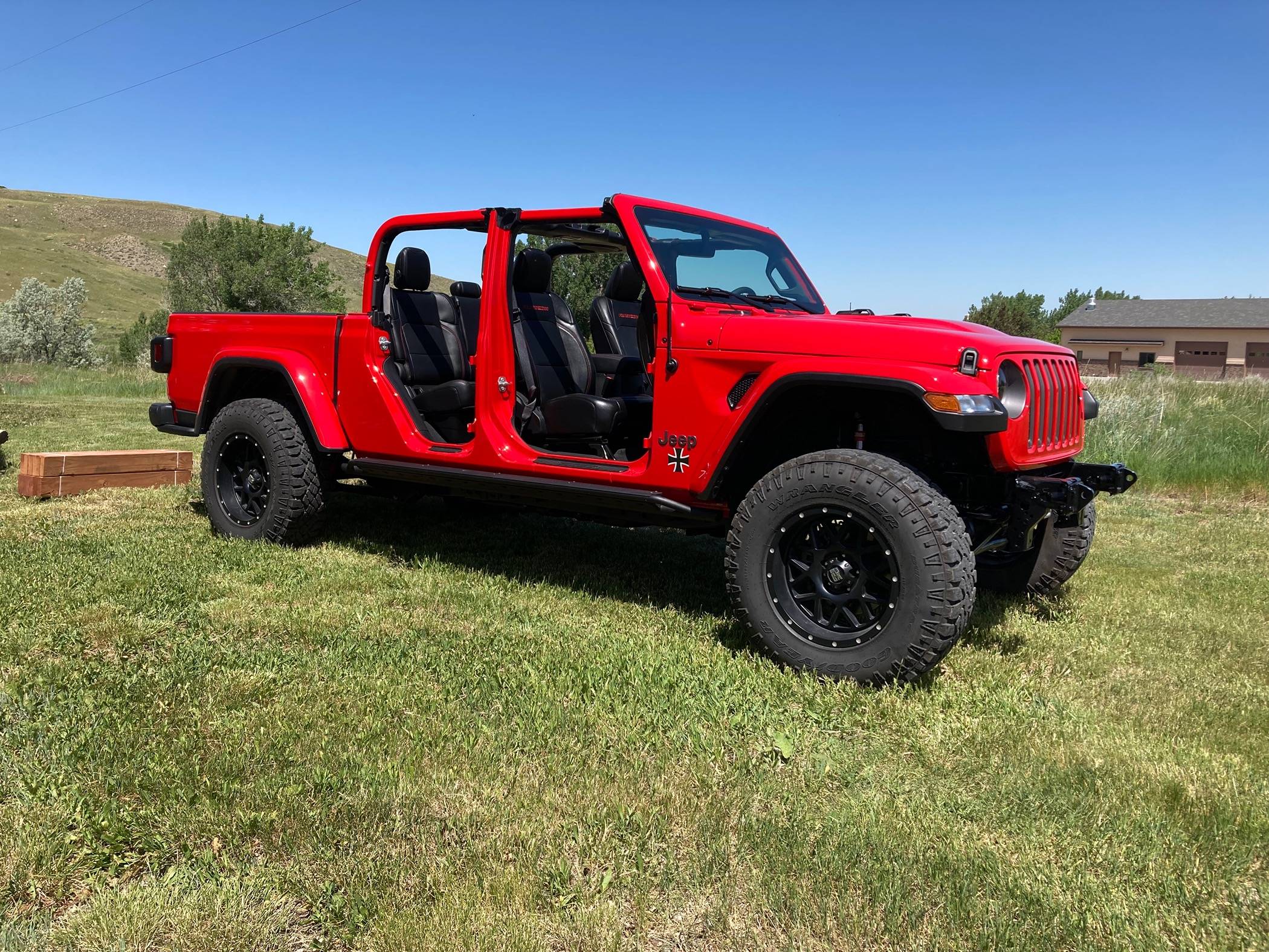

And the back?
Leave it stock. Get the front finished out, if it's got a Carolina squat, you can just add 1 or 2 inch coil spacers in the rear for around $50 to bring it up a little, if need be. With that setup, you will retain your factory load and tow ratings, and run up to 37" tires, but I wouldn't advise anything over a light 35", as your gear ratio is probably 3.73.

Thank you for great input, So Im thinking all those parts should fit in my 2024 sport, the arms etc. even tho it says on the shocks it won't :))

Call Extreme Terrain and/or Eibach to confirm, they may give you a different part number.
