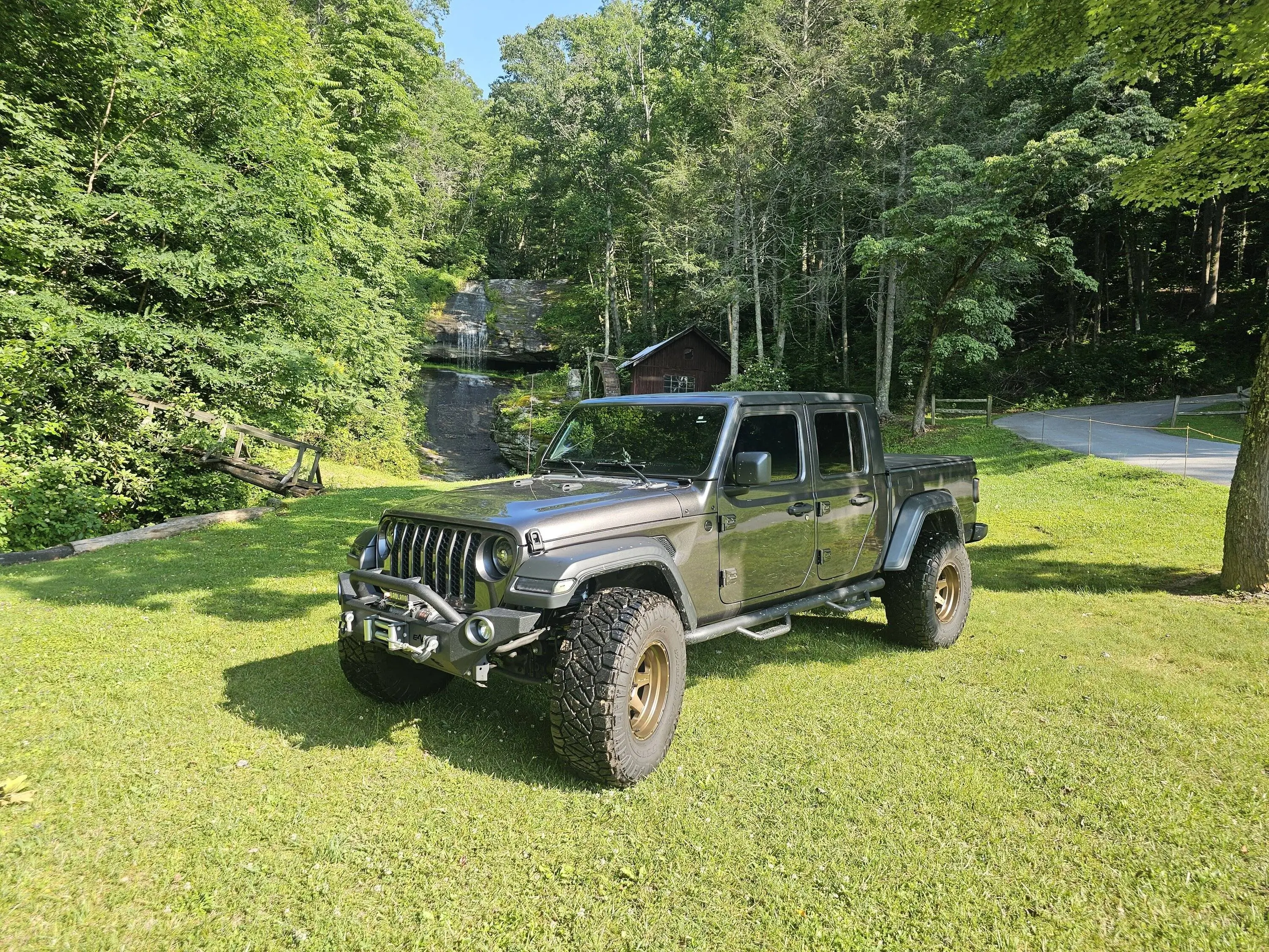

We have a For Sale forum in case you are looking for front doors and tops?? Nice color and side steps/sliders.
Thx but it came with the hard top and soft top.

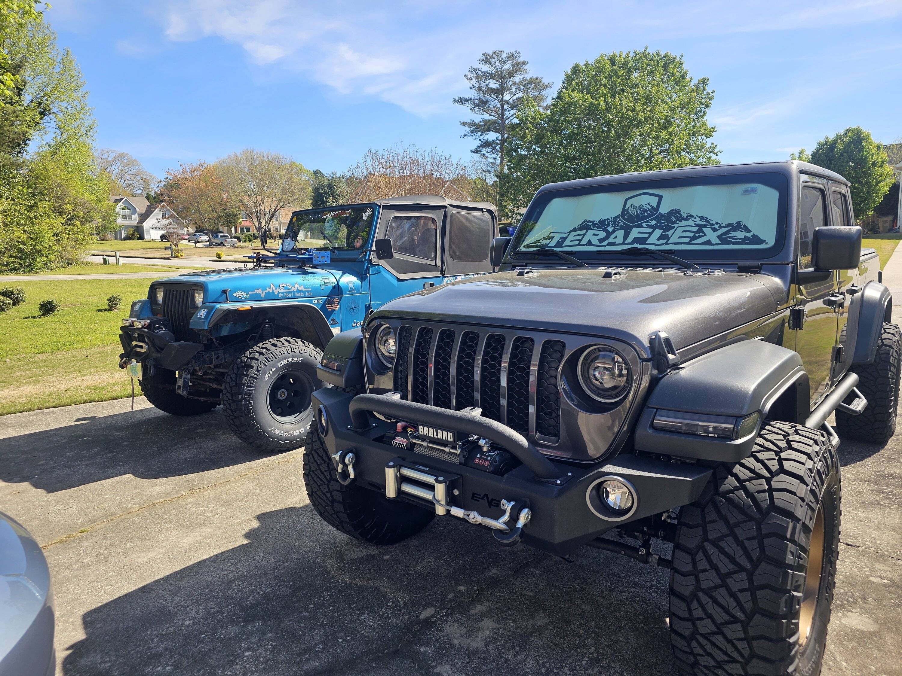

I run 37 x 13.5 x 17 with the Mopar 2" lift. No issues. Max tow package , 4.10's. It does what I need without issue. Most of my driving is highway and mostly flat. No off-roading. This is my DD truck. I have a 93 YJ for trails, etc. Do you know if you have the max tow? It makes a difference. As others have stated. It depends on your use and surroundings. A re-gear might be in order. Congrats! Nice rig.
I love that! Those are the tires I'm hoping to put on at some point, but I don't have the max tow package. Mostly it'll be my daily driver. Pretty flat but lots of rolling hills here. My wife and I are planning a few trips for some off roading, but we aren't gonna get too wild with it. Thx for the info and the pics.
