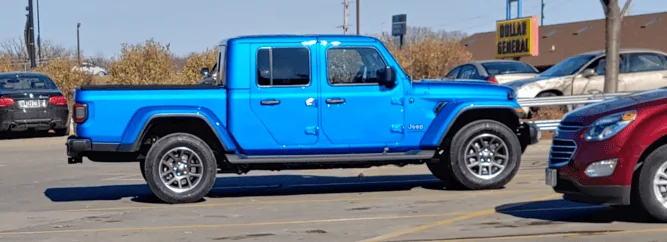

Yes that looks like the Mopar 2 inch lift, also if it's a Jeep dealer their service dept should be able to punch in the VIN and tell you, if a Jeep dealer did the lift.

Looks like someone removed the rock rail and put on plastic sliders
I didn't notice that. Guessing the lift was to much for someone to easily get in and needed more of a step.

So i have officially bought the 2020 Rubicon Gladiator as of yesterday! It has the mopar lift on it (all black Fox stickers).
Is this officially considered a 2" lift then?
Yes the only lift Mopar currently has for the Gladiator is 2 inch.

That’s lifted, for sure. Looks like the mopar 2ā€ lift.
Is it used? Looks like a lot of spray from driving around. Possibly the GM, Sales managers demo?
I hope it’s a demo, Jeep gives the dealership like an extra $2,500 for them. This means you have an additional $2,500 in bargaining power.

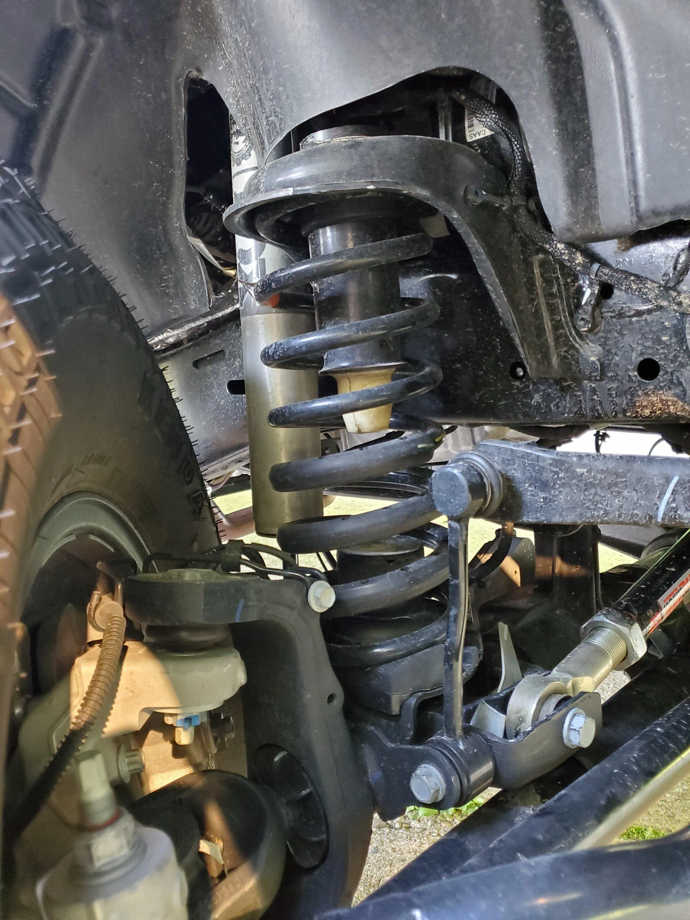

Here are the shocks from a Mopar 2" lift kit purchased about a month ago. Looks like the same ones. The Mopar kit comes with Fox 2.0 shocks, taller springs, longer lower control arms, and longer sway bar end links. It lifts Sports noticeably more than Rubis or Majaves. It does NOT come with any way of centering the axles, so I added a front adjustable track bar and a bracket for the rear track bar. Pretty impressed with the lift.

Here are the shocks from a Mopar 2" lift kit purchased about a month ago. Looks like the same ones. The Mopar kit comes with Fox 2.0 shocks, taller springs, longer lower control arms, and longer way bar end links. It lifts Sports noticeably more than Rubis or Majaves. It does NOT come with any way of centering the axles, so I added a front adjustable track bar and a bracket for the rear track bar. Pretty impressed with the lift.
Heck - the lighter set of stock Rubicon springs will lift a typical Overland 1" so yeah, anything that lifts a Rubicon that much would likely do more on the others.
The heavier stock Rubicon springs usually lift an Overland over 1" - like 1.25" in some cases.

Those are the MOPAR side steps. I like them. Got them second hand for my wife's wrangler.

Looks like Overland "running boards" - my wife love's em with her knee issues.
I don't! I'm 6.5" so they are of no use for me and all they do is rub on my pants as i'm getting in. Once i find something to replace them with they'll be gone!
