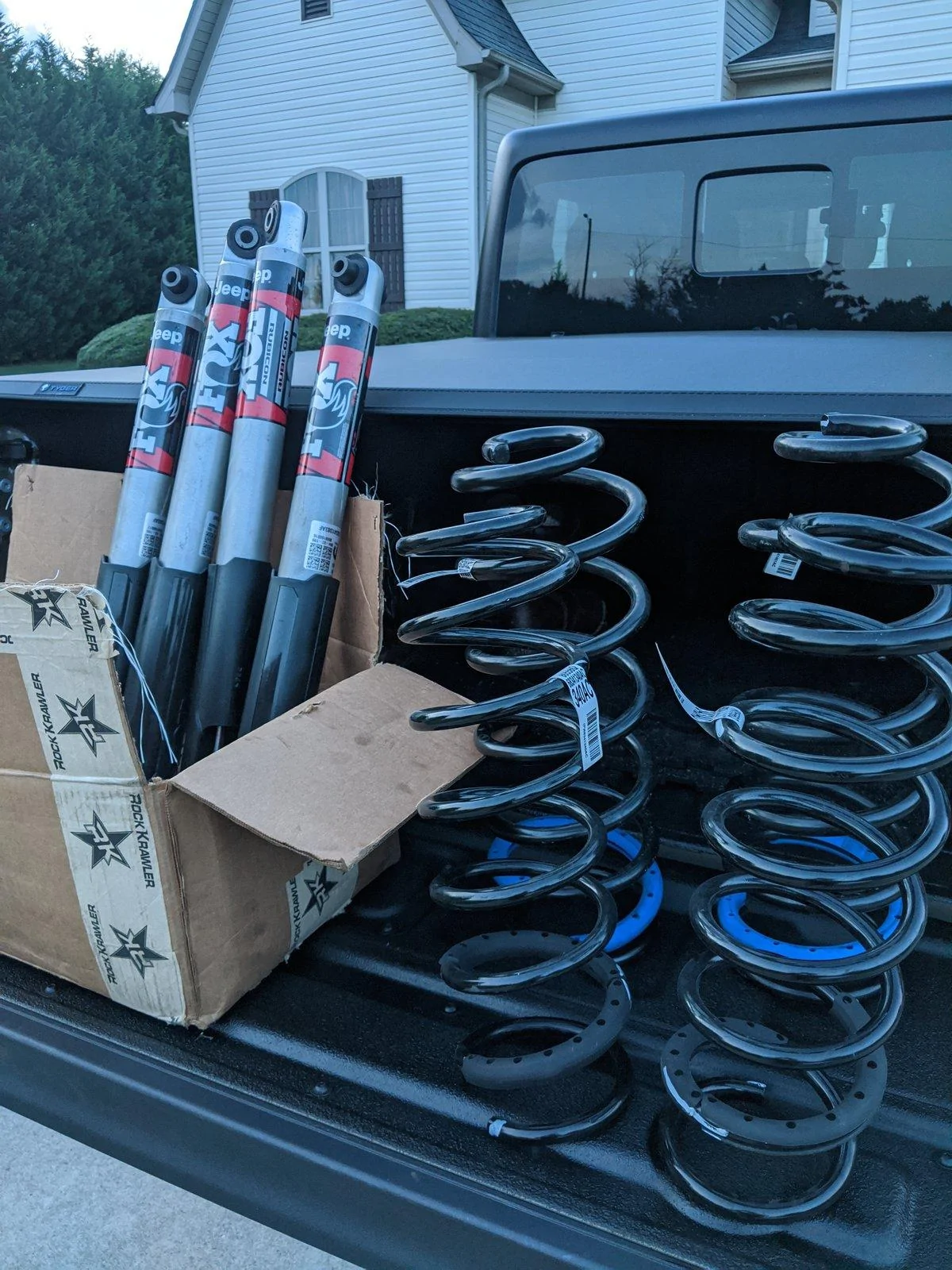

I have everythiing except a lift - I did it in my garage (shop was full) in 3-4 hours, taking my time in the humidity and running between shop for tools and jacks and garage where I was working. I have a whole thread on the process I used with pics.
I have an Overland. I put Rubicon springs up front - raised it about an inch.
I put max tow springs on the rear to handle the weight better, dropped it about half an inch. I put Fox shocks (Rubicon take-offs) all around. Ride is totally different, better.
I used two floor jacks, a bottle jack to shove the rear axle down. Two wrenches, 4 sockets, a cordless impact, impact swivel, breaker bar and torque wrench.
Watch the FAD wire up front- I have pics of what I did there - didn't even unplug it! Plenty of slack after taking one of the clips loose.
Rear - brake lines barely had length but it worked out. If I was adding lift I might have taken the rear calipers loose.
The front there was plenty of room - even with the Rubicon springs I had so much space there was over an inche above the springs and I had to hold the top spring isolators up in there and guide things back into place.
No big deal - I'm 63, about 25 pounds over-weight and have arthritis.
So I had a handicap going in.
Shop wanted over $600 to swap 4 springs and 4 shocks.
I could have saved time had I coordinated taking the things loose as I had the front wheels turned left or right. Instead I turned them left, took loose what I could, turned them right, took more loose, oops, need to go back left to take that loose, then back right. I could have shaved a few minutes off easily.
My bet - I could do it in 3 hours now, especially if I was in my shop with the AC and much better lighting and even floor with no rough spots.
It was easier than any car I'd ever swapped springs in or rebuilt suspension on.
The difference in handling, steering and ride - amazing and love the roughly 1" lift up front. Sticks to the road a lot better - like the results you had. The shocks, I shouldn't have waited so long to do it!

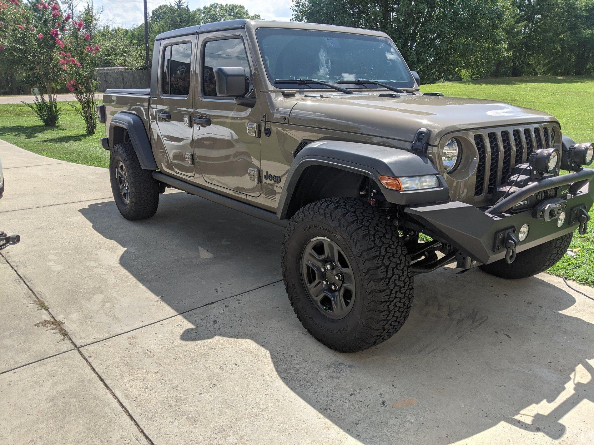

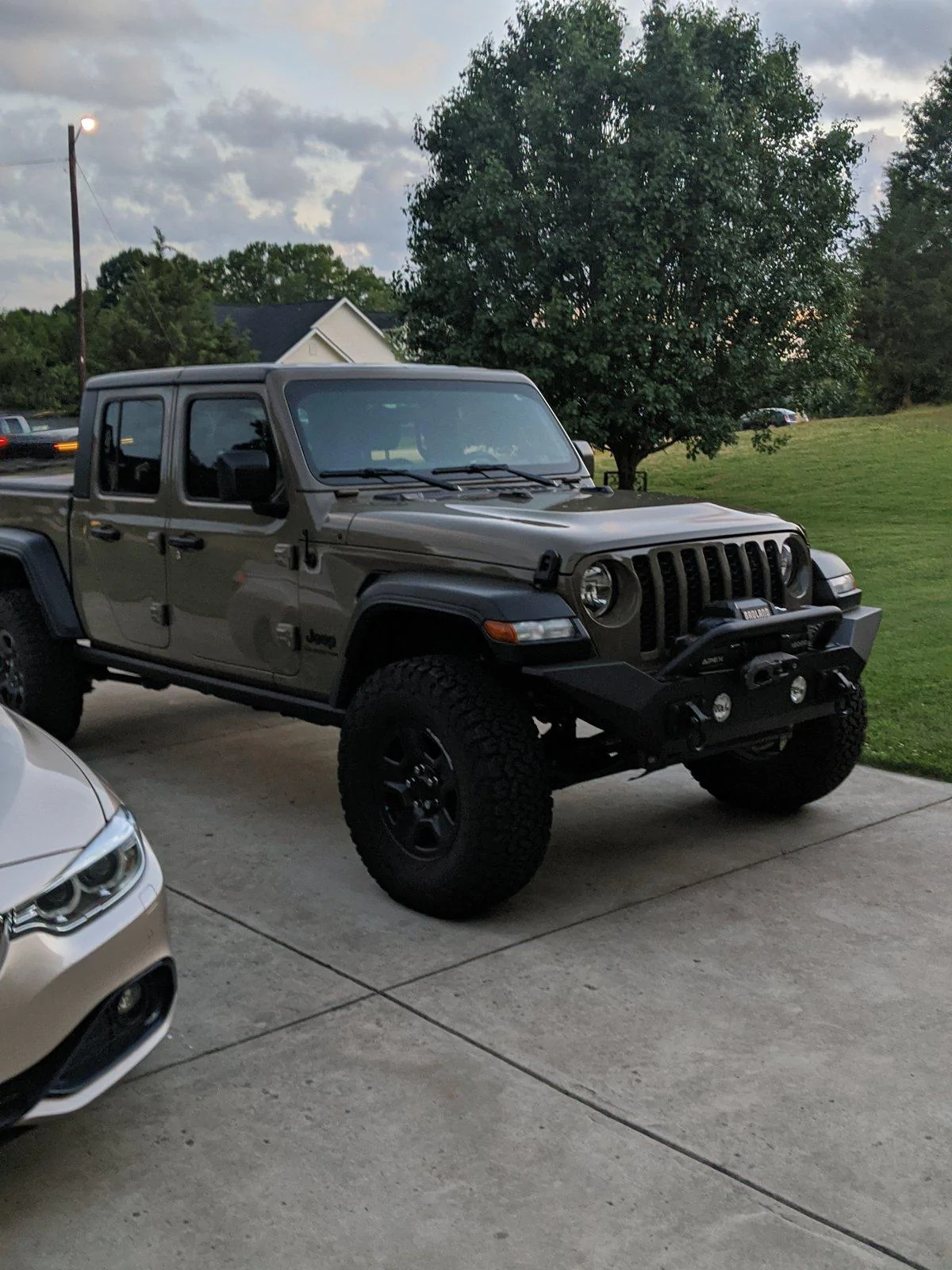

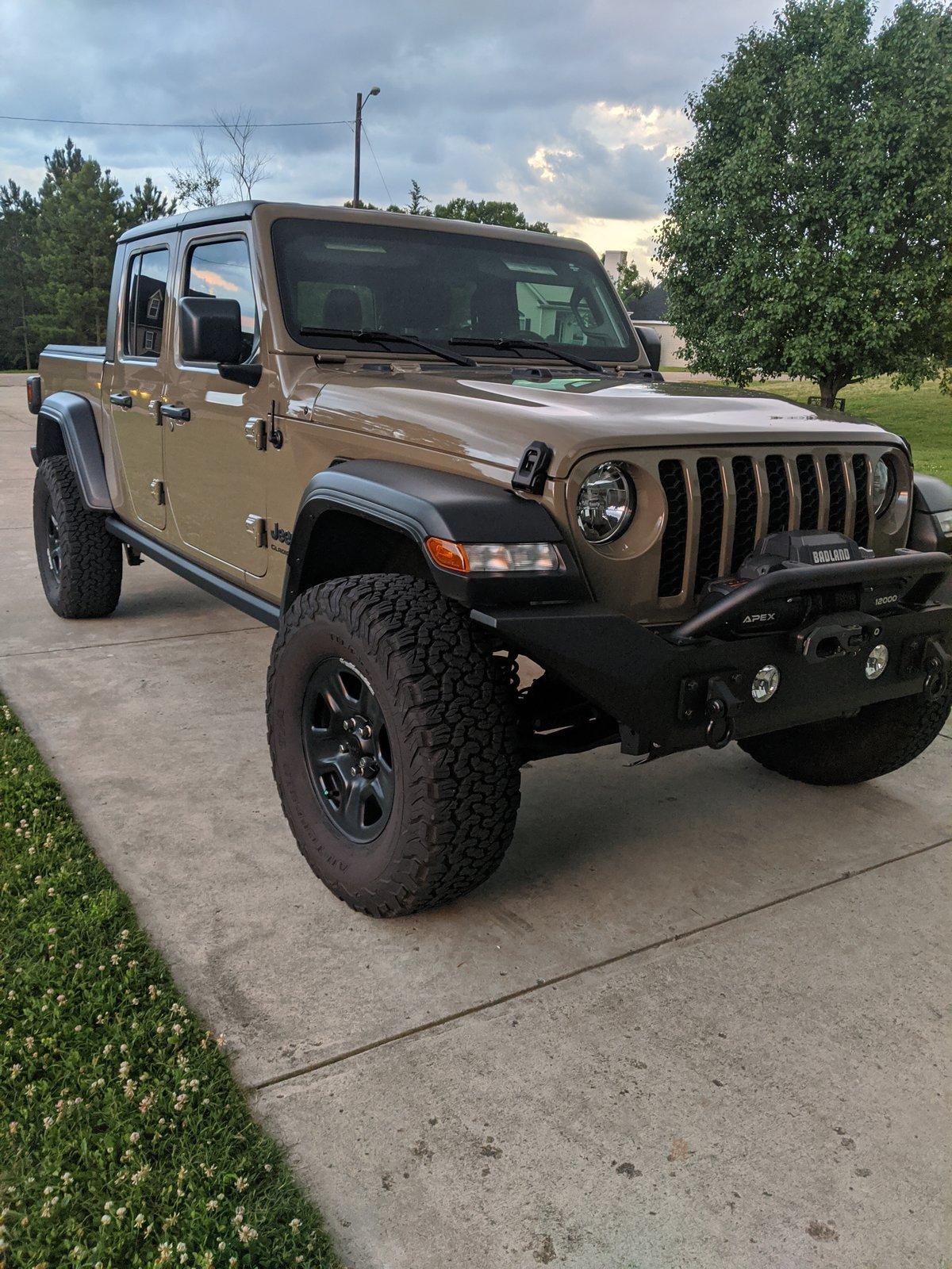

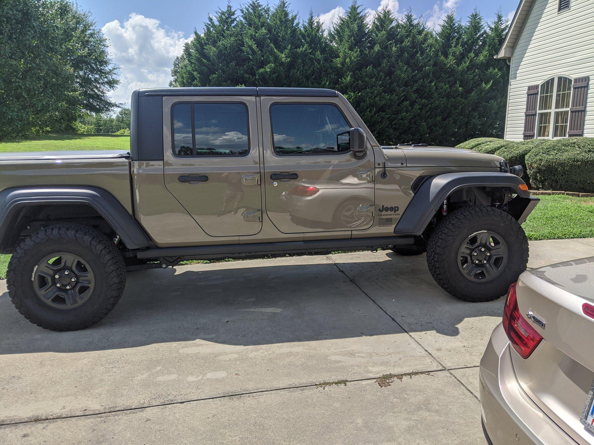

More level than it was - about the right "rake" for me.
So not level, but close to what I was hoping.
I need to pull it out of the garage tomorrow and get a couple pics to compare to the "before" pics I have from a few months back. I can tell when driving it that the front it's as low as it was.
