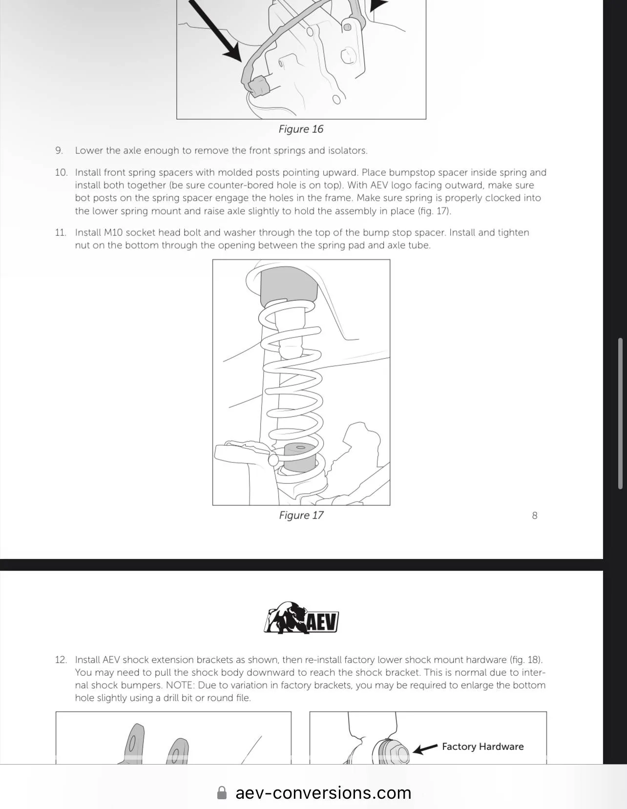

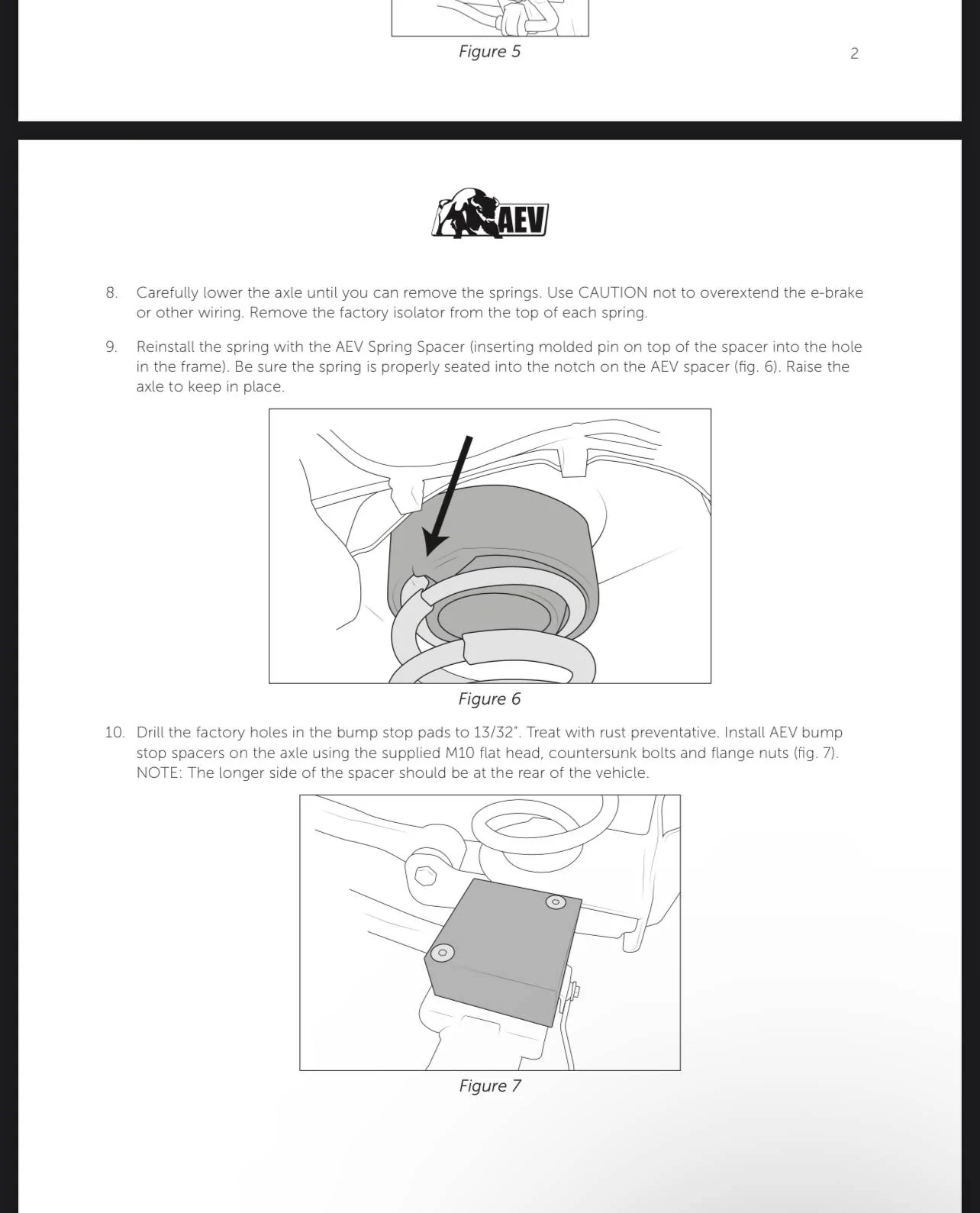

Can anyone confirm if this kit requires you to keep and reuse the stock spring isolators, on top of the AEV spacers? Instructions just says to remove them and insert spacers on top of the springs, so I assume you dont need the stock isolators. But just confirming cause a friend of mine is giving me this kit and I think I'm going try it out until I go with the actual AEV Dualsport eventually. Can't complain for free.
But with the Teraflex "front only" 1.5" spacer lift I currently have, I'm pretty sure I kept the isolators on top of the pucks when installed, which is why I ask.

Exactly what I thought but the instructions don't mention it and seem vague. Just says to remove but then install the spacer.
Rear instructions
Jeep Gladiator AEV 2” spacer lift, is it really that easy to install? 6B8042E3-C965-4475-A657-DB465ADF6A7E
Front Instructions

I'm pretty sure you don't use the stock spring isolate with this kit. The top pucks have some knobbies at the top that fit into the alignment holes.

Those instructions basically tell you not to use the isolator just by the way they say insert the pin from the spacer into the frame. Sounds like that’s your answer.

Just installed the AEV 2 in spacer lift on my truck. The stock isolators are not used on top of the spacers.
The AEV spacers have 1 (rear) and 2 (front) small nipples that portrude from the top of the spacer. Those nipples fit into the upper spring buckets.
The stock isloators also have the same nipples.
