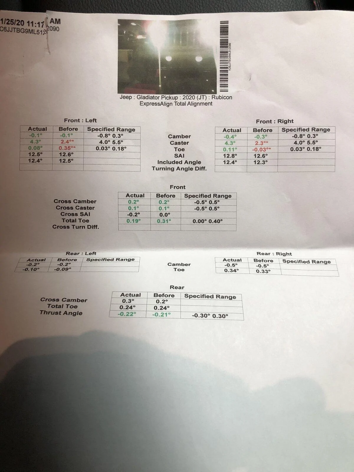

I thought the caster and camber are both set and can’t be adjusted on the JT? Only toe in adjustment would be needed as far as an alignment goes.
True I was thinking adjustable arms, but either way an alignment shop would be the preferred method for toe. Camber is most certainly fixed on a stick axle. The shop can also do steering wheel centering based on toe outcome.

If you are installing a Mopar 2" lift there is no alignment needed the only thing you need to do after install is center the steering wheel, takes about 5 minutes. You cannot adjust the caster with fixed control arms.
You can throw toe out just by tearing things down. It’s happened to me with just a spacer. Are you not recommending a front end check after a lift of any sort?

The toe will not change with most lift kits, waste of money to have it “aligned” as there is nothing that needs adjustment other than steering wheel being centered
Here is the toe out for my 2021 I can show you one for my 2020 too. Only speaking form experience.
