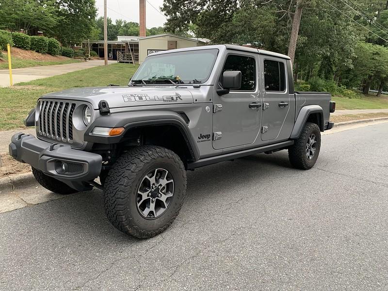

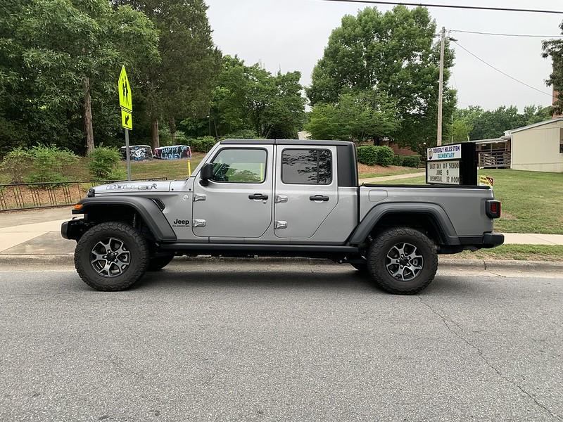

This is the Mojave springs on all four corners, with Rough Country 2.5" spacer kit up front, Gladiator Fox shocks all around, with Fox steering stabilizer. Right after installing the spacer kit:
Jeep Gladiator Those Who Swapped to Rubicon Shocks/Springs 52129333359_a931f6fcc9_c

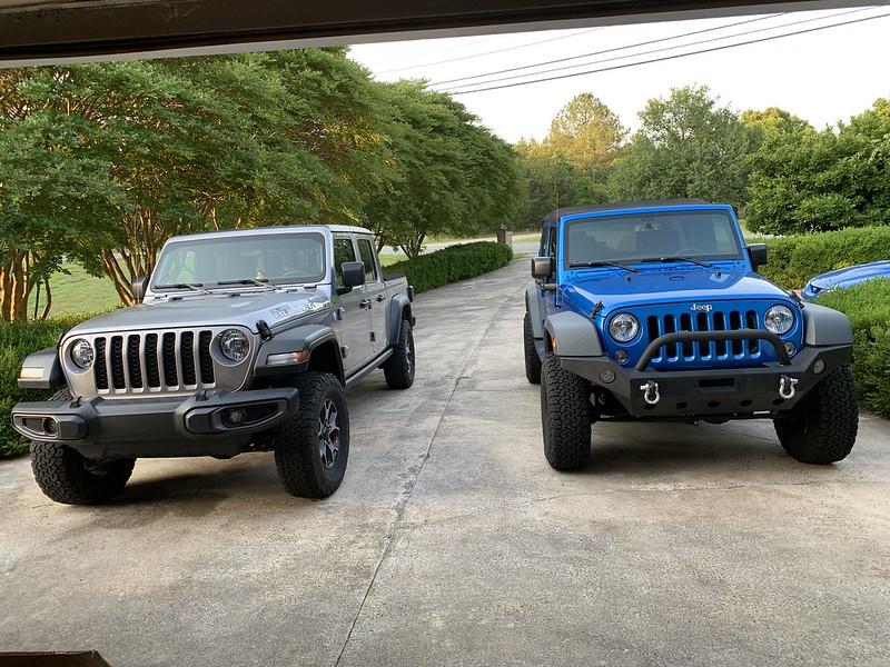

Compared to the wife's Wranger with 2.5" Teraflex lift kit and 285/75R16 BFGs
Jeep Gladiator Those Who Swapped to Rubicon Shocks/Springs 52129333389_df6dfec064_c

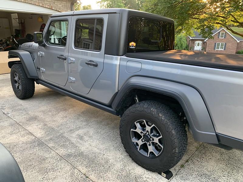

Some pictures from this morning:
Jeep Gladiator Those Who Swapped to Rubicon Shocks/Springs 52129589340_e6e7b6ca9b_c
Jeep Gladiator Those Who Swapped to Rubicon Shocks/Springs 52129333399_3fa26ab09e_c
