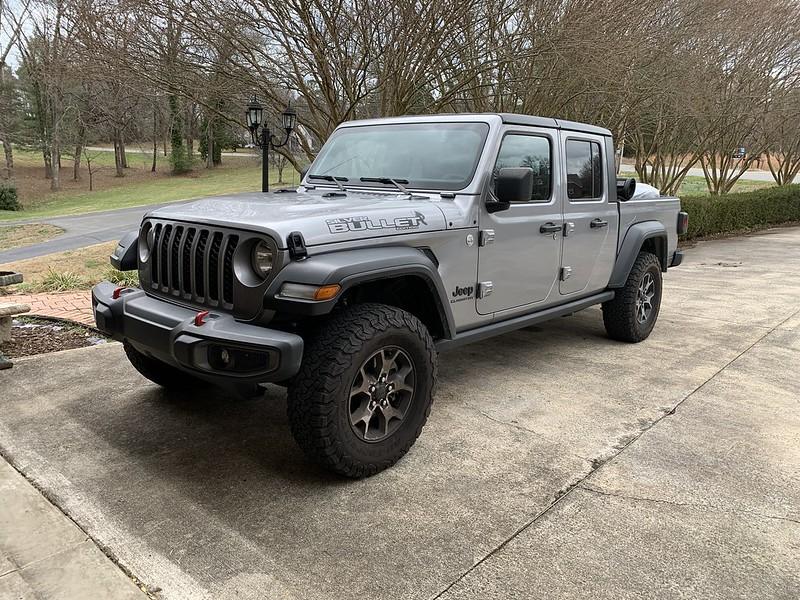

Already had the Rubicon Fox shocks on the Sport, but had a chance to install Rubicon springs just in the front this past weekend. Doesn't seem to have lifted as much as I'd hoped, but it definitely rides and drives different. For the slightly better.
Yeah I only gained 3/4 of an inch with the stiffest Rubicon gasser springs. And I actually swapped the Rubicon Fox shocks back out for my stock Willys shocks and I like the ride much better. JMO

That's good to know. Seems like about 3/4 of an inch is all that was gained after driving for a few days and letting everything settle a bit. Also have a set of Mojave springs, may try those out to see the difference, and if it drives even better or gets worse.
