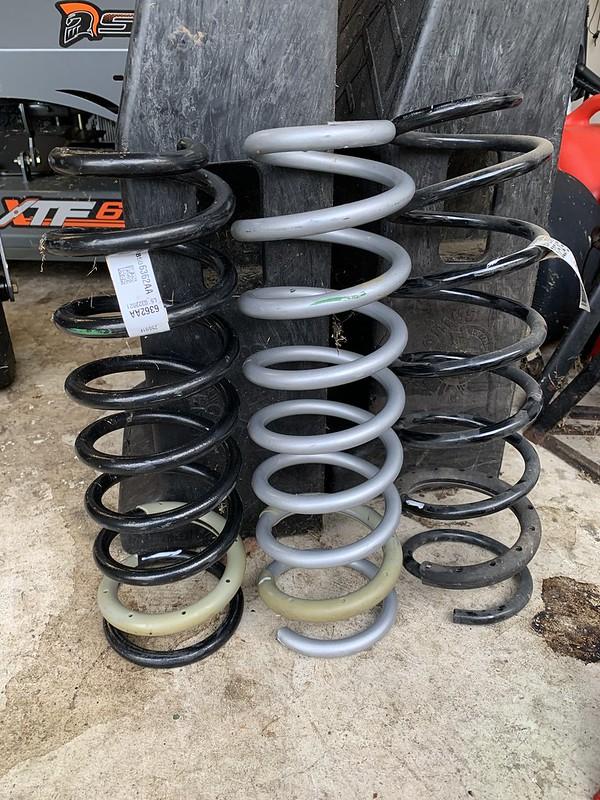

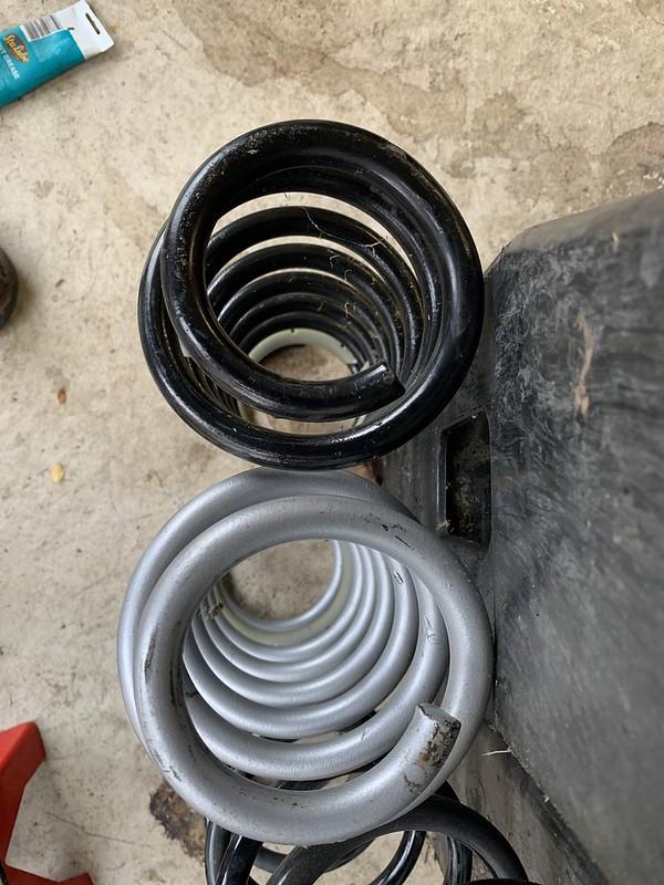

I haven't swapped the rear springs yet, still running the stock Sport - but can definitely tell they are the weak link compared to the Rubicon spring swap up front.
Still wondering if going to the Mojave would be better (have a set of those at the house too) - check out the comparison I did between (left to right) Rubicon, Mojave, and Sport - the picture with two springs is the Rubicon vs Mojave

No doubt - I was surprised to see the Sport springs being taller, but you can tell the coils are much thinner than the Rubicon, and WAY thinner than the Mojave. Friend of mine said he didn't know if pairing the Mojave springs with the Rubicon shocks was a good idea, could make for a very uncomfortable ride - so I installed the Rubicon springs instead. Now thinking about trying the Mojave at least just to have a comparison.
I've seen a couple write ups from those that did just Mojave springs and they appear to be favorable. I would be interested to hear about your results as well. From what I recall the Mojave front springs added another 1/2" or so over the Rubi front springs. So that may give you the result you were hoping for with the Rubi ones.
Honestly now that I'm about 6 months and about 4k miles into the Rubi springs and shock swap, they've grown on me. I still like the way it sits now vs the stock JTO springs. That small difference in height IMO just looks better. One thing I did do though was add some more weight in the rear. I had noticed how much better I felt the ride was with a small load of a couple bags of mulch or dog food that I looked at ways I could add some more weight. Since Rubis have the added weight of the bed rails, extra tow hook, and steel rear bumper. I figured this may be part of the ride difference. I did add the extra OEM tow hook, which was only a few pounds, and replaced the factory spare with a matching size. That added about 20lbs+/- in the rear overall and it honestly helped with my complaint about the rear bucking.

Put the Mojave springs on all the way around about 3 months ago. Didn't gain any height versus the Rubicon with steel bumper and hard top springs, but definitely firmed up the ride and such. I like it better actually. Added a 2.5" Rough Country spacer lift up front though, and now she sits higher than the rear. Debating on where to go next. Thought about the 1.35" ICON rear spacers to level her back out, but for the price, it wouldn't be much more to just go with new springs in the back. And if doing that, why not do an all spring lift up front too.
