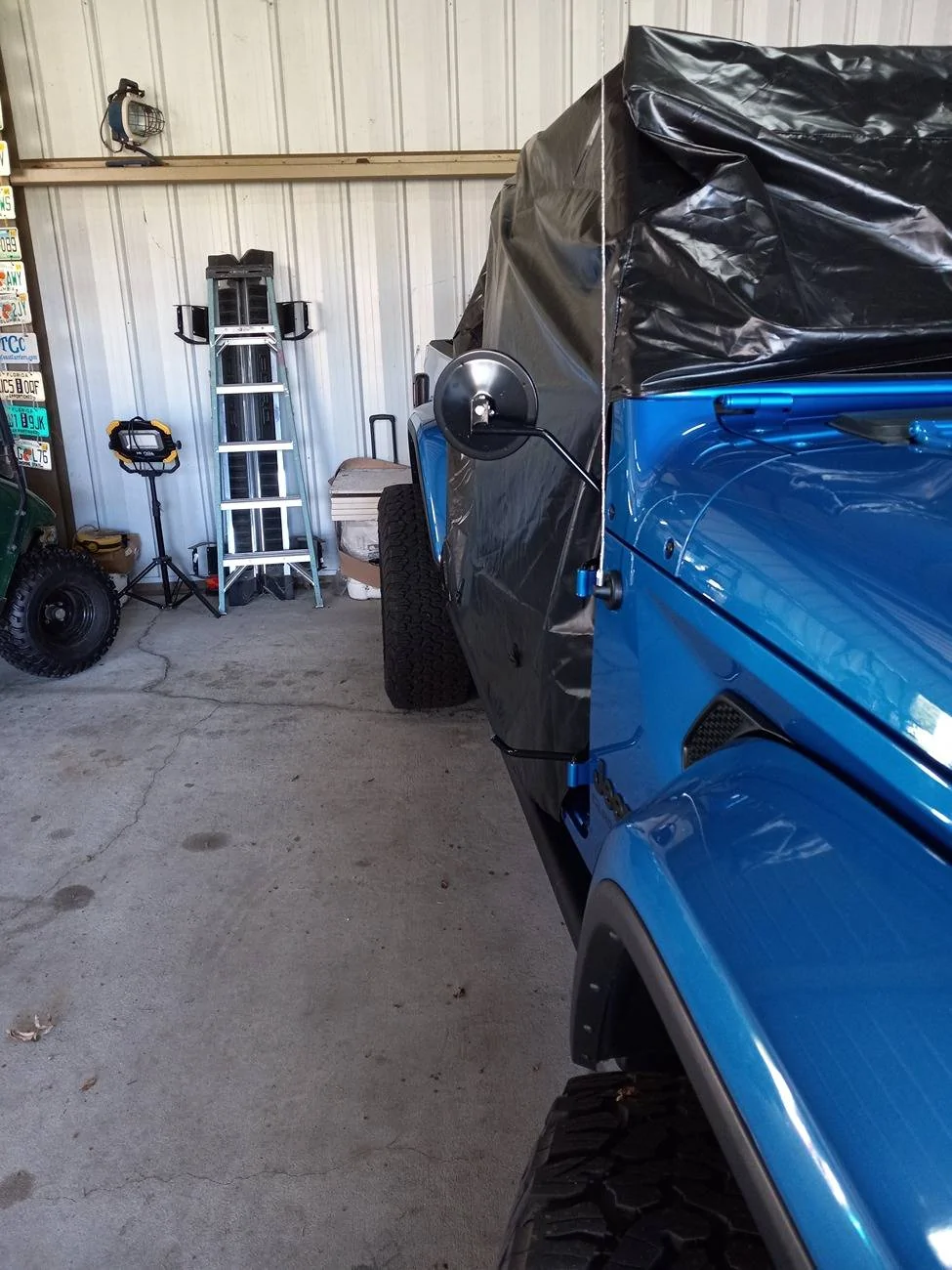

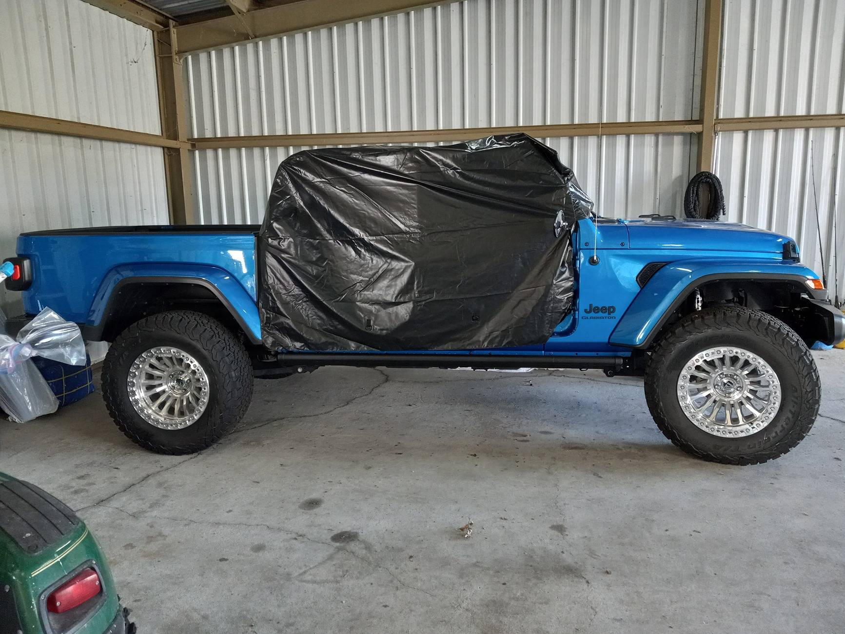

22 Gladiator Sport S Needs More Lift
Heavy D
Dec 19, 2023
110
119
Live Oak, FL
22 Gladiator
Tires are 37x13.5x20 BFGs on 10" wide fuels.
Lift is a 3.5" JK.
I want more clearance and believe I need to go 5" or maybe 6".
Suggestions?
