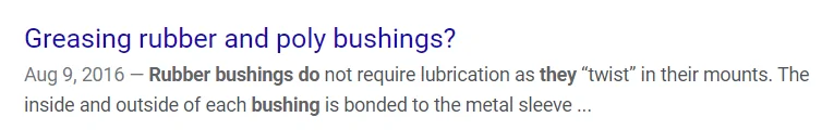

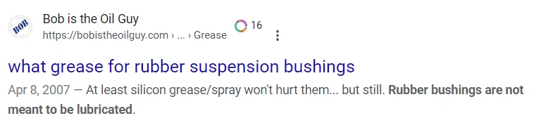

Don't grease rubber bushings!
No, that's bad for the bushing. Anyone who knows suspension and steering will tell you that.
If a bushing squeaks, it's already bad. Rubber bushings twist and distort on the center sleeve and inside the outer sleeve. They don't move on or in the sleeves. Good bushings don't squeak and grease is bad for rubber.
NO! Do not GREASE rubber bushings. My bet is that either something is LOOSE or you have a spring squeak. You can test for a spring squeak with silicone spray. But don't take a bushing joint apart and put anything on it - never use lube on rubber bushings. They are not supposed to move. You'll ruin them.
Rubber bushings only make a sound if they are shot.
Greasing rubber bushings is almost as bad as those who tell others to test an alternator by pulling a battery cable off when the engine is running. both are among the worst of the worst "shade-tree" things that end up destroying, never fixing.
Your bushings are not squeaking -
There is no movement of the rubber unless they are BAD. And if you grease them, you will make them bad.
They are NOT meant to be lubricated -
You will ruin them with grease -
(I figured no one would believe a trained suspension person, so I got support for my comments from the internet)
Bottom line, NEVER grease bonded rubber bushings.
#1 - they don't need it
#2 - it will ruin them
Telling someone to grease them is a bit irresponsible, IMO.
THIS. Never ever. Unless you want it to get worse.
