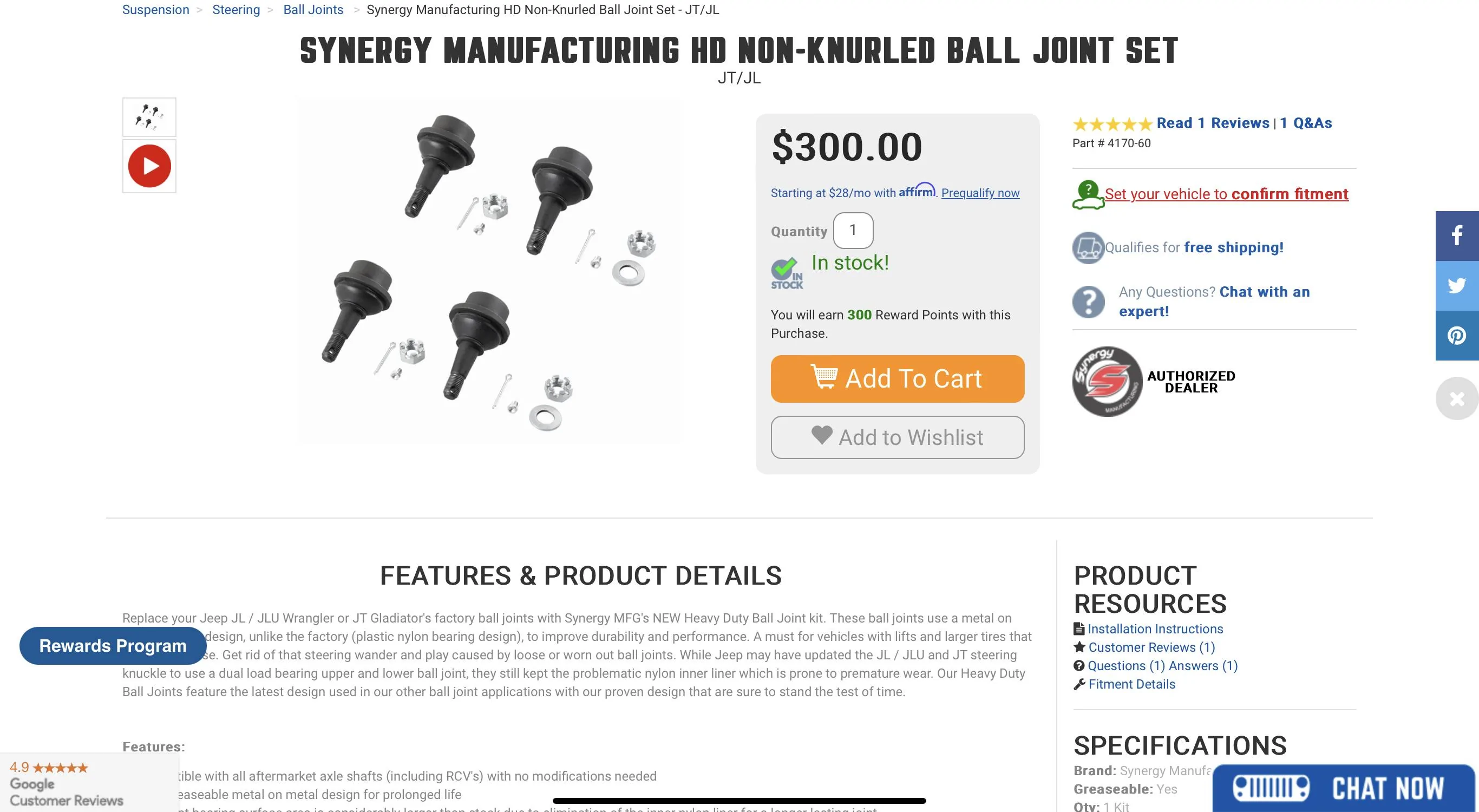

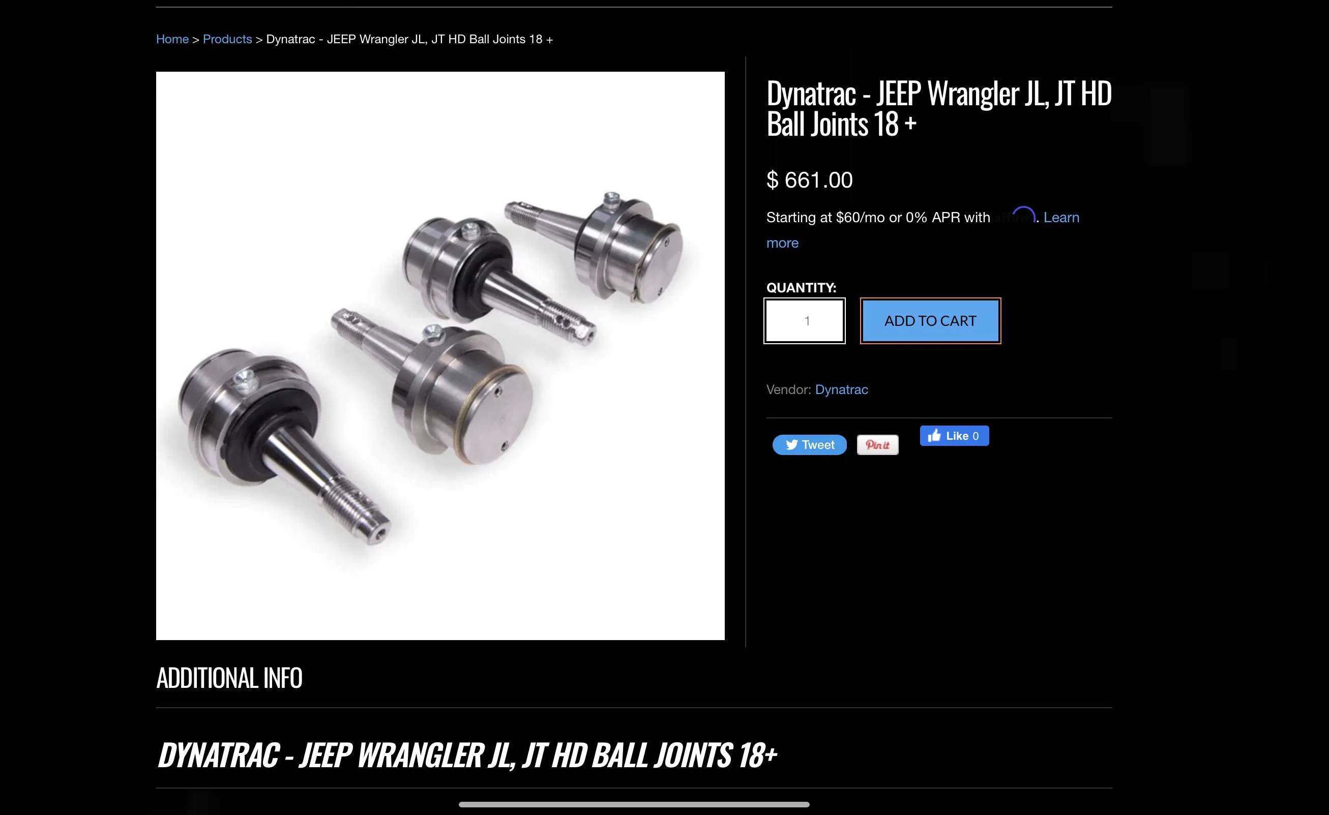

Currently choosing between the Synergy ball joints and the Dynatrac ball joints, Does anyone have any preference ? Going to be running 38s and want to beef up my suspension all around. Thank you !

I would go with the dyna's since it looks like they have a c-clip to help hold the ball joint in place and help prevent pull out.
I have now seen a handful of recovery videos of new jeeps where u joint blows up then pulls the ball joint out. Ball joint pull out seems to be a common failure.

I ended up doing a Dynatrac Pro Rock 44 unlimited / reverse cut in the front, and a Pro Float XD 60 in the rear. So went with their HD ProSteer balljoints. Lifetime guarantee for failure, and also rebuildable. At the same time did the Reid HD knuckles and a Teraflex big brake kit in the front.. the rear axle came w/ F-150 brakes.

I run Dynatrac's on my JK with 37's. Great ball joint and being rebuildable is a plus. When my Jt needs ball joints, they will be Dynatrc's.
