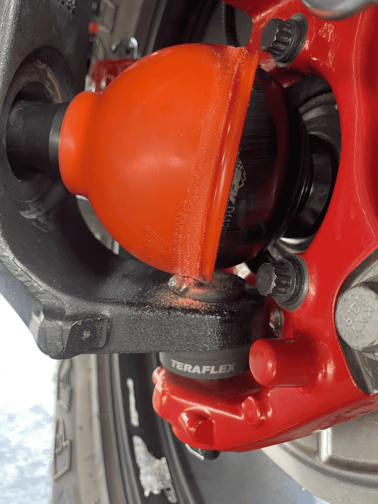

My assumption about the RCV problem is that the profile of the lower joint is too high and interfers/contacts the boot of the RCV.
Below is only given as an example of the tight clearances that can come with an RCV and aftermarket ball joints (this is not metalcloak)
Jeep Gladiator Metalcloak HD Ball Joints 1682691569346
(Picture from: https://www.jeepgladiatorforum.com/forum/threads/rcv-teraflex-👎🏻.60843/)
I believe that this issue has been addressed for Teraflex by rotating the lower install by 180 degrees... but I am not positive
