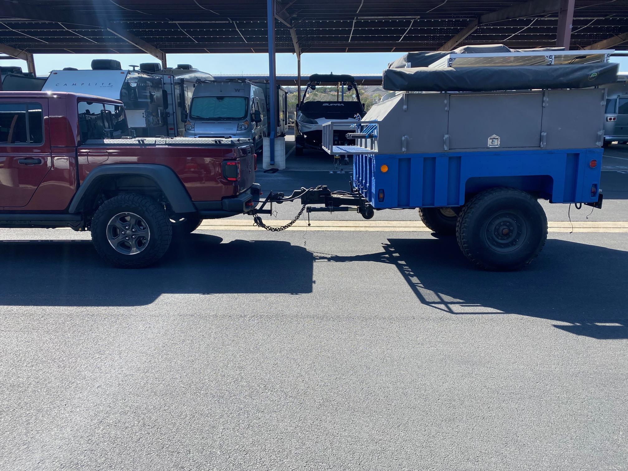

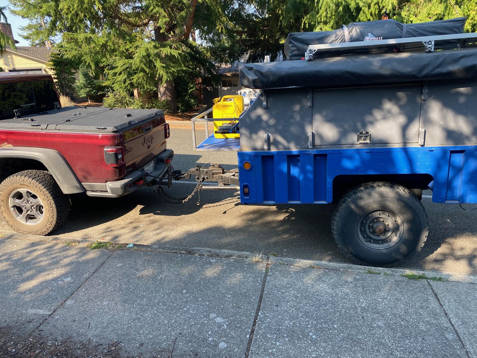

Unloaded the trailer is very bouncy. But loaded it tracks very well. I towed mine from TX to WA and back a couple of times now and it towed fine. No issues in heavy rains and snow. I did drive down Snoqualmie Pass on I90 with snow and slush on the road and had no tracking issues.
My trailer fully loaded weighs under 3000lbs.
Getting the hitch to align helps with the surge working well. My Diesel Rubicon has a Clayton 2.5" lift and stock 33" tires. I need a 12" riser with the hook at 10". I probably should go all the way to the top of the riser to better align. Unloaded the trailer does not cause too much squat. But when loaded the jeep will squat more. When loaded the squat is enough that I was getting flashed by other drivers at night. I will be adding helper bags to the rear springs to compensate.
To better align the hitch I will be removing the surge and going electric. Surge brakes and diesels are not a good match up. When descending down mountain passes I use the diesels engine braking during the descent. When I got to the bottom on long descents I normally have a hot metal smell coming from the trailer. The smell is coming from the surge brakes being engaged the whole time down the pass. On long descents I have to use the vehicle brakes more so the trailer is not always riding its brakes. I love the simplicity of Surge but hate the add complications when towing with a diesel truck.
When I got to WA I removed the Mil tires and rims and put lighter rims and 35" TKO2 tires. Dropped almost 300lbs doing this. I will say the trailer tows much nicer when the new tires and rims. Removing 300lbs of rolling mass can be felt during braking and accelerating.
The pictures below show hitch alignment unloaded and loaded before removed the Mil tires and loaded after I removed the tires.
