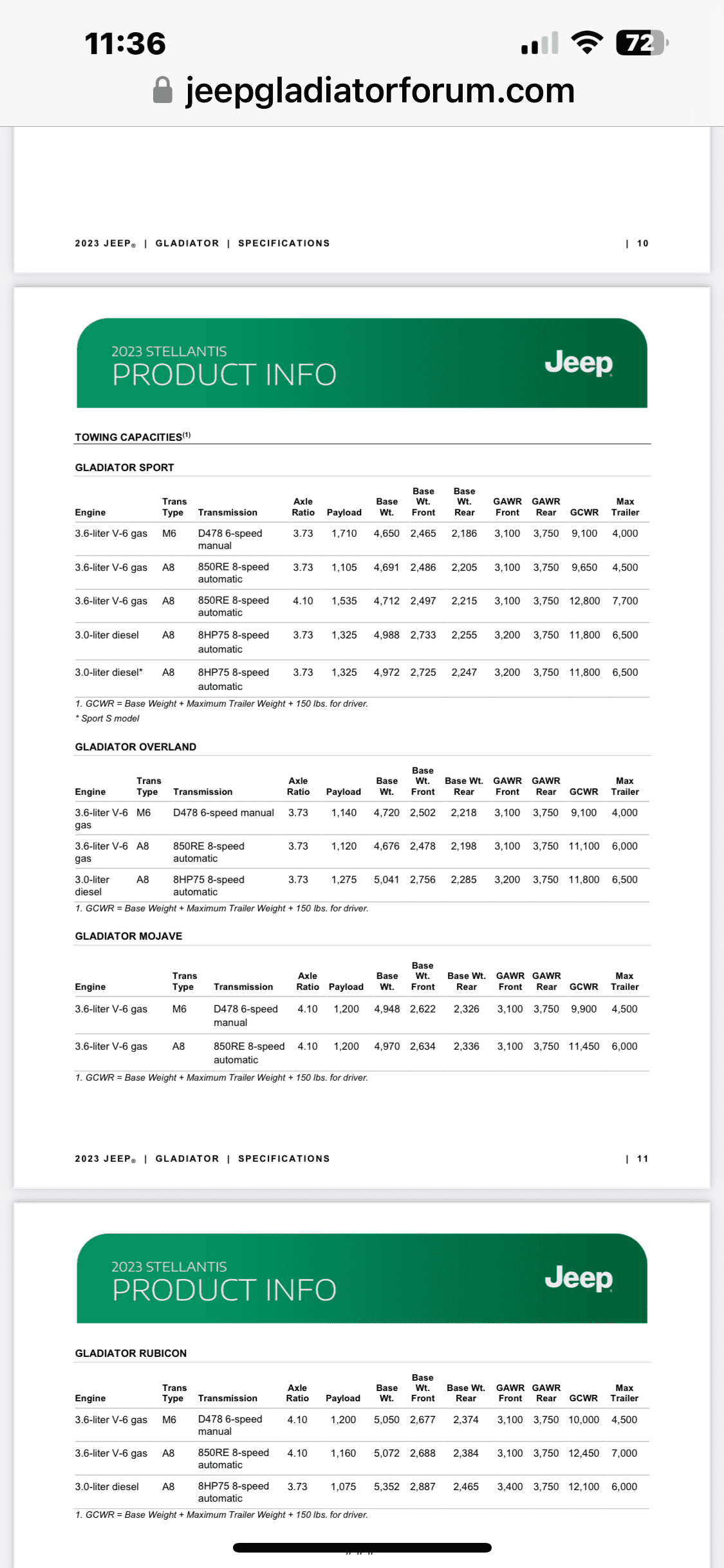

What Jeep says for 2023 although I even question the tow rating of the one sport with auto at low number. High altitude was still a package on overland with many upgrades and the HA wide axles at 3.73 ratio might be more to fit the twenty inch low profile tires and rims so no rubbing on front. There has always been misinformation on ratings and even Mopar seems to have a big question mark on the one Sport model. Although diesels have much more power their tow rating is a little bit lower due to engine weight and cooling has been stated here…..Jack
Is there one of these for the 2021 model year? I have a Willys and the owners manual mentions zero about that trim.
The Willys is just an options package on the Sport. Use the Sport information in your owner's manual.
