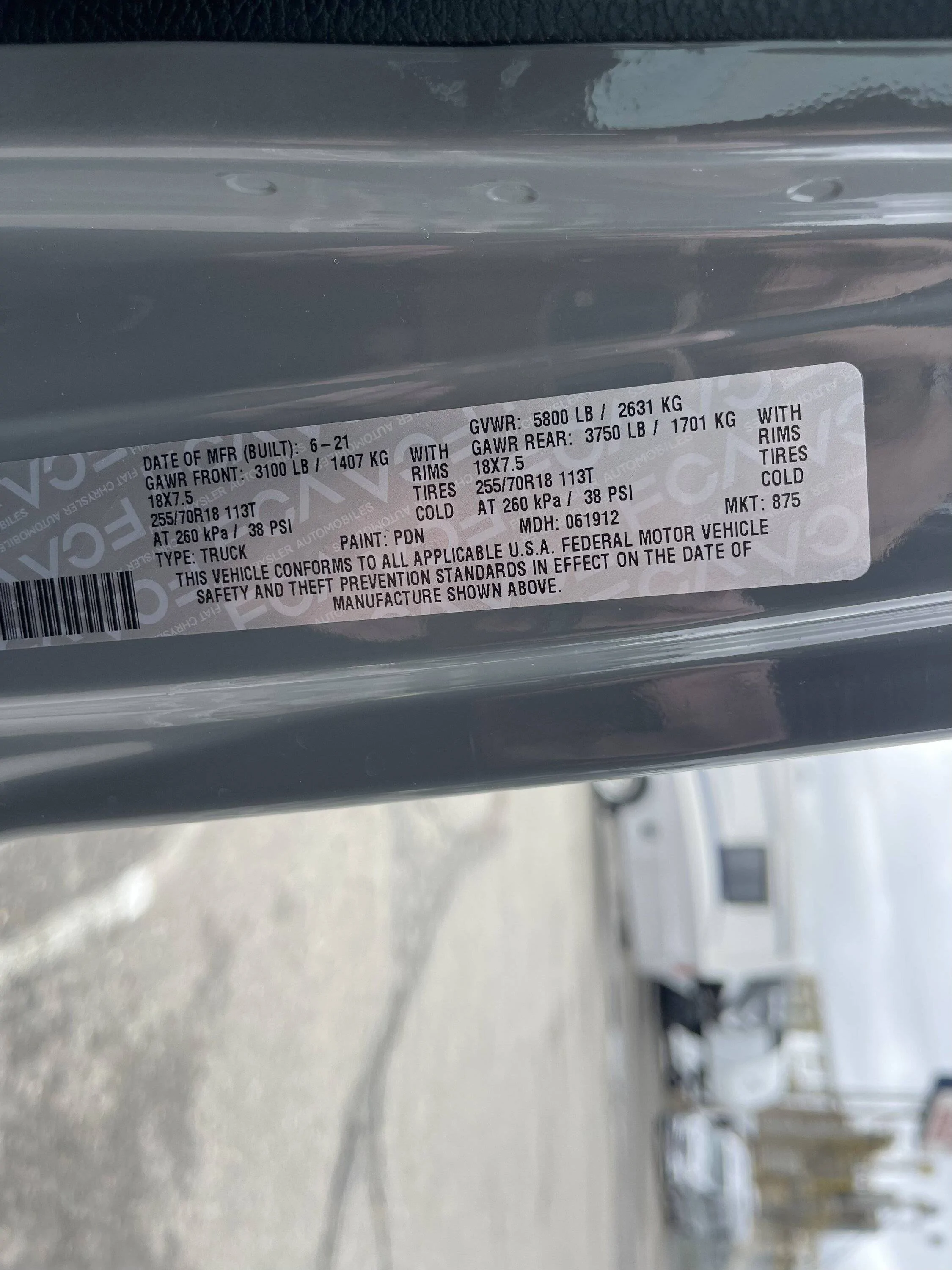

Thank you for the very thorough response. On my door jam I see the GVWR listed at 5800 pounds, if that’s what you are referring to. I don’t see any other weights listed other than GAWR front and rear. For sure getting a WDH and anti-sway bars, as well as a brake controller. Appreciate the tips and links.

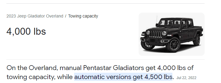

That trailer is too heavy. You should not get a trailer that weighs more than 3,500 lbs. That would allow for all of your cargo and passengers.
The Max Tow package can tow up to 7,500 lbs.

I don't know where you got that from but, the owners manual says that an Overland with the auto and factory tow package has a 6,000 lb tow rating. The picture you posted is untrue...yes, true for the 6sp manual but untrue for the 8sp auto.

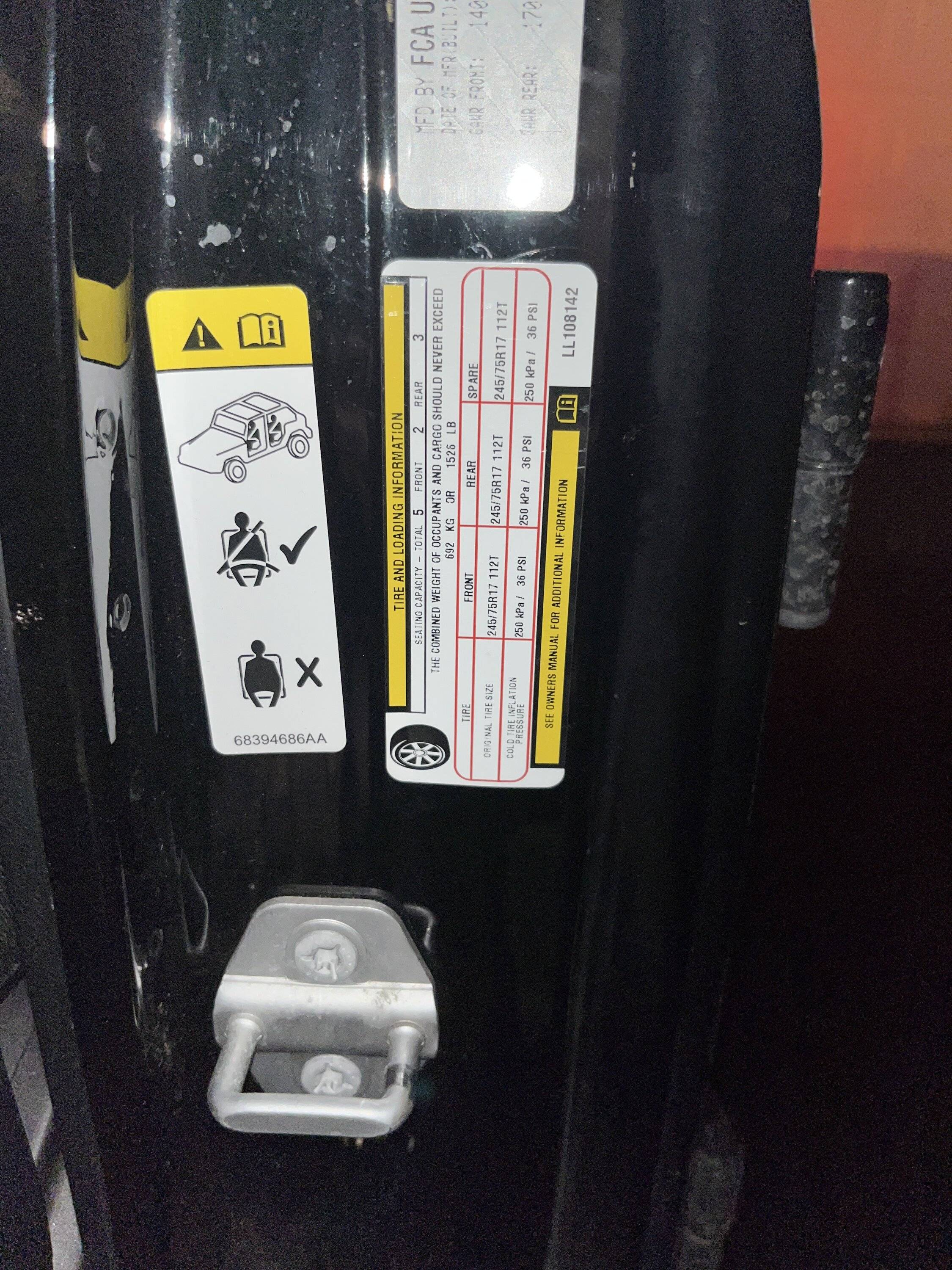

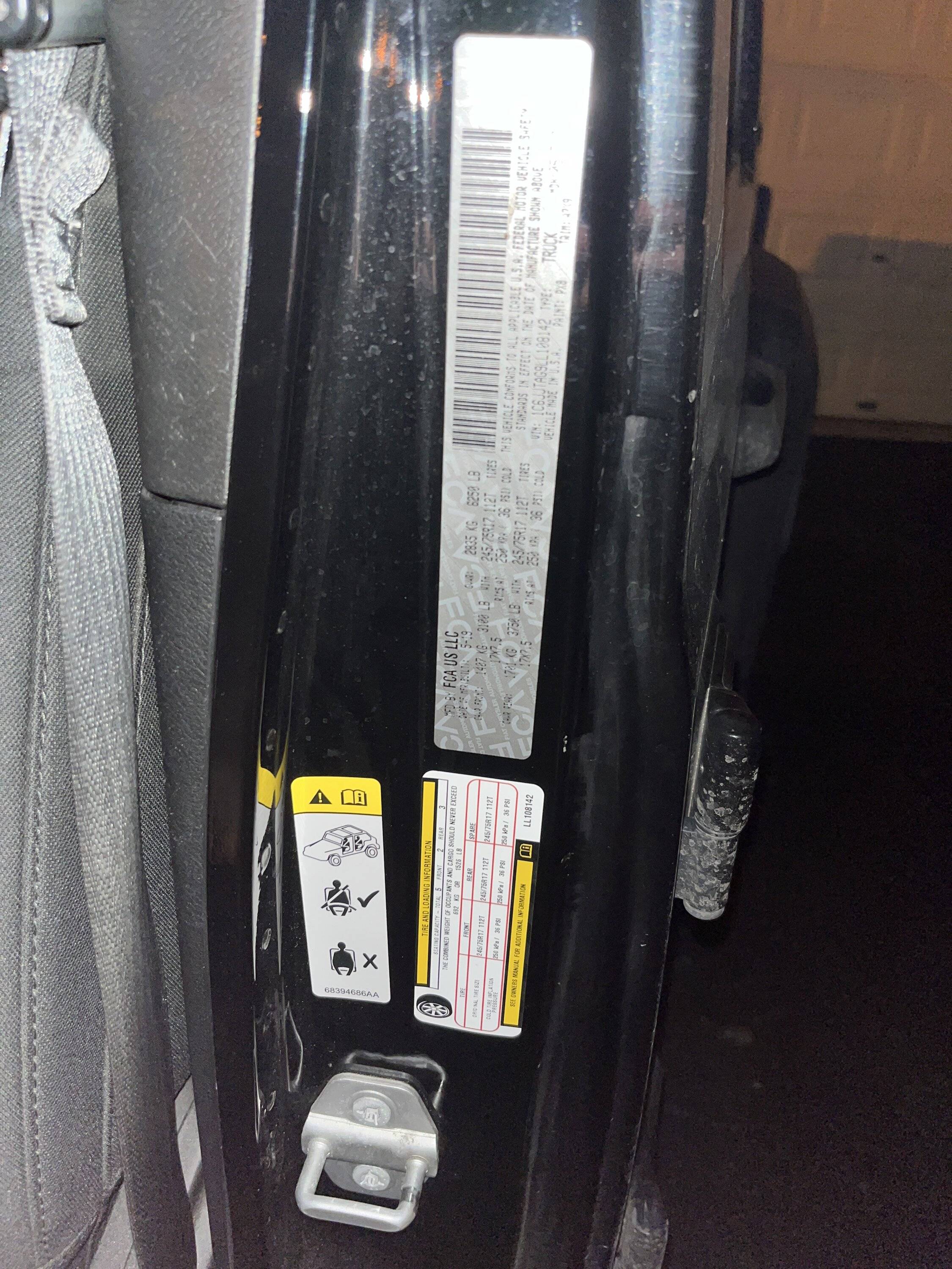

When you open your drivers door the pillar that is in-between the front and rear door is the B pillar. On there is a sticker that has your tire pressures listed on it. At the top of that sticker it says the max payload for YOUR jt. Since most listed numbers are ballpark and change depending on factory options. If your not sure take a pic of the stickers on that pillar and well look here. I know sometimes when Im intently looking for something I manage to glaze over it despite it being in front of me haha

Gross vehicle weight is not how much it can tow!
The manual tells you either 4k or 4.5K. If you get air bags in the back you can tow more, but I worry about the engine doing it without a re-gear or supercharger.
