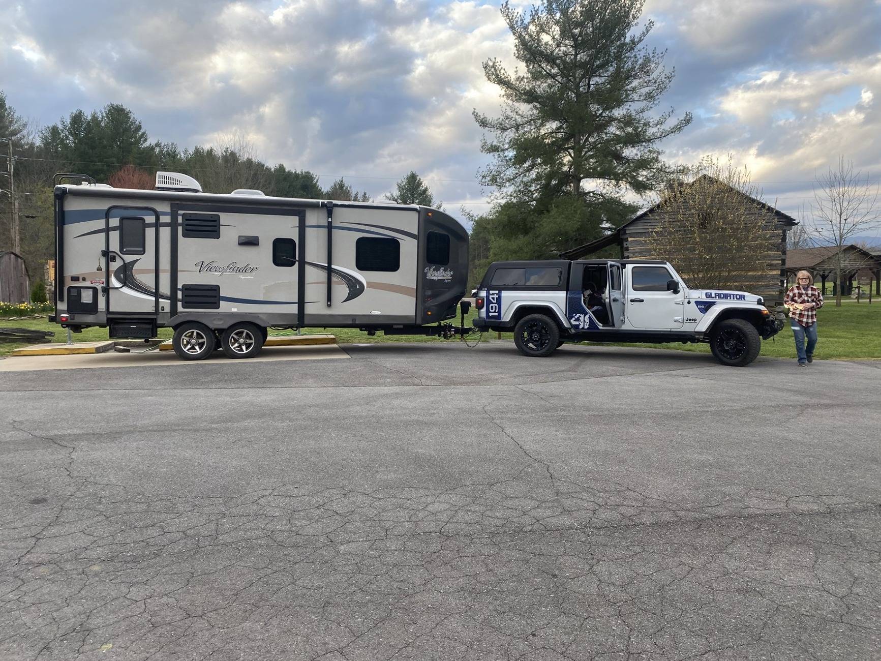

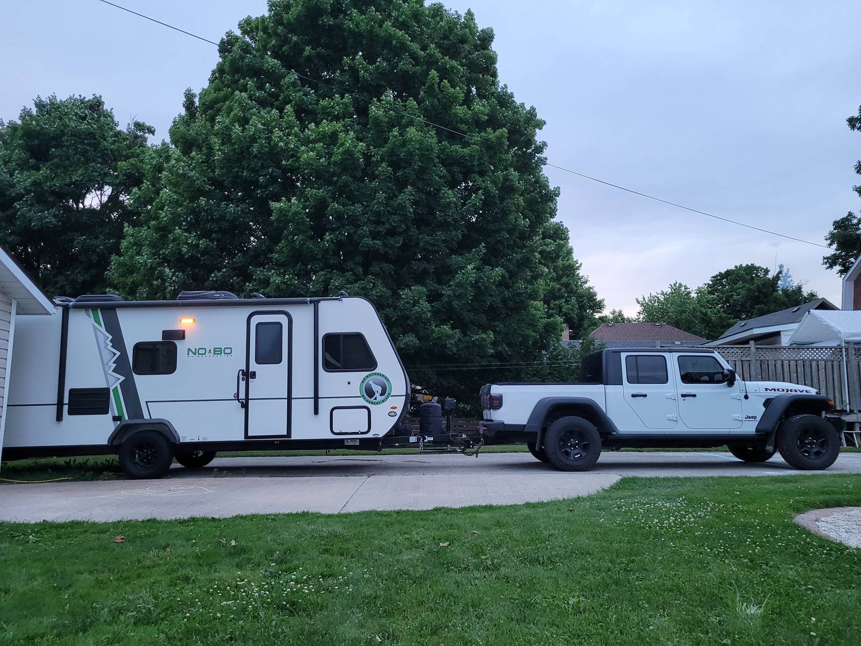

We are pulling this cruiser V-nose camper with 2 slide-outs. The Gladiator pulls it pretty good. You know it when you start up a big hill on the interstate.

Been hesitant about towing double axle RV's with the Mojave. Having sold my F250 I feel like pulling something in the 5K range would be a chore for the 3.6 but you guys are proving that wrong.
Yeah, some hills remind me it's only a V-6... but otherwise, it really does okay :) :) :) The big hills, just stay to the right and keep on keeping on...screw everyone else because it's your drive, not theirs. If they wanna get out and help push, then that's okay but otherwise, screw 'em.
I tow a double axle with my Overland (ordered 5/19, delivered 7/19) and have no issues with it. My trailer is 27' long, has a single slide out, and weighs about 5,100 lbs with all we want or need. I actually prefer to tow with a dual axle. It tows better, handles better and is inherently more stable. Plus, if you get a flat, you've still got another tire there to help you get off to the side safely.
