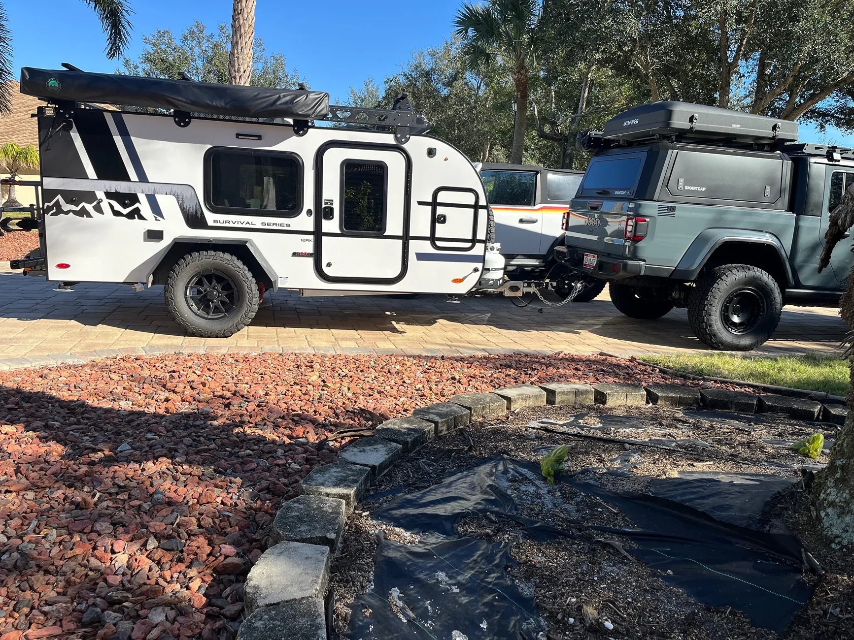

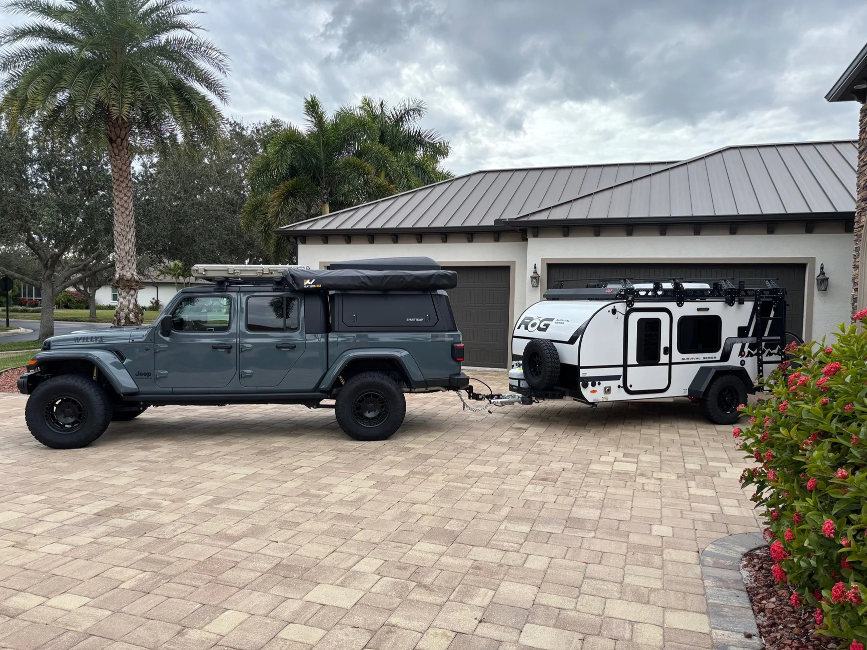

I honestly think you will be just fine. I tow this Encore ROG 12RK-SS which has a similar weight as the trailer you are looking at. I did upgrade my gearing to 4.88 but I also am running an RSI Smartcap, rooftop tent, 270 awning and decked drawer system on 35” tires (soon to be 37” tires).
Tell me about your hitch set up... looks kinda funky to me.

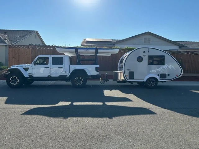

I currently tow a Tab 320 which is about 2300 pounds, which is really close to your trailer. I also live in the Sacramento region so used to the hot weather and steep grades. I tow with a 2024 Rubicon X and am currently on 35 inch Wildpeak ATW4s. I added airlift 1000s bag which I really haven't needed and use a Bluetooth brake controller. Still running stock 4.10s. I don't feel the need for a weight distribution hitch. I used to tow a similar load with a 2014 JKU and had cooling issues. The Gladiator with the 8 speed transmission does great, especially when compared to the JKU. You are correct that the Willy's comes with heavy duty cooling, it does not have the Aux switches. The axles are a little narrower than the Rubicon's. The only difference I see, is that if you go up in tire size, even to 35s and tow you probably want to regear to 4.56. The engine is high revving, so when going over the steepest grades expect some engine noise. Otherwise towing should be a relaxed experience! Good luck in your search.

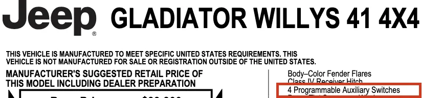

The window sticker that I linked has the aux switches included in the Willy's 41 package.
You are right, I looked at the compare portion on the Jeep Website. On one section it says Aux switches standard, on another it says Trailer Tow and Aux unavailable.
It’s a lock-n-roll hitch. Provided full articulation for going off road.
How is it on the highway? and does it come with sway control/equalizer bars. My off road trailer is high profile and is susceptible to cross winds.
