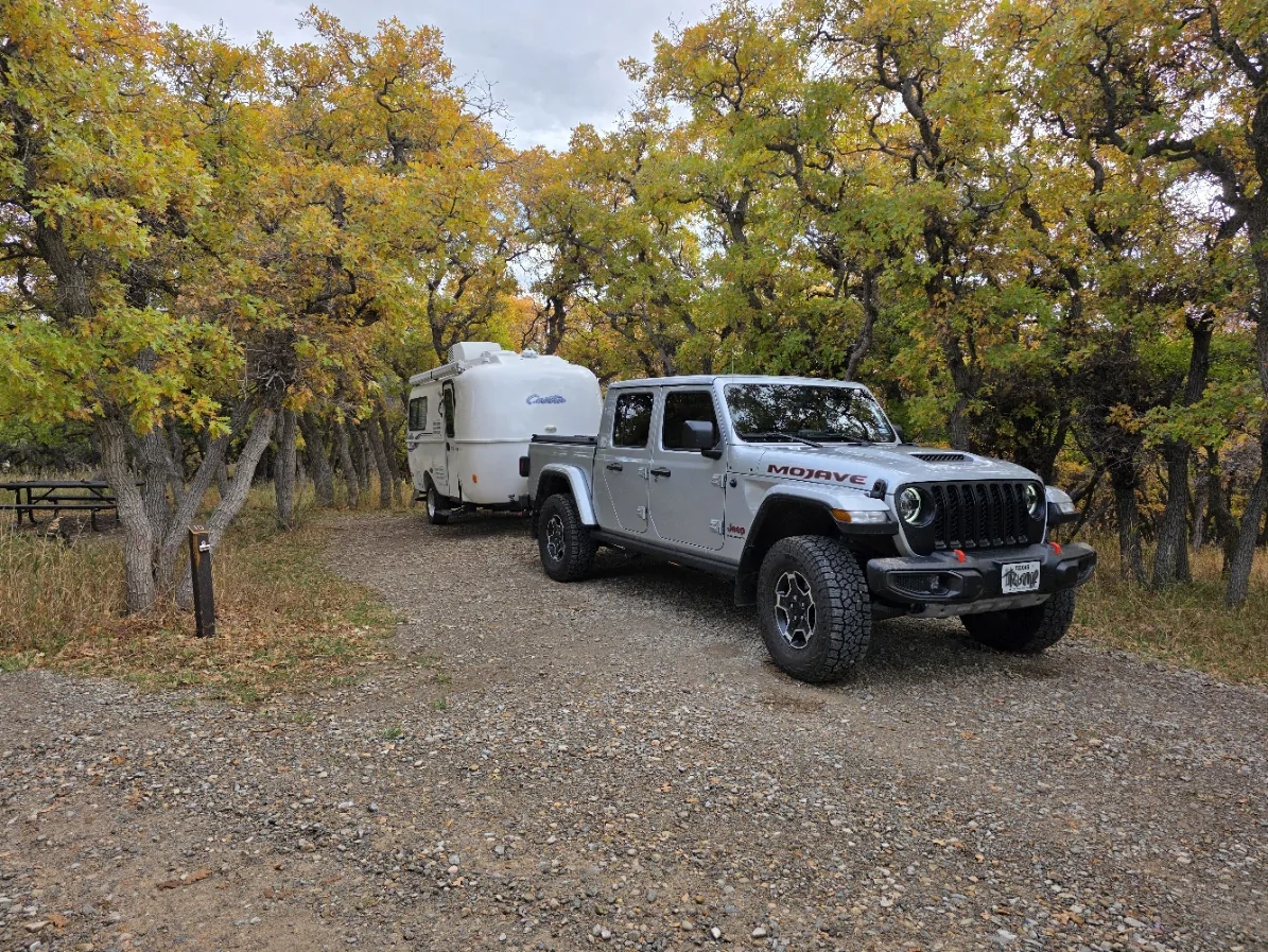

I have a 23 Mojave has 8430 miles on it. 6000 of those miles are towing this Casita, Been from Texas to New Mexico, Utah, Colorado. The Casita is a good trailer for the Gladiator WITH the OEM tow package.
When towing especially hot weather engine temperature, and trans temps are definitely my primary concerns. So far The Mojave has handled everything very well,much better than my 2018 Tacoma TRD did.
The shape of our trailers has a lot to do with MPG, stability the casita is pretty aerodynamic compared to most other's .
I also run a Weight distribution hitch,an Andersen model, it seems like over kill but it greatly helps.
I also run the Airlift 1000's cheap, but really help with sag.
safe travels.

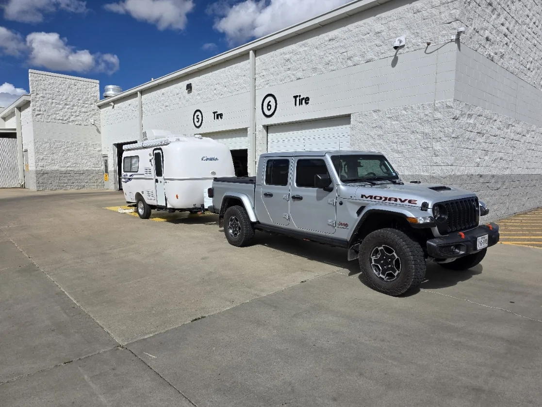

Jeep Gladiator Travel trailer towing with a 2026 Willys Gladiator Cortez
Cortez, Co had tire tread separation on the Casita on a sunday no tire places were open except Walmart great employees took good care of me.
