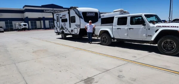

What I have . Works great and very simple install. Plus you can take it to other vehicles.
I got one of those as well. Works great.
On the towing capability; I just know from towing a Coleman Rubicon 16 footer (with the slide out) that the motor is being loaded quite a bit. The trailer tag says that max loading gets the weight up to 5100 lbs. I have noticed that towing on flat and level roads that the motor is struggling to pull the load (and my rating is 7K on my OEM configured JTR). Way back in school we were told to design to 63% of working limits and stay below that number. With that in mind, I try to tow with no water, grey water or black water in the tanks. That helps a lot, but the wife keeps coming to the trailer with more stuff (because there is so much room). I just live with it. I do try to minimize the tow distances so I am not (over time) burning up the motor or tranny (can I say that here). I just keep an eye on the gages. So, a good rule of thumb is that you may want to stay below that 63%. For me, that is 4,410 lbs. Dry weight is around that number (actually about 4850) but the motor still feels like it is being taxed too much. I want to own the JTR till I am too old to drive, and with the loads I present to the vehicle, that number is shortened.
P.S. I did convince the wife it is a good idea to get rid of her Wrangler and trade if for a 24 Tundra (so I can keep my Jeep and put 35's on it). This saves my JTR for it's true purpose; leaving Bronco's on the paved roads where they belong.

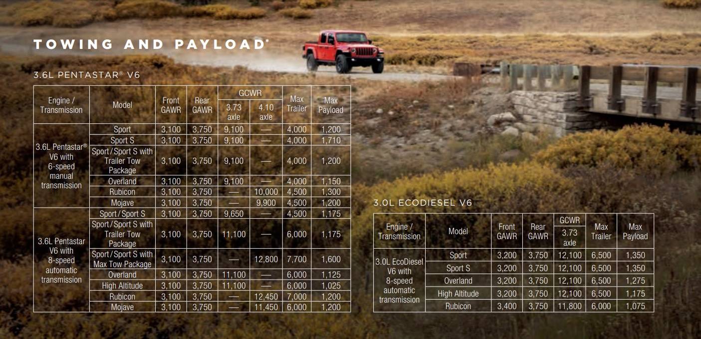

The factory trailer tow package (not the Max Tow package) does not include wide track axles, yet the addition of the factory trailer tow package to a Sport or Sport S with automatic transmission bumps the tow rating from 4500lbs to 6000lbs. Having or not having wide track axles therefore is not the de facto determining feature as to whether your towing weight limit is the lower or higher of the two.
Jeep Gladiator Travel Trailer advice 23 JT brochure towing payload

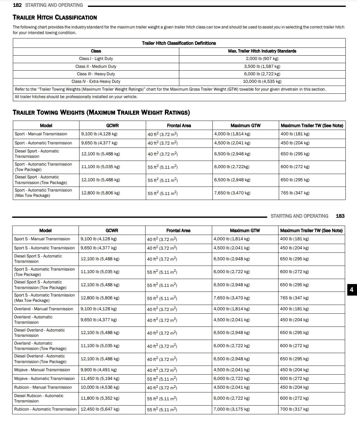

Straight from the owner's manual:
Jeep Gladiator Travel Trailer advice 21 JT owner man to
Note that the factor that determines whether a 3.6 equipped automatic transmission Sport/Sport S/Overland has a 4500lb or 6000lb tow rating is the absence or presence of the factory trailer tow package.
Also of interest is the maximum frontal area of the trailer for the various trims and equipment, something that is not often mentioned or discussed.

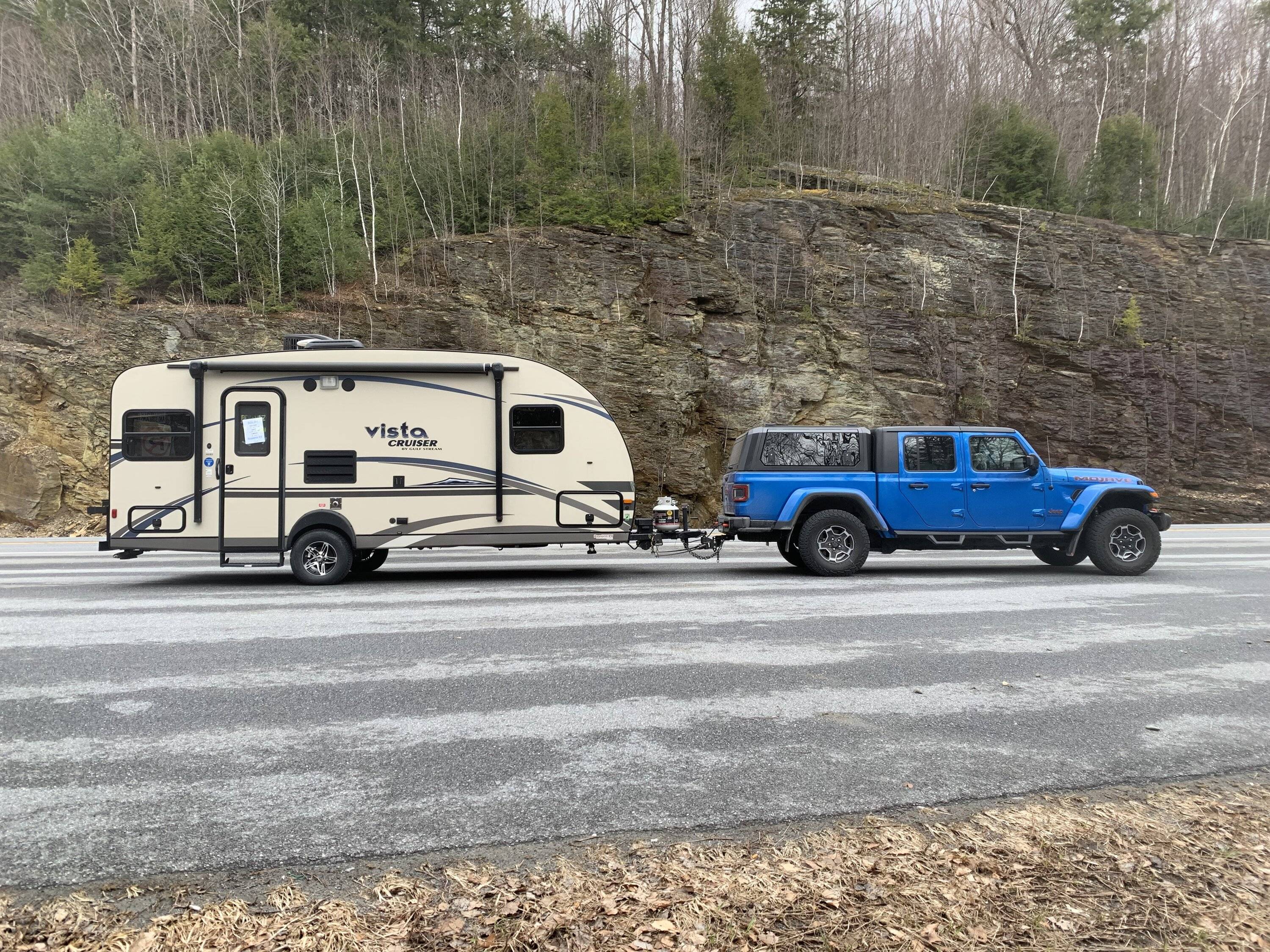

Frontal area is important, I see the effect of my camper 7.5’ W X 7’H, which is in spec on the Mojave compared to my landscape trailer or even the twenty foot whaler. There are many options on how to calculate frontal area, but I went with measuring from bottom of frame to top of trailer and add a little for A/C unit and tires, and not add the Mojave frontage as it is in front of it. I also have a aero camper front and even rear, and assume that that sloped front helps a lot .
I am of the school of thought that if you have all the other specs in line , frontal area is important but can be compensated for with lower speed perhaps. Camping is supposed to be fun, do a bit of homework up front before buying a camper , don’t push the limits sure it can do it but is it fun, get a smaller camper or bigger truck….Jack
Jeep Gladiator Travel Trailer advice IMG_0983

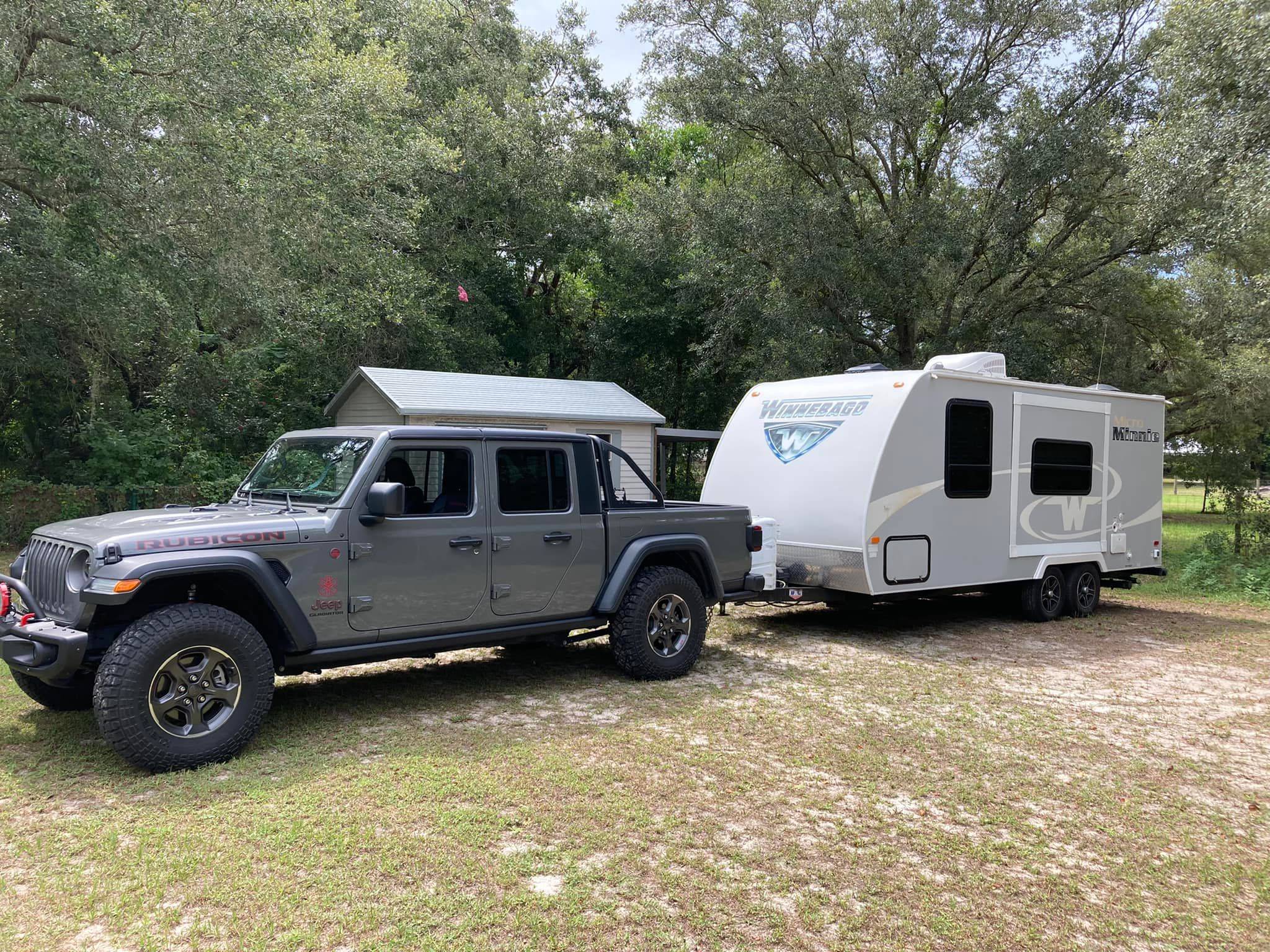

Frontal area is important. Also we who tow with a Gladiator need to consider a few others things besides tow rating.
1. Width of the trailer. If you can stay at or under 7ft, you will have a better experience.
2. Dual axle on a trailer. The JT is a light duty truck and wind can/will push your truck and trailer all over the road. WDH and sway control helps, but a dual axle on your trailer helps even more.
Winnebago Micro Mini 2106DS. I tried to keep the weight around 4K lbs. The Gladiator still struggled with it. Not trying to sugar coat it, the JT is not a great tow vehicle. But neither is all the SUV's you see on the road towing.
Jeep Gladiator Travel Trailer advice 1703952580847

Interesting. Your information "proof" says flat out 6,000 as "max tow" with a "tow package" but not the 4.10 gearing. AND a 600 lb tongue weight. I'm going with your "proof" that contradicts mine... So, the other guy is also right, but as noted, Until you presented this, Jeep is clear as mud and has conflicting information themselves out there. YAY, I can get that micro minnie winne with the dual axles. And now I have my own Freedom built off the Sport S, so I can go look at the manual... This is great news.
6,000 is for the 3.73 ratio and Sport, Overland and so on with tow package.
Rubicon is higher due to the ratio and axle width.
Max tow is higher because of many factors, including SMALLer tires, 4.10 ratio, wide axles and more.
If it has a tow package, gas engine, automatic and 3.73 ratio, look for a 6000 limit.
You have to pick your specific model as equipped and use that number, then figure mods will reduce it from there.
Toss bigger, heavier tires on a max tow, you drop that rating.

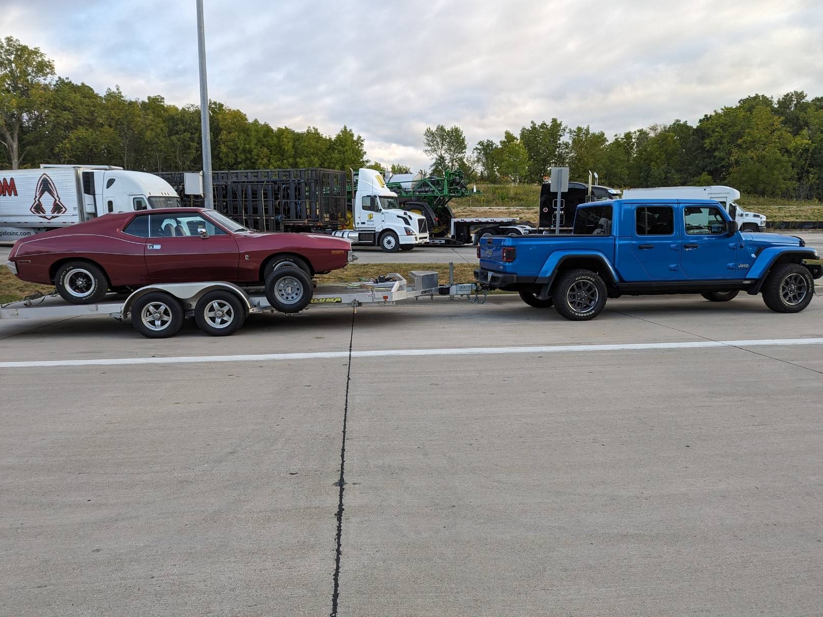

Think about the drag here in this picture - I have the frontage of the truck, the drag on the straight long sides, then the wind "reassembles" behind the truck only to smack into the car behind standing tall o a trailer. I can't figure a frontage per se, but I must keep in mind the car I am hauling on that trailer is dragging me back not because of weight alone, but it's presenting wind resistance by itself. The air coming off the roof of my truck is going back and running into the windshield of that car (I have to clean bugs off when I get to my destination)
That rig by weight is 1600 for trailer with spare tire and tool box, then 3200-3300 for the car. So I'm towing 4800-4900. I call it close to 5,000 to be safe. Tow rating is 6,000 and it does fine. I run 500 pound tongue weight.
Jeep Gladiator Travel Trailer advice 20210910_063711_HDR
Even this will present some wind resistance........
Jeep Gladiator Travel Trailer advice PXL_20230908_123326710
