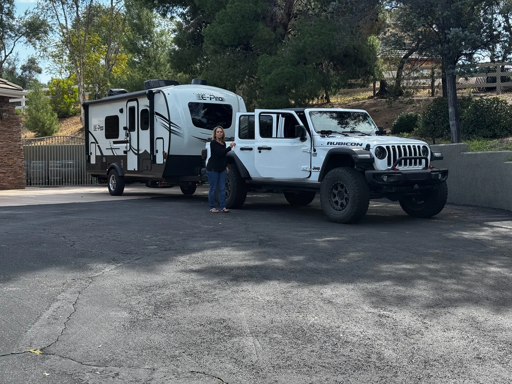

'25 ePro 19FDS towed by '23 EcoDiesel w/37s, RedArc brake controller, Anderson sway bar - all good, no issues up and down mountain roads (9k ft and at sea level).

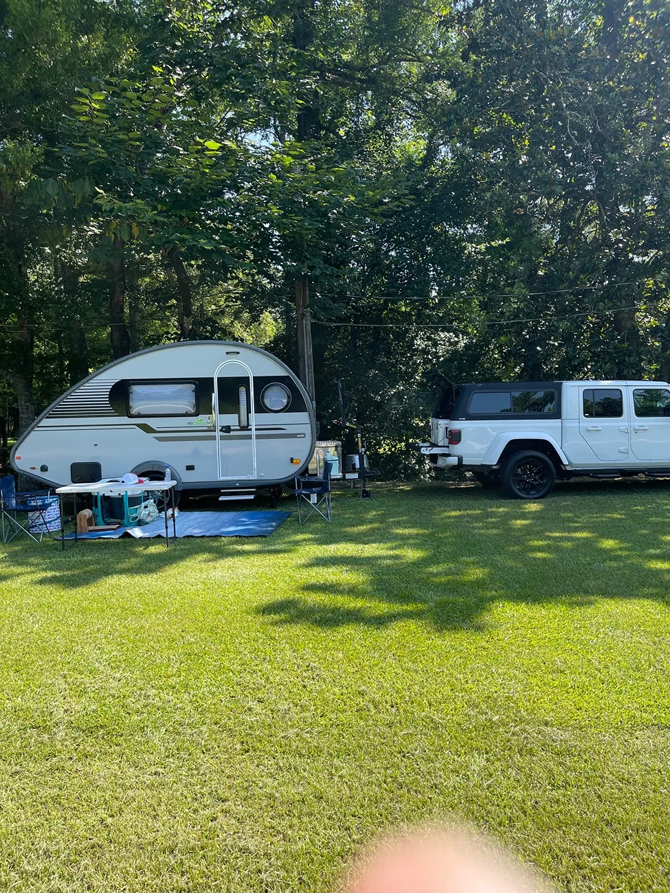

That’s what I got it for.
