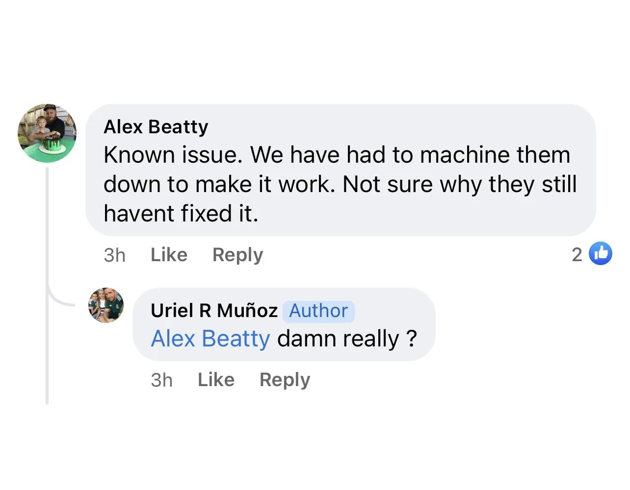

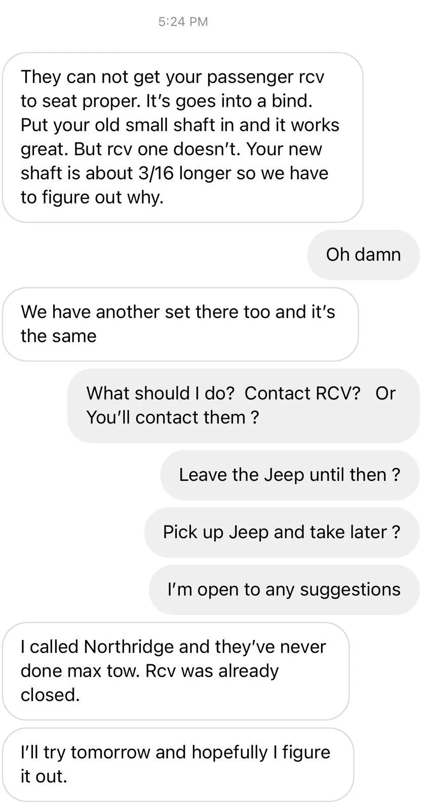

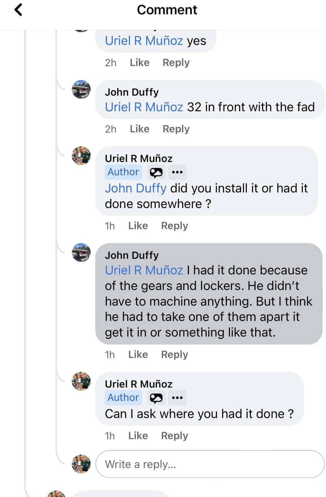

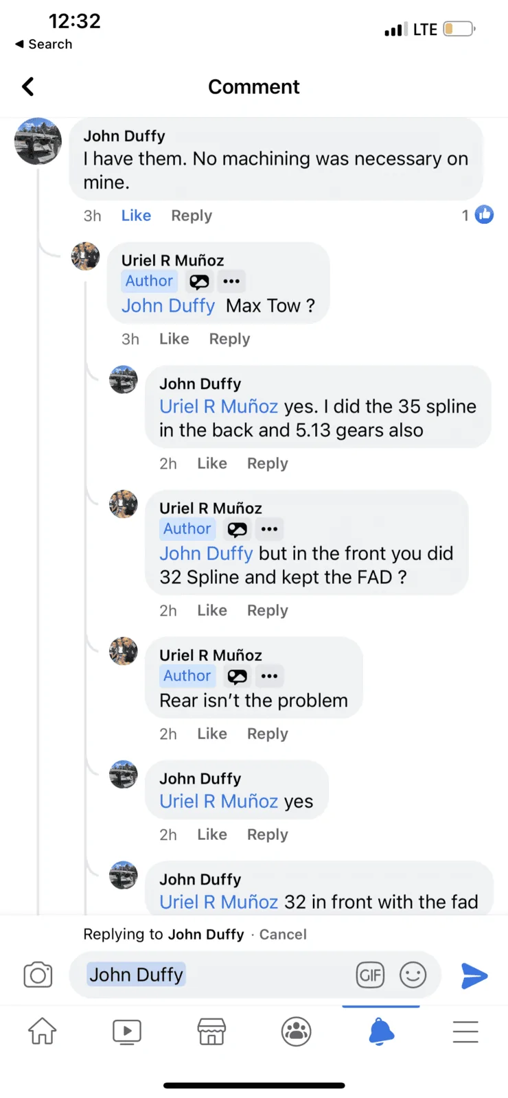

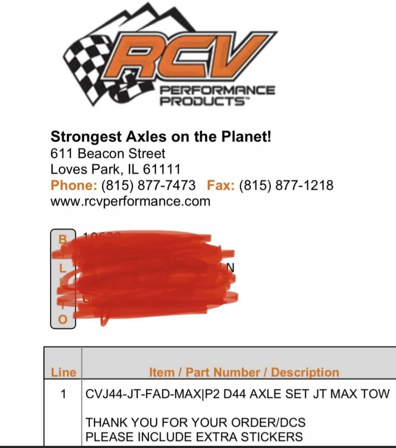

Hey guys, my installer is having some issues getting the RCV Shafts to seat properly?
Anyone have any insight on this ?
Rear shaft, rear air locker, compressor, HD Ball Joins and more installed perfectly fine, but having issues with the front shaft
