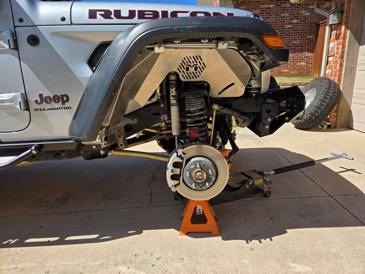

1" both front and rear.
I do have the Artec inner liners front and rear. Not really a big fan of them but they work. I did the fender chop but am going to remove them shortly and go the with the Motobilt highline fenders and probably high clearance inners from Motobilt as well.

Are you running the Motobilt front fender support? I like their fender supports, but the old man in me says that little LED may be an issue in bright daylight.
What's the offset or backspacing in your rims?

Thank you sir!
I am currently running the Quake lights for the fender chop. Those will come off when I do the Motobilt fenders and the button LED will take its place. I will probably also go with Diode Dynamics headlights that have the turn signal built in for some reassurance.
Raceline Beadlock wheels, -38mm offset with 3.5" backspacing
