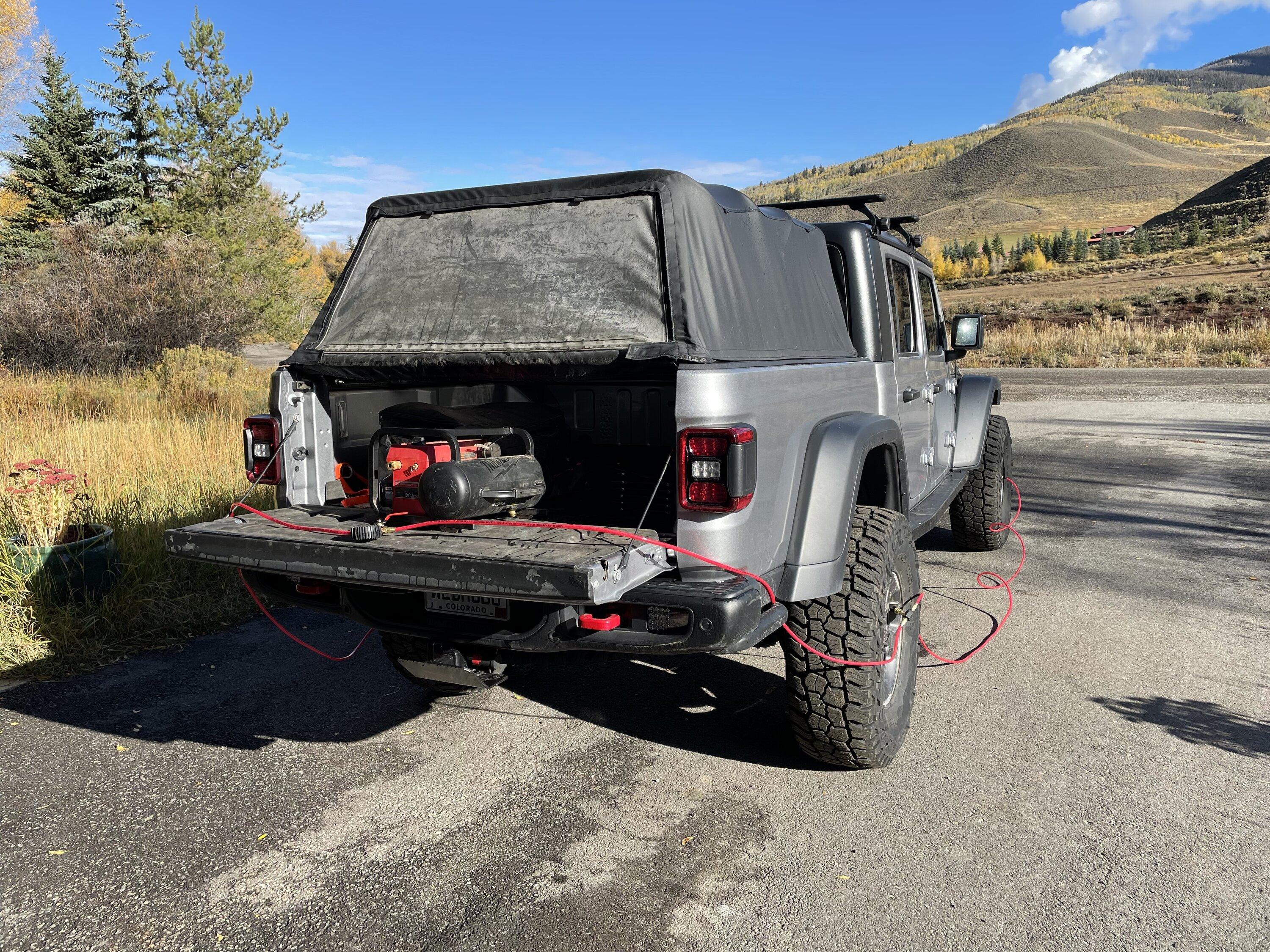

After testing my Milwaukee m18 2 gallon with Speedflate, I couldn’t be happier. I easily shaved 5 minutes off of my air up time. I aired all four 37’s from 15psi to 36psi in 15 minutes. No complaints.
