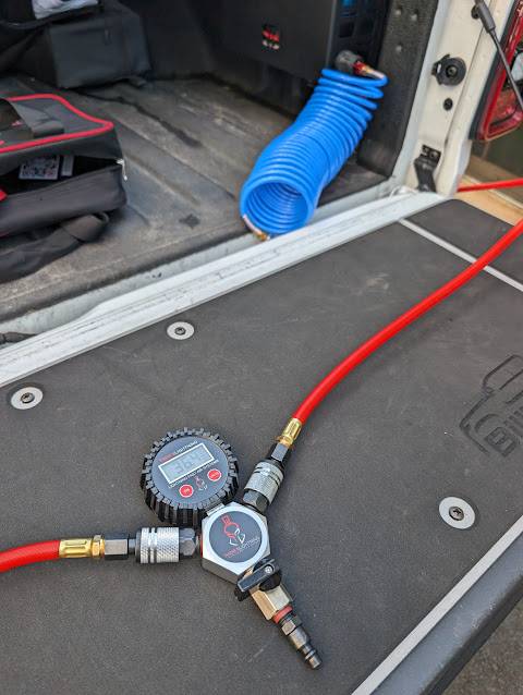

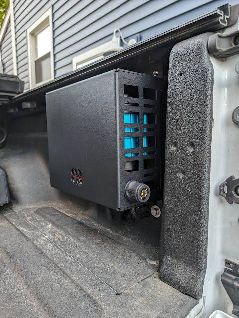

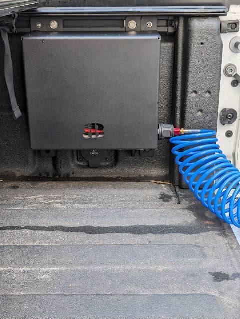

I did the ARB twin with the 813 bed mount, and using the Thors Lightning 4 tire hose kit.
Looks great! I hope you are happy with the enclosure and the install. Please let me know if I can help with anything else! - Jeremy

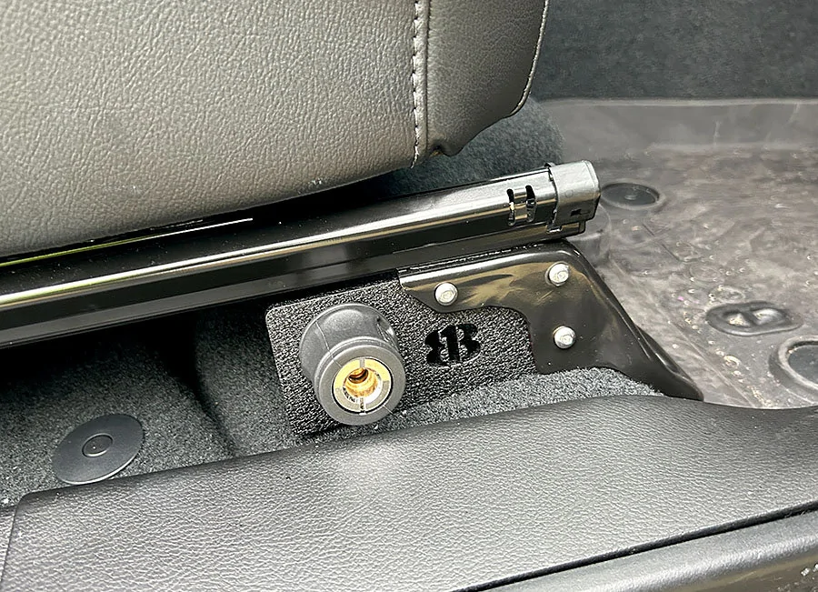

I don't have photos to share yet but will do so as soon as I have the final production setup ready. I have to do one last test but everything should work under either seat. I can also set you up with mounts for both seats to have an air coupler on each each.
So the compressor is under one seat but you can have air coupler on each side?
Correct! You can add a splitter to the compressor and run a second air line under the center console to the other seat rail where you can mount a second seat rail plate.
That is a cool idea.... any spilter suggestion to use? Any compressor issues with having it split out?
I use brass tee fittings. There is no issue splitting the air from the compressor. I can help put together all of the parts you need if you would me to help do so.
Yes if you dont mind that would be helpful. Im on your site now and wanted to order all the right parts, no Black Fri sales so you dont have to hurry. I am interested in under the seat mount with air chuck on driver and passenger side. I think the rail air coupler/rocker switch plate works.
