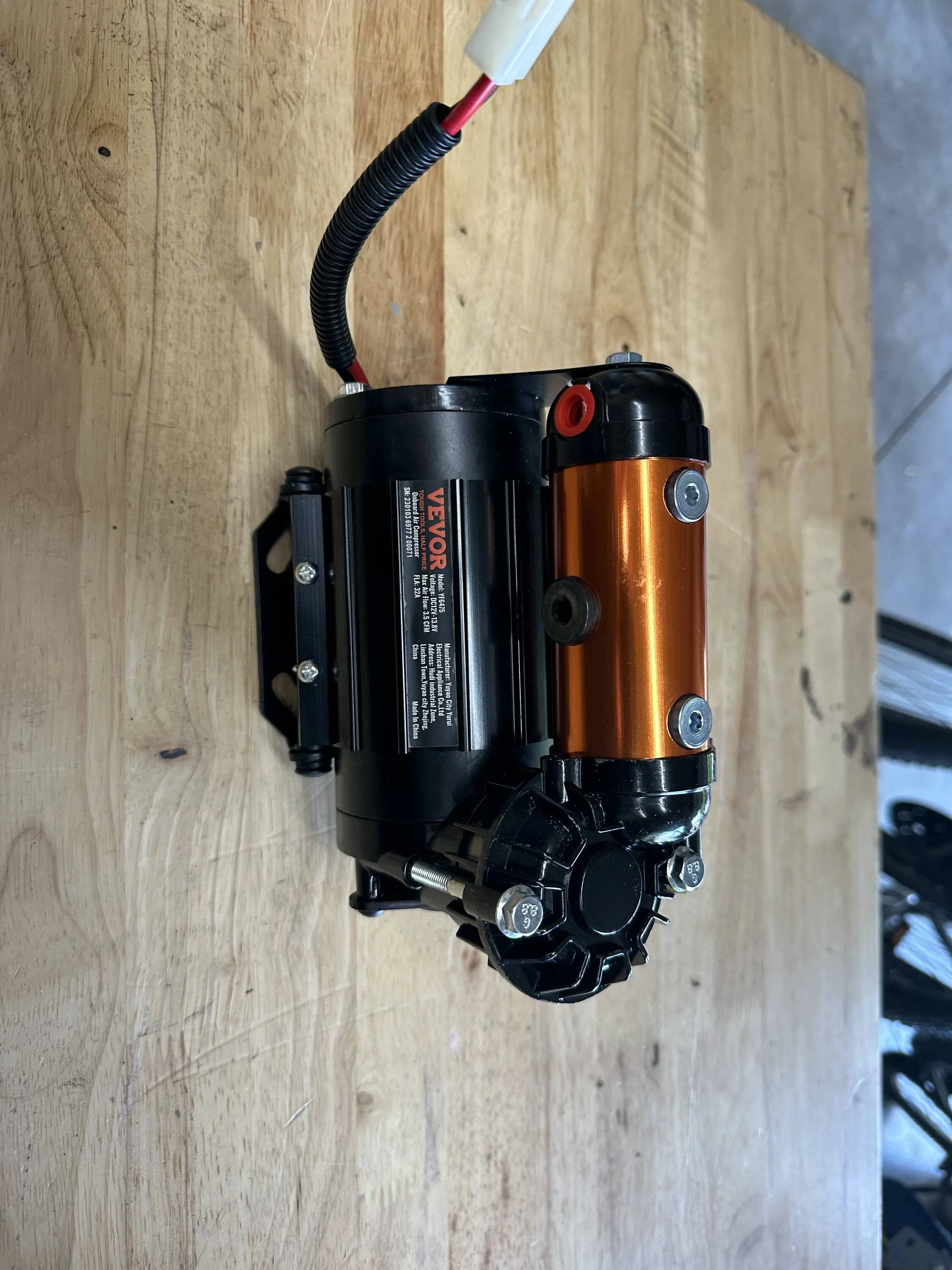

So I recently found this Vevor On-board Air compressor on Amazon for right around $100. I saw a post or two mentioning it other places, but between the questionable reviews on the manufacturer’s website, and the terrible, but ultimately useless reviews on Amazon, I thought I would go into a bit more detail.
First thing, from the outside it is a direct copy of the ARB Single compressor. It is just that though, a copy, not a clone. The layout is the same, but there are noticeable cost cutting measures that took place, from a splotchy paint job, to cheapo hardware in certain places. So, same same, but different.

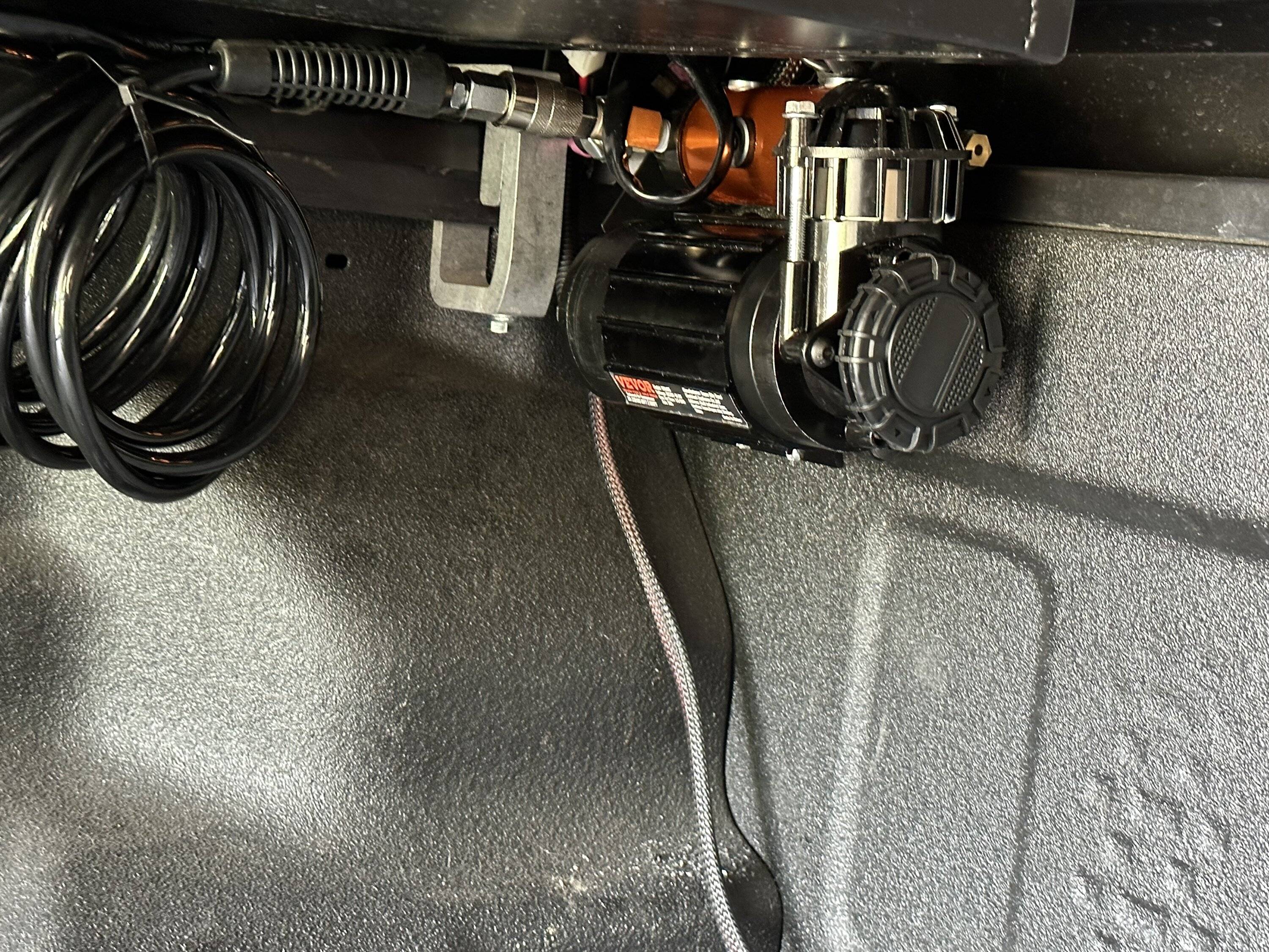

Next what’s included in the box. The BOM lists things like a pressure switch, rocker switch, wiring harness, relay, etc. so this would lead you to believe that it has what you need to wire all those things together right? Wrong. The wiring harness is the solenoid harness for installing lockers, and a straight power lead, nothing for wiring in the relay, pressure switch, or rocker switch. Expect to buy some wire for making up this deficiency, a few feet of wire and some crimp on terminals and I had the relay, rocker and pressure switch all connected up.
It also comes with a cheap air hose, some quick connects, a few air up accessories, and a roll of Teflon tape. Everything you need to run the air right off the manifold with the pressure switch installed is there. Out of the box, you have what you need to fill a tire.
The pressure switch is where I ran into my only real problem. The 40a in-line fuse tends to pop before the included 100/150 pressure switch cuts power to the compressor, it managed to cut the power exactly twice before the fuse popped first, i then repeated this twice more to similar results. I am choosing to just drop down to a 70/100 pressure switch since the compressor is only supposed to draw 35A. I have a hard time believing this thing wouldn’t burn up trying to get to 150psi consistently.
In use it got wicked hot, but did manage to inflate all 4 of my 35x12.50r17’s simultaneously from 15 to 38 PSI in 12 minutes flat. So I am happy with the results there.
Overall the longevity is going to be what decides if this is a winner or not. I wound up spending just as much on installation components, between a pack of fuses, a braided line to deal with the heat, a replacement pressure switch, wire, relay holder etc. that for $200 I could have gotten a much faster and nicer portable. But I now have onboard air for about $200, so I’m calling it a win.
If you can look past the lack of instructions, complete lack of plug and play functionality, don’t actually need it to get to 150psi and want something cheap and dirty. This may be what your looking for. As long as I get a year or two out of it I know I’ll be satisfied with it.
