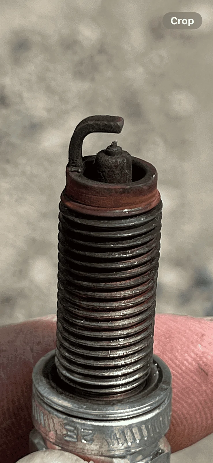

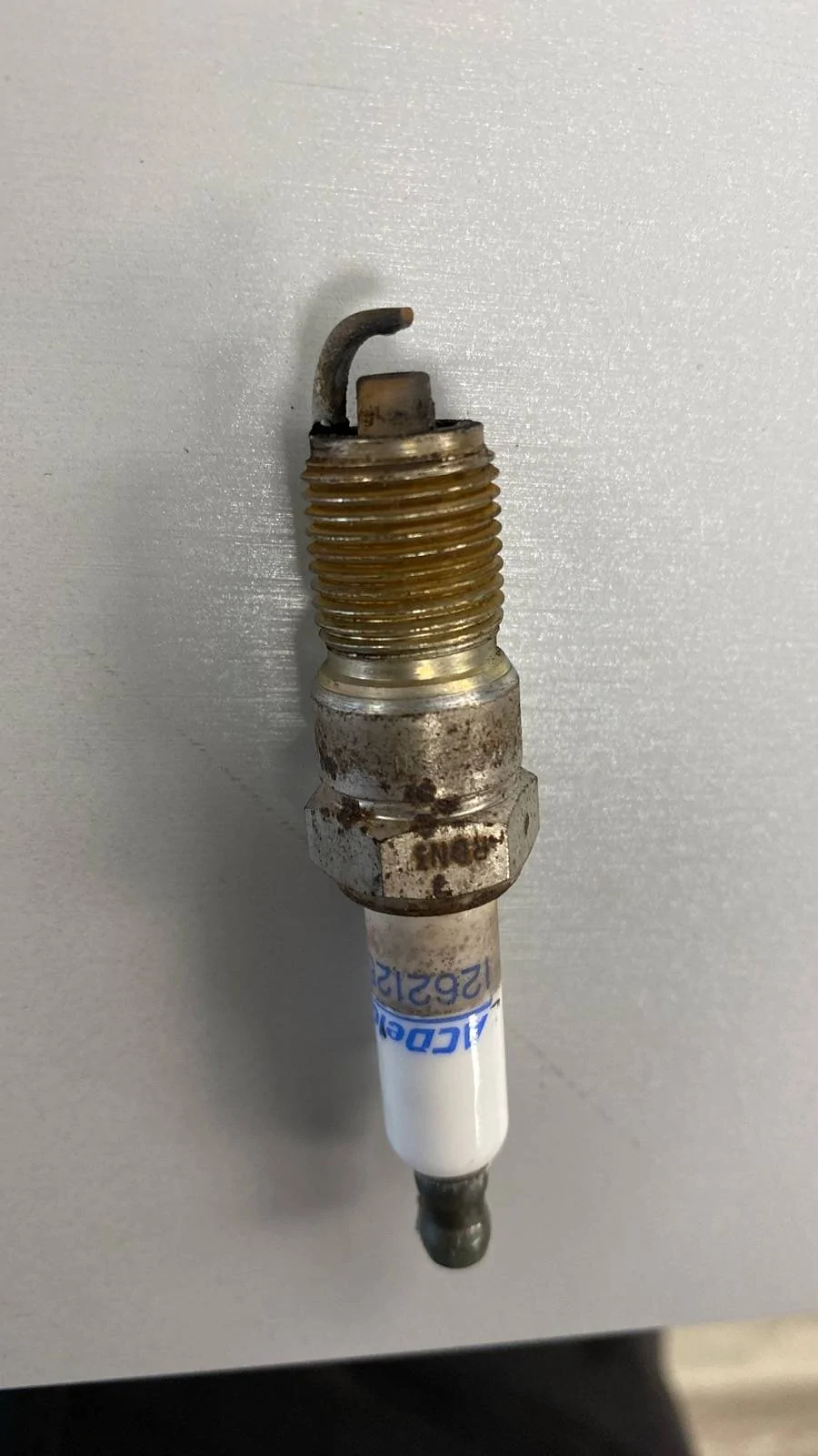

UPDATE:
I took into the dealership the spark plug (50k km) from the P0305, 5th cylinder misfire that we all agreed was toast from the photo I posted, and sat down with the service manager and had him look it over and provide his opinion.
He carefully looked it over and said I want to bring in the Shop Forman to give his opinion, he sees spark plugs every day, so he called him in, gave it to him and asked what is the condition of this plug at 50k kms? The Forman looked it over and said “the burn is even, looks very normal to what they see here, tip is good, there’s no burn deposits on the ceramic, no white deposits on the tip ….its not ready to be changed, lots of life left.” I asked him about the oil smell on the plug and said since I changed it, I can not reproduce the misfire.
He said the pentastar engine is notorious for blowby which sends oil up into the intake via to PCV valve and they often see a cup of oil sitting in the intake manifold regularly which needs cleaning out all the time (catch can grabs this first). So the oil is from blowby.
I told him I don’t have blowby so the oil smell is from having found 12L installed when the second engine was installed and the top end was saturated.
Long story short the intake valves get cleaned with the gas so is not a concern with oil that makes it down into the top of the cylinder, this is why oil burned residue is expected on plugs. My guess is, we all have plugs that look like mine.
I don’t have blowby so oil burned plugs, I shouldn’t have. I ran a can of Sea Foam intake manifold cleaner last summer and I’ll be doing it again soon.
The Forman also mentioned he’s seen plugs that were changed that were missing the iridium tip, like the photo sent to me by @sep. This plug came out of a GM van with nearly 300k kms on it. Plugs were never changed, all the plugs were missing the tips but the vehicle still ran.!!😳
Take it for what it’s worth, I’m glad my misfire is gone (knock on wood) I changed #5 plug and when I’m done with my trip to BC this weekend, I’ll change run another can of sea foam in the intake and change them all out.
Photos again is my #5 plug and the photo of the 300k km plug (x8) the GM van still ran with.

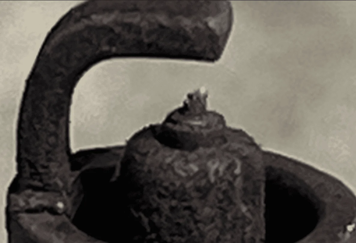

My jaw dropped in disbelief at that post telling of that that guy told you.
Look again at the center electrode - that's anything but normal.
QUESTION - Did the NEW plug you put in have an electrode that looked just like this one?

That plug is not normal. Doesn't matter "what he's seen" - he sees the PROBLEM engines, not normal engines.
Your plug is not normal - it's physically damaged.
There's a reason, and that reason is possibly detonation.
And gee, what causes detonation? Oil in the mixture.
It's damaged, and I'd sure want to keep a very close eye on it and turn up the hearing aids.
The bad bit is that if you have one cylinder that's consuming oil, perhaps ring issues or whatever, that combined with the fact that detonation isn't always audible, you can't always hear it, I'd keep an eye on that one.
In short, I don't buy his "go away, it's fine, they all consume oil and burn electrodes like that" explanation.
No, new plug was not like this one and I have one guess as to what happened. The shop Forman told me that the gap on these plugs come pre gapped. I told him the gap in the old plug is wider than the new plug. He said “really”?! He said you don’t even want to put a feeler gauge or regap these plugs or you’ll reck the plug. I thing this plug, or all of them were regapped or a feeler gauge was used and bent the tip or damaged the tip. Just speculation here
Yes, these special plugs come pre-gapped. Anyone working in a modern shop should know this.
But then, anyone old-timer who didn't know that and attempted to regap would never mess up the center electrode because gapping involves bending the OUTER, or ground electrode, never the center electrode. Any good plug gapping tool has a part with a notch that you slip over that ground electrode to bend it. You never apply pressure to the center electrode EVER, even in the 1960s and 1970s, you never put pressure on the center electrode. It only ever involved bending the outer electrode, making sure it was perfectly parallel to the center electrode top, not at any angle.
There's no harm in checking with a feeler gauge. A feeler gauge wouldn't be strong enough to damage an electrode. You can absolutely use a feeler gauge (does he even know what a REAL feeler gauge is? It's thin strips of metal that are quite flexible and would bend pretty easily with any real force)
If he says using a feeler gauge to check the gap would damage the plug, he's worse than I thought. Or maybe he's the type that checks a crankshaft with a micrometer and uses pliers to tighten the mic against the shaft? No one using a feeler gauge to "check" would use any force at all. No one I'd want working in my shop. it's really that simple.
So either an idiot tried to gap those plugs - or the foreman is just making stuff up
I vote for the latter because that center is not damaged in a way anyone would cause by trying to set the gap. It's got a blob on one side and appears eaten away on the other - ONLY a closer picture with better focus would tell for sure.
A better explanation for that gap being wider than a new plug - that electrode was melted or beaten away.
Sorry, I just don't have any faith in him.

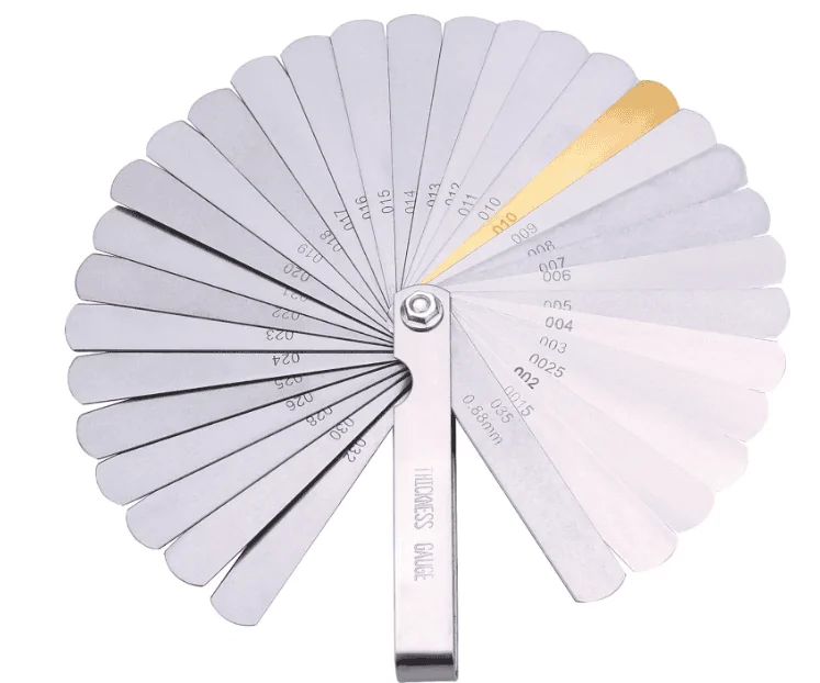

Feeler gauge below. If you need to check something more than 0.030" for example, maybe 0.045, you slip the 30 and 15 together and see if it slides into the gap. No forcing allowed. If it doesn't slip in, then you try a smaller stack until it just slides in.
No damage to anything.
Why is one brass? For checking the gap on things like the pickup coil in certain electronic ignition systems of decades past. A steel feeler gauge would stick to the magnet and mess up your feel for the right gap.
Those are typically .010" gap - thus, the brass blade here.
A feeler gauge isn't going to mess up a plug - not by anyone who knows even the most basic crap.

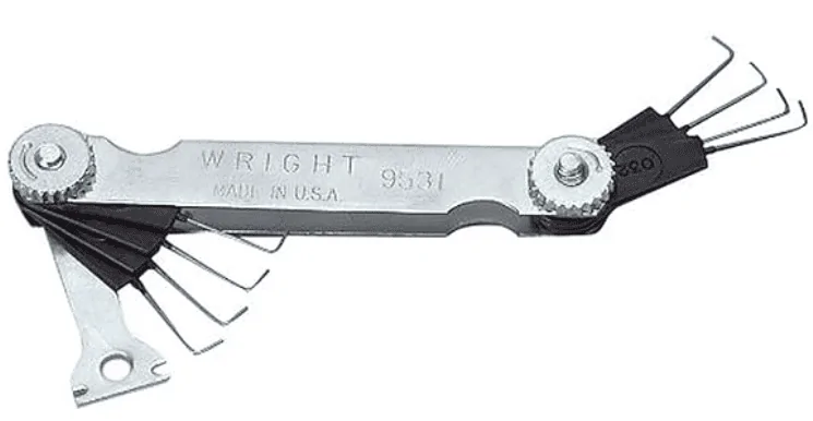

For those wondering what's all the hubbub about - who have not been familiar with all of the types of spark plugs over the years, and feeler gauge types and how to properly or correctly set the gap - when needed, on plugs where you are supposed to set the gap - here's more -
I was trying to hurry and get out and mow before it got too bloody hot................. and forgot about a totally different type of feeler gauge used for spark plugs - the wire type feeler gauge.
I have several of each type.
The round wire allows for checking a gap on spark plugs that don't use flat, parallel surfaces. It can check concave or convex situations where a flat type would be totally inaccurate.
Instead of tossing Tovak off my lap and going way out to the shop and getting a picture, I grabbed one from Amazon. Different brand (mine dates back into the 1970s) but same thing. Note the "tool" most included to bend the ground electrode to set the gap. You never wedged or pressed or pried against the center electrode. In fact, when setting a spark plug, you just don't touch the center electrode other than to check the gap. You use a tool to move the ground electrode, and in legacy types, strive to keep the ground electrode parallel to the flat end of that type of spark plug.
The bit lower left in this pic is to put on the ground electrode to bend it to adjust gap.
