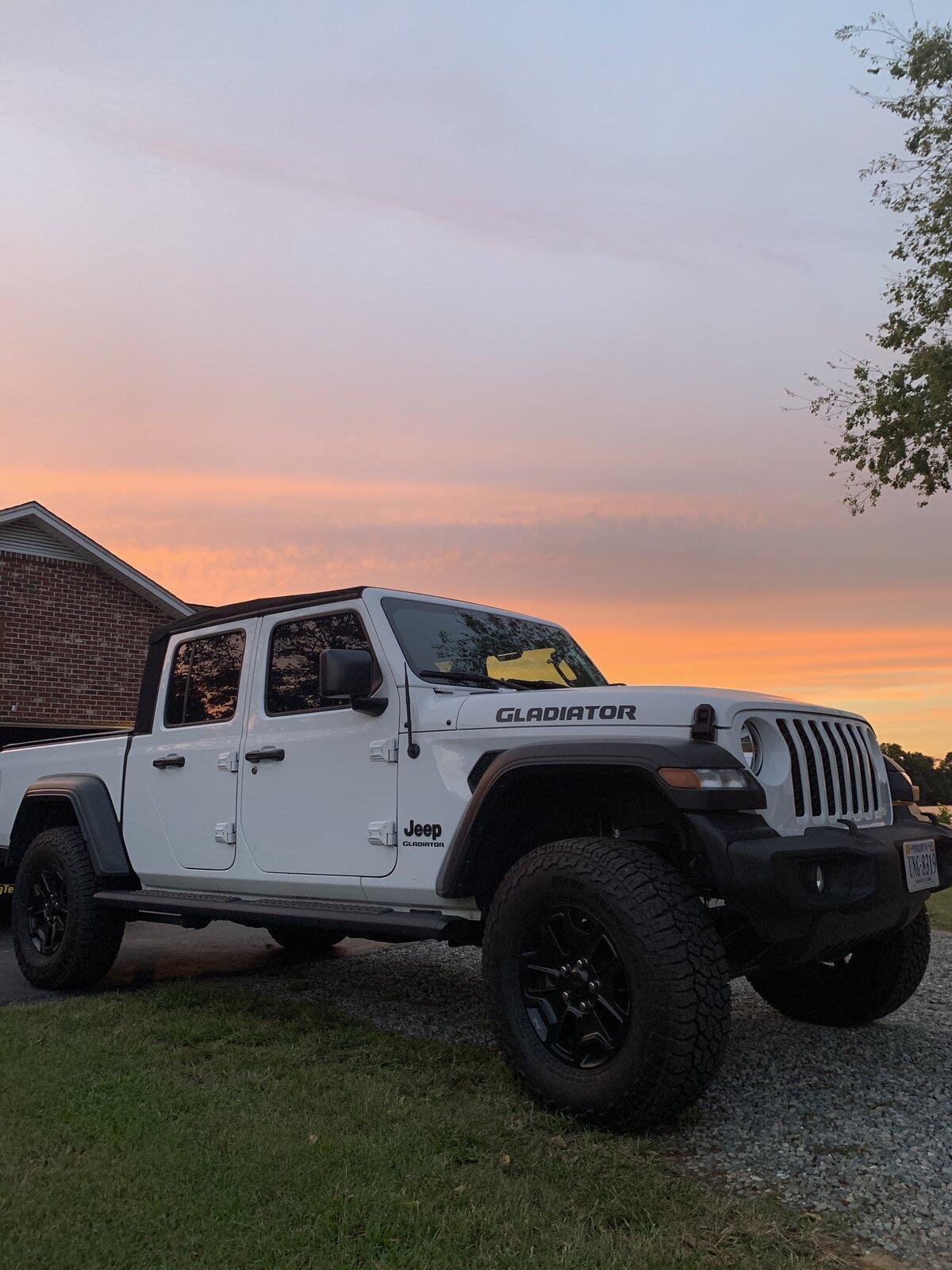

I don’t know if this helps, but I run the front rubi springs and rubi shocks all around and I like the set up on my sport w max tow. Slight rake, .5-.75” barely noticeable. When I tow my TT I have a WDH so the rake isn’t needed. Generally speaking, if you tow something that drastically affects your rake, you probably need a WDH. Also, your low beams are going to be hitting everyone in the face at night time.
I ended up putting on a 2” spacer lift and love the stance.
That's a fu#$ing nice truck. ?
