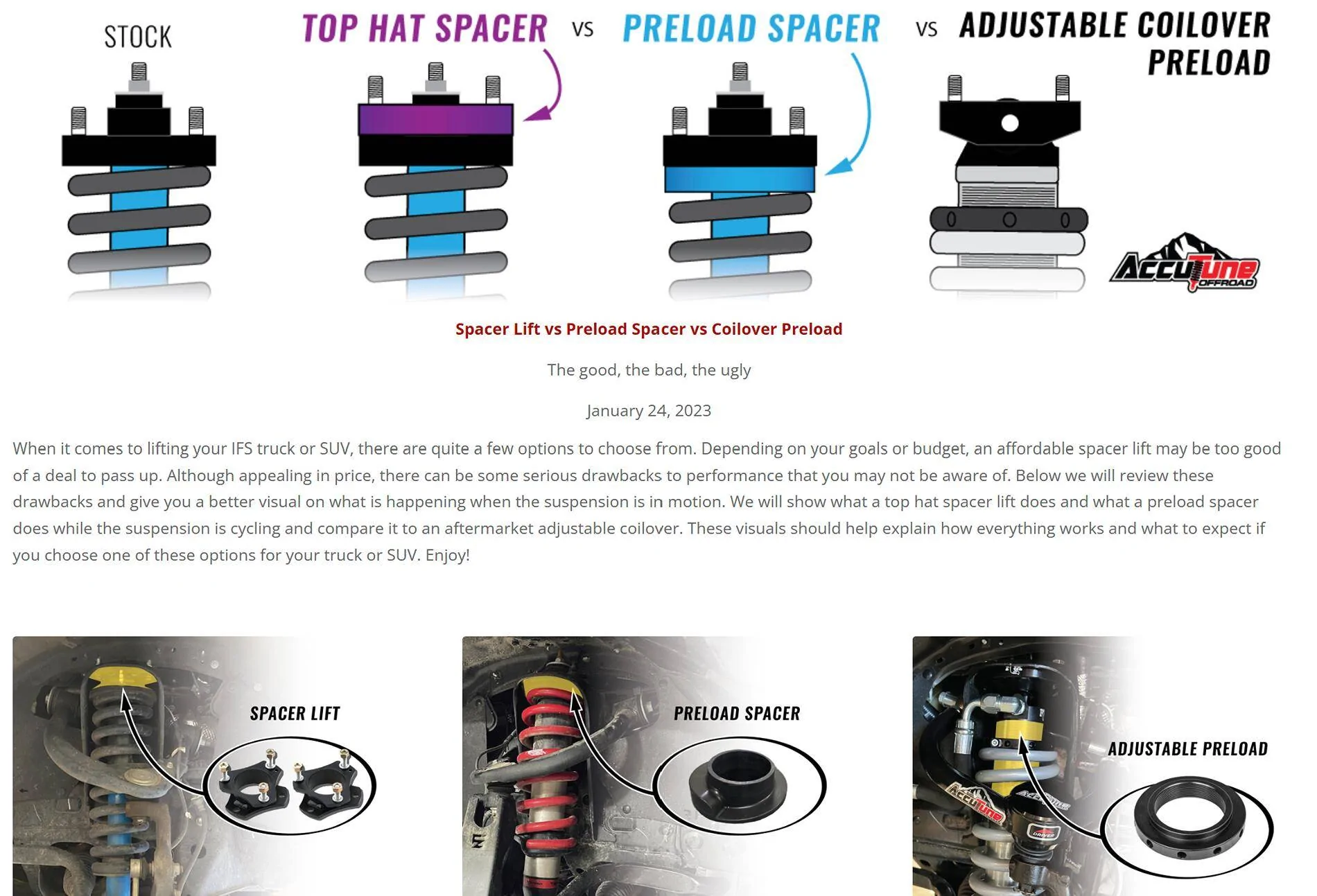

Spacers pre-load the coils….. more tension…. Less suspension ‘movement’.
You won’t necessarily feel it on flat areas…..but you’ll feel the difference over bumps, etc.
Not really, especially on a solid axle rig. You're effectively lowering the top of the coil bucket by the size of the spacer. The coils will have the the exact same load on them. If the spring had a 150lb/inch rate and that corner had 1200lbs of weight on it (round numbers but close enough for a stock JT) the spring would compress 8" from its free length. Adding a 1" spacer only moves the top of the spring down and therefore increases the ride height by the same 1". The load didn't change, the spring still compressed by 8". With the mojave shocks staying in the ride zone is critical as the internal bypass makes them super stiff at both the top and bottom of tire travel. Being that the mojave sits an inch taller, the 1" spacer just puts the front shocks right in the middle of the ride zone. Unless you're compressing the spring to the point of coil bond that spacer didn't cost any suspension movement. The stock coils won't get into coil bind with stock bump stops even running a 2.5" spacer. Now a 2.5" spacer would cost downtravel running stock shocks and the mojave shocks would not be in their ride zone. That's why the AEV mojave specific 2" kit has 2" bump stop spacers, 2" coils spacers, and shock extensions to keep everything in its optimal ride zone and therefore doesn't affect ride quality or suspension movement.
