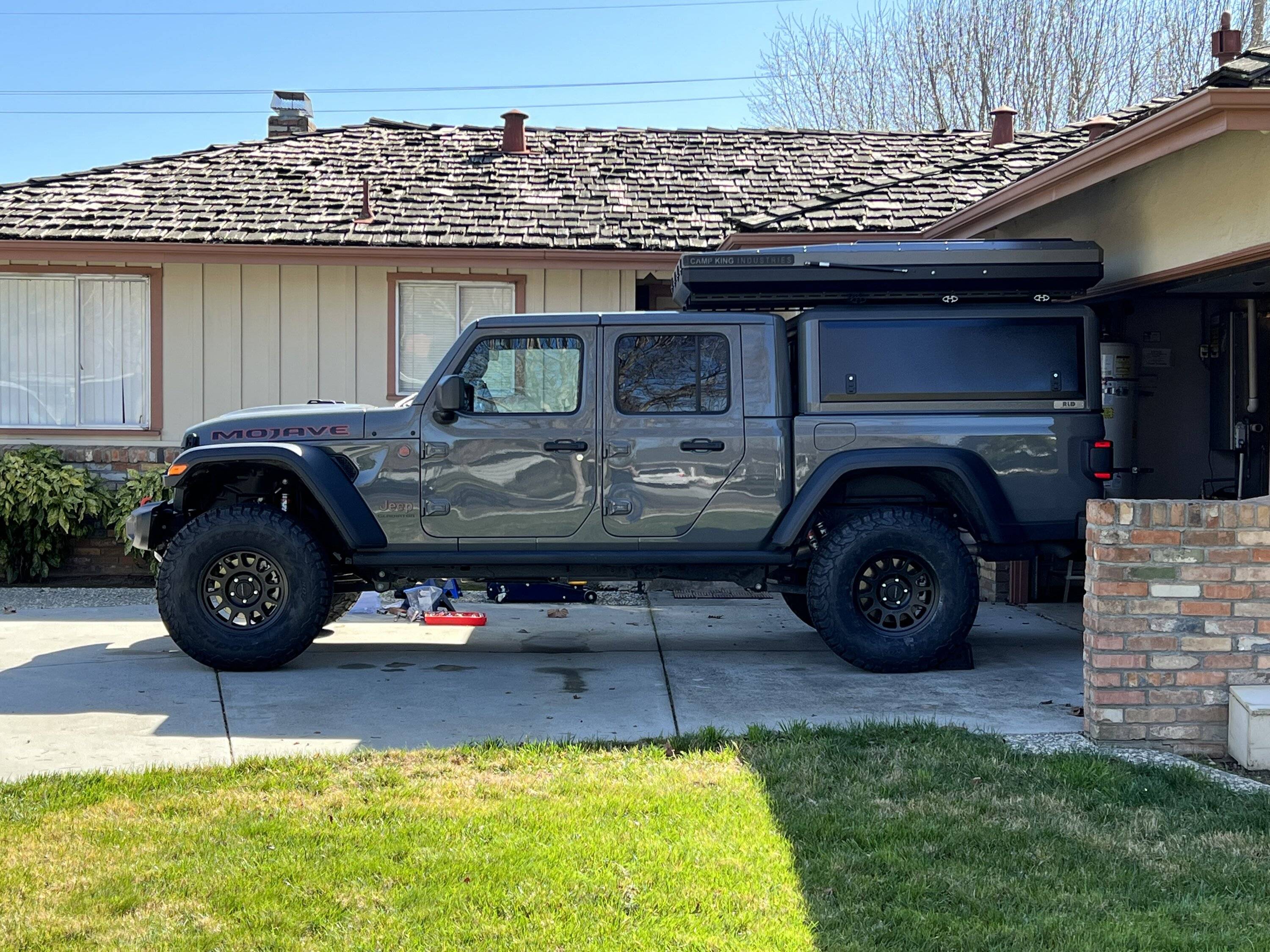

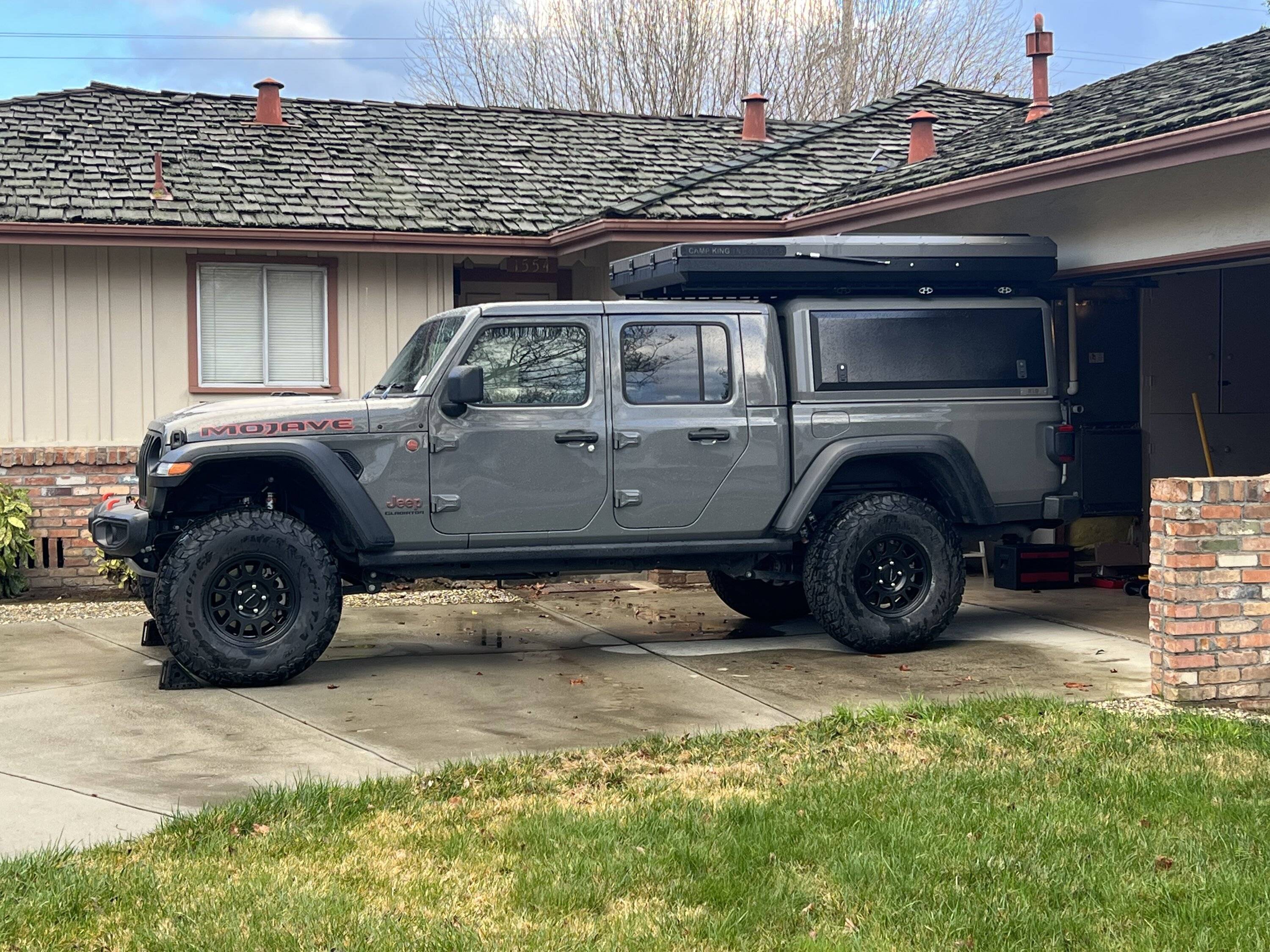

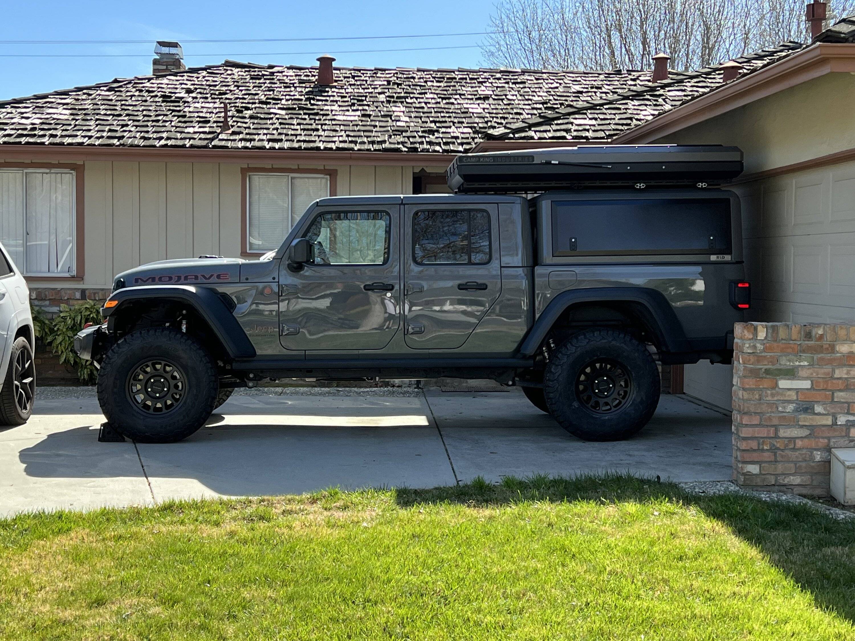

The Clayton 2.5" springs definitely help with weight versus the AEV 2" spacers.
Both pics are with the spare tire removed, which is around 90 lb. The RLD cap (175 lb) and Camp King roof top tent (198 lb) add a constant 373 lb load over the bed. The tires are 37 BFG T/A KO2's.
AEV 2" Spacers (w/o Spare)
Jeep Gladiator Mojave 2.5 Frankenlift AEV Spacer Lift
Clayton 2.5" Springs Front & Rear (w/o Spare)
Jeep Gladiator Mojave 2.5 Frankenlift Clayton 2.5 Lift

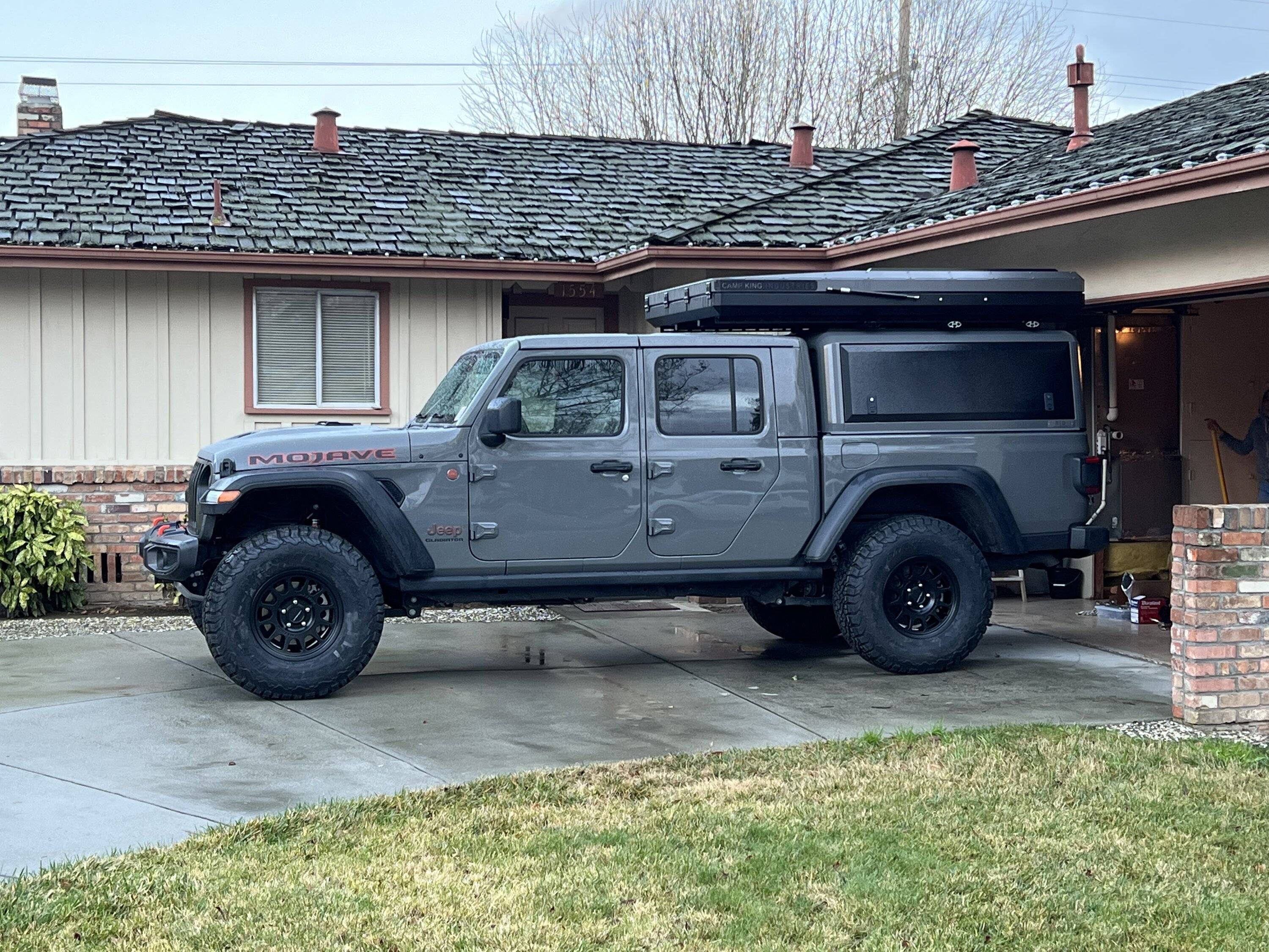

Adding the spare tire back in, which as mentioned is around 90 lb, causes some squat in the back. Adding additional gear when overlanding will cause it to squat even more. Below pic has 3" of lift in front and 2.3" of lift in rear, after squat, compared to a stock Mojave.
Jeep Gladiator Mojave 2.5 Frankenlift Clayton 2.5 Lift with Spare
So I swapped out the front Clayton 2.5" springs for Clayton 1.5" springs to get the stock rake back. That gave me 2.3" of lift in the front and 2.3" of lift in the rear.
Clayton 1.5" Springs Front, 2.5" Springs Rear
Jeep Gladiator Mojave 2.5 Frankenlift Clayton 1.5-2.5 Lift

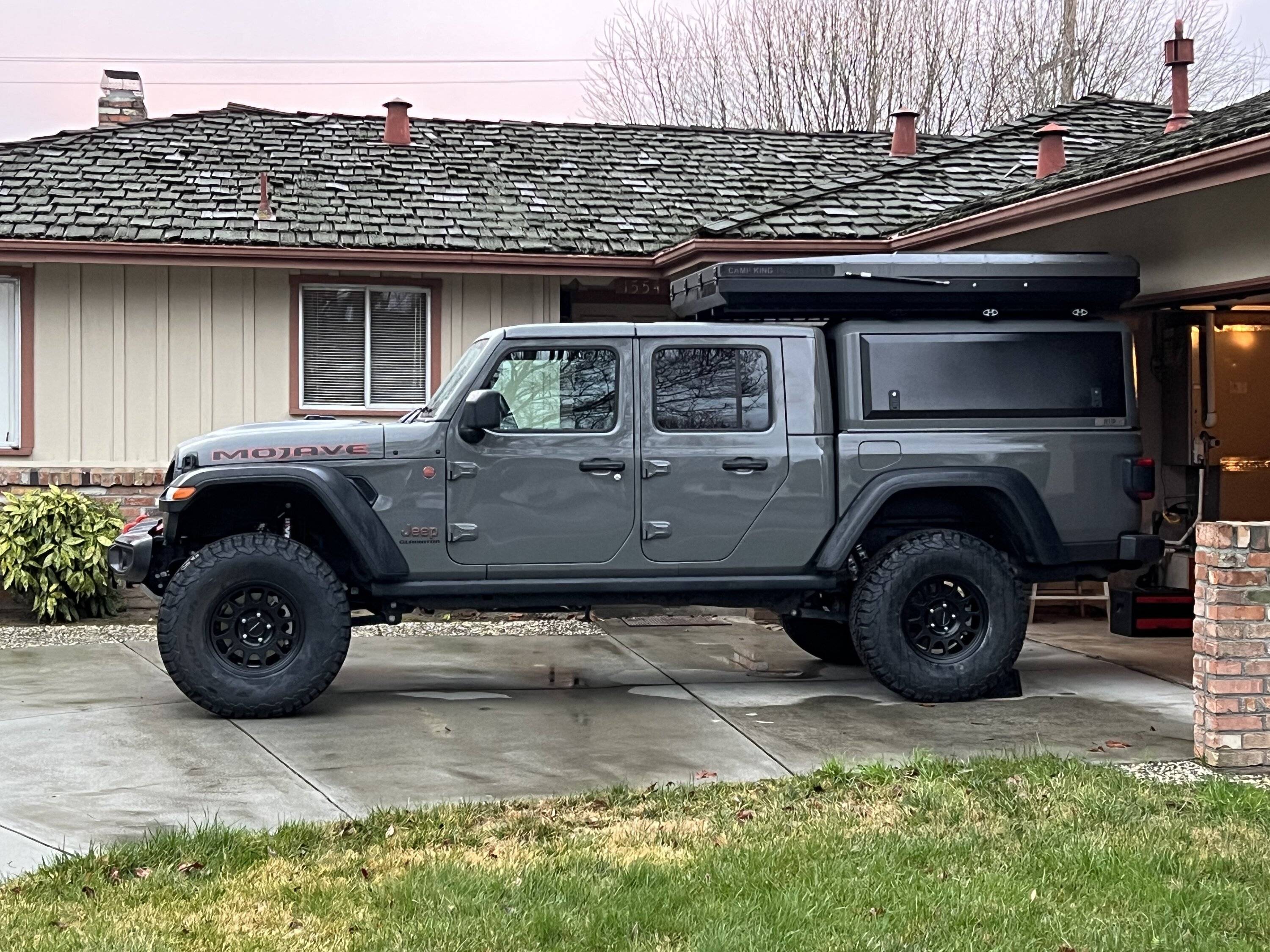

After a test drive the front settled 1/8" and the rear 3/8". So I installed Teraflex 0.5" rear spring spacers to get the rake back. That gave me a final 2.2" of lift in the front and 2.5" of lift in the rear.
Clayton 1.5" Springs Front, 2.5" Springs & 0.5" Spacer Rear
Jeep Gladiator Mojave 2.5 Frankenlift Clayton 1.5-2.5 Lift w Spacer

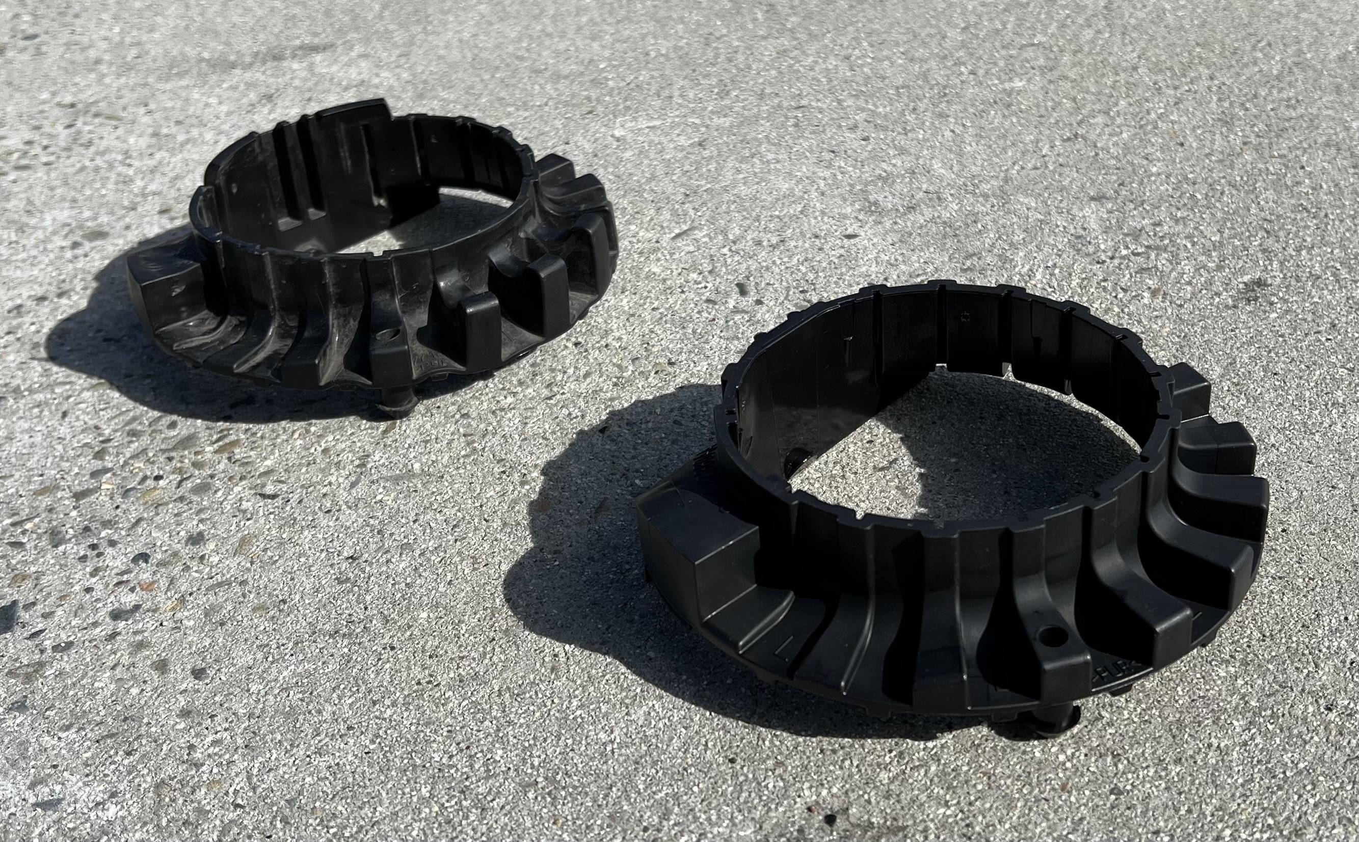

I also installed the updated Mopar front left lower spring isolator that has some coil correction for longer springs: TSB 02-006-18. Left is original isolator 68466077AA, right is updated isolator 68427380AA. Note less curvature in the profile.
Jeep Gladiator Mojave 2.5 Frankenlift Front Left Lower Isolator 68466077AA vs 68427380AA

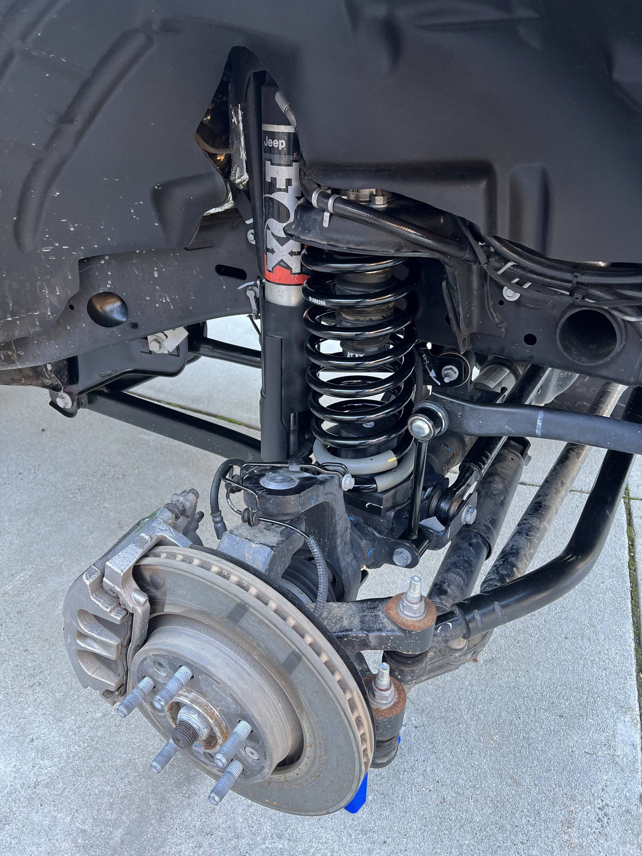

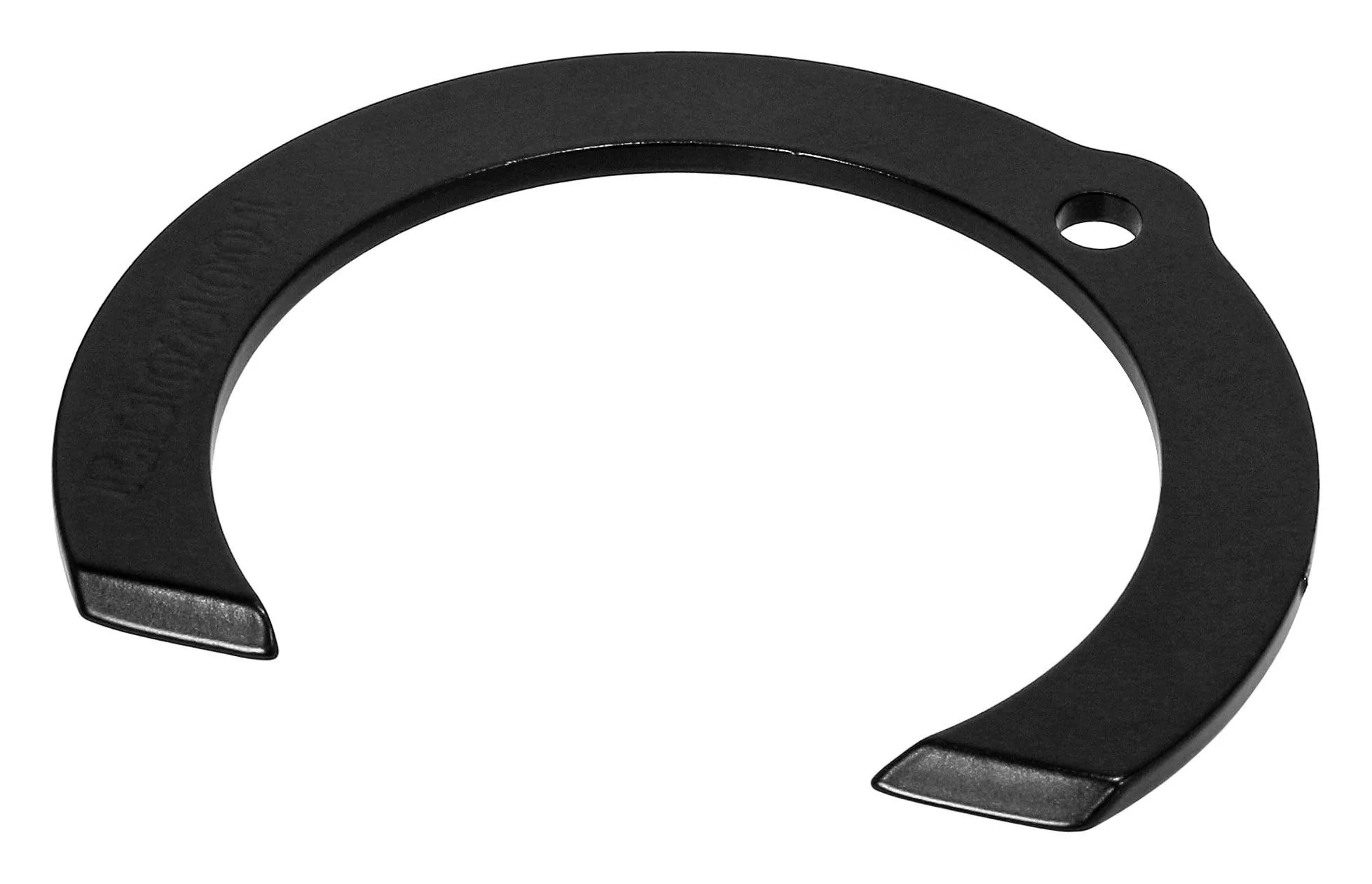

And the Rock Jock front lower isolator shim on the right to keep the Gladiator even after replacing Jeep's corner specific springs with Clayton's equal rate springs. AEV includes a similar part in their DualSport kit.
Jeep Gladiator Mojave 2.5 Frankenlift RJ-107100-1 - JL:JT Front Coil Spring Shim
Completed front right lift (AEV+Clayton+Mopar+Rock Jock)
Jeep Gladiator Mojave 2.5 Frankenlift Front Right Lift

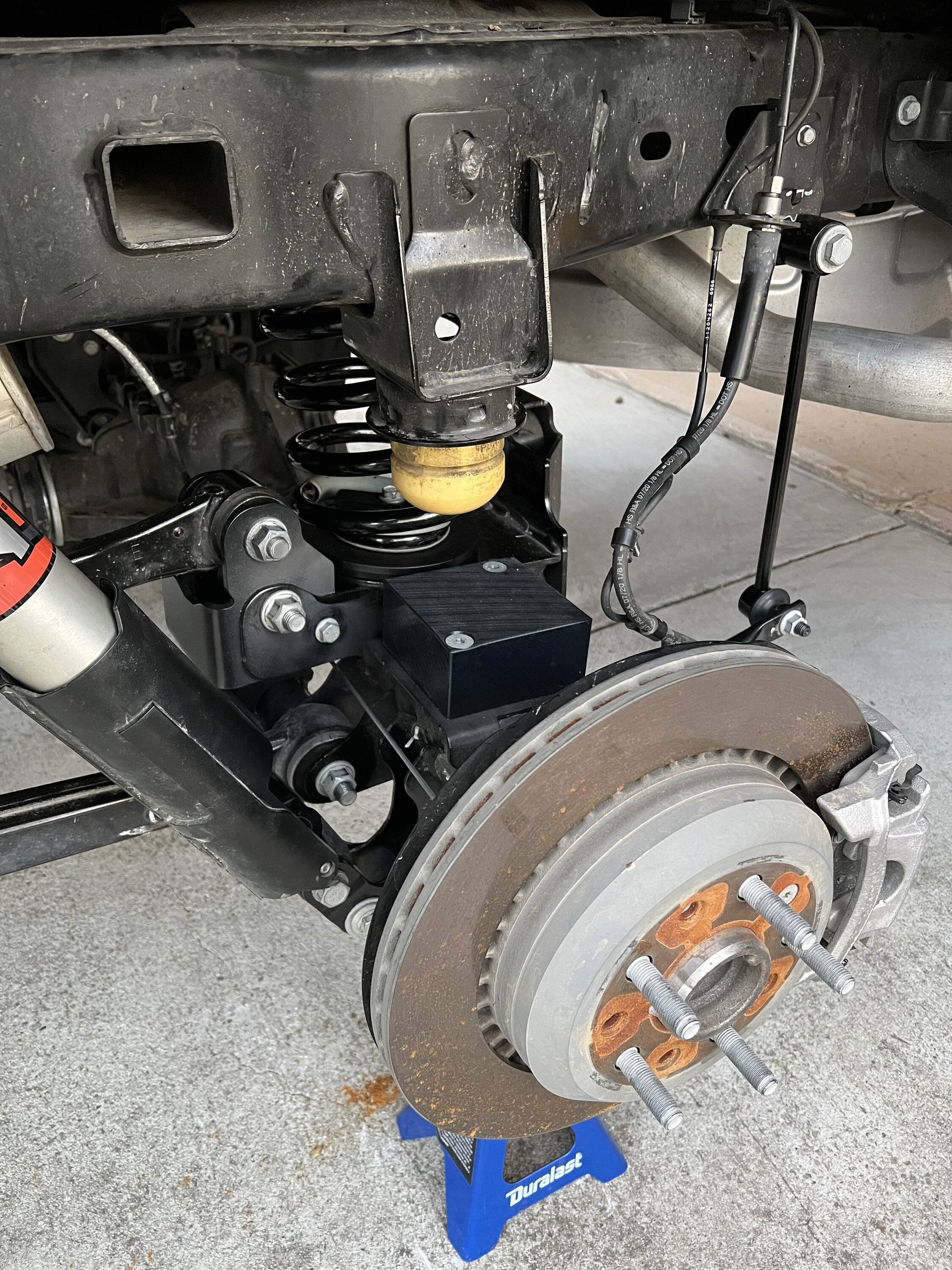

Completed rear left lift (AEV+Clayton+Teraflex)
Jeep Gladiator Mojave 2.5 Frankenlift Rear Left Lift
