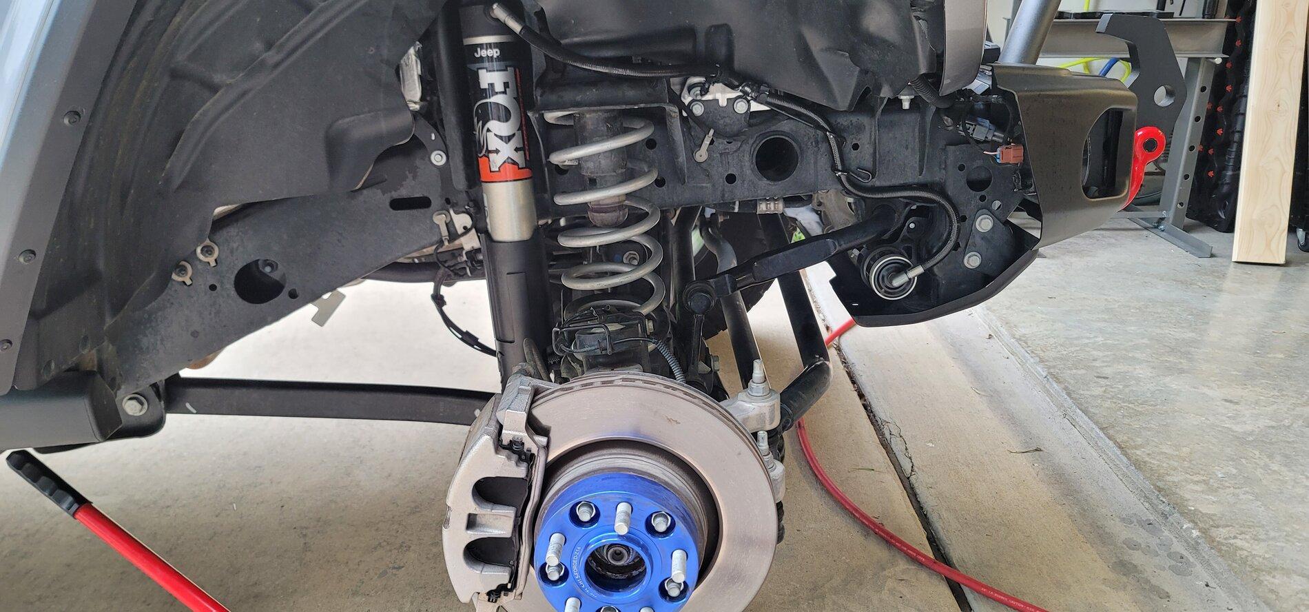

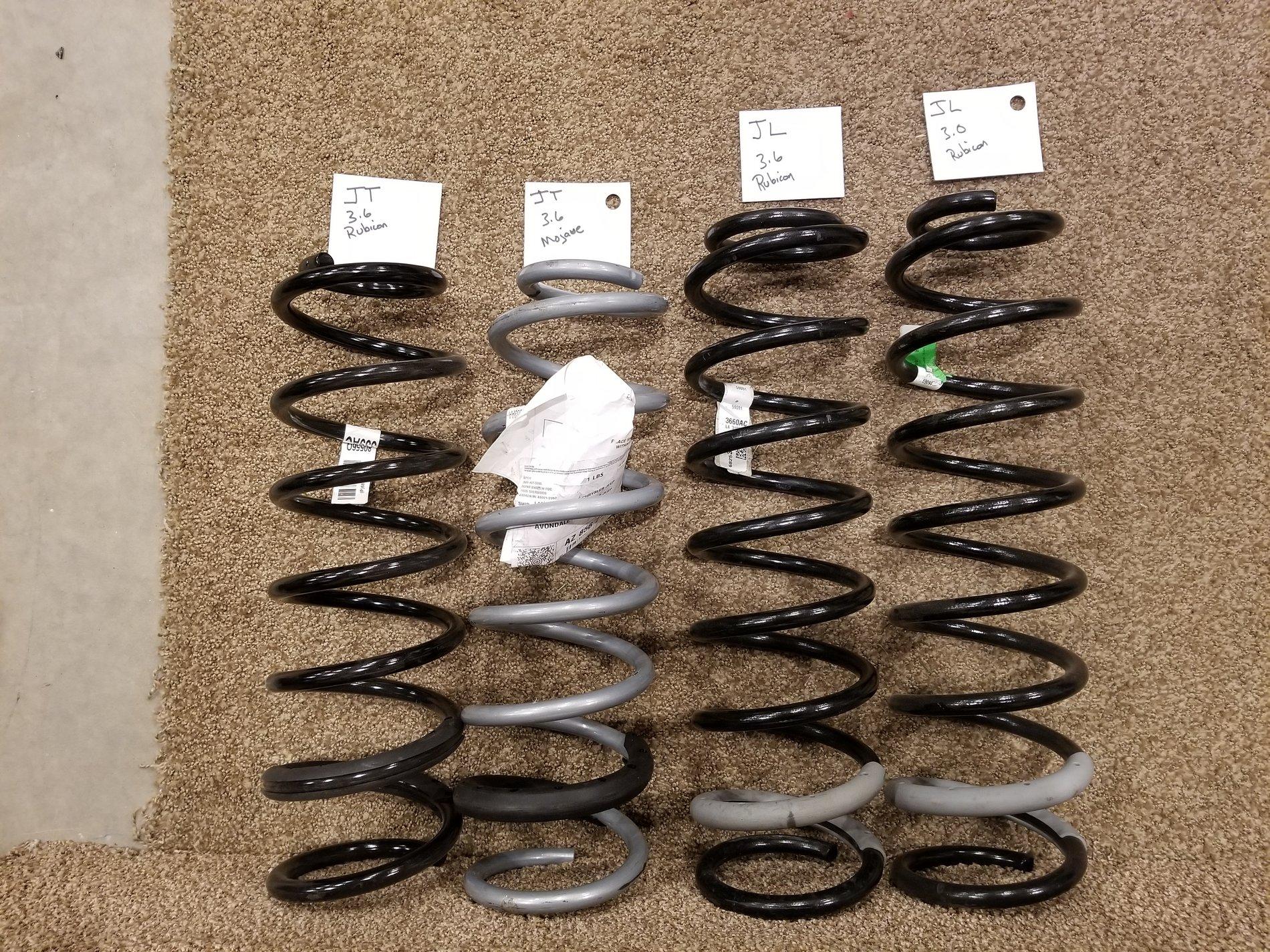

I didnt gain any front height. Nearly identical to my rubi springs.
Update: 1/4” gain on the front after moving the jeep. I was expecting .5” or more. Oh well, im going to add my extra .5” spacer this afternoon. No biggie to do it

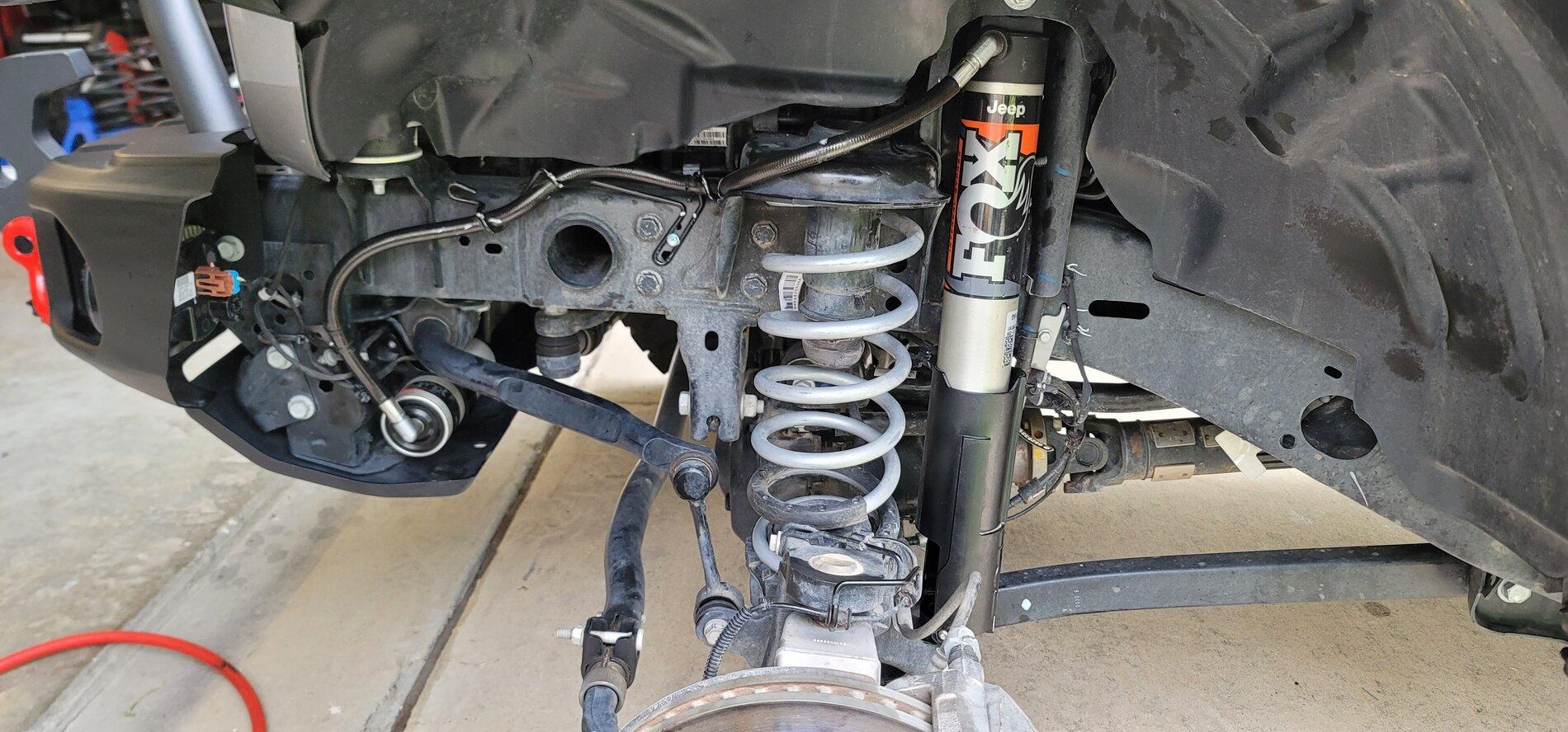

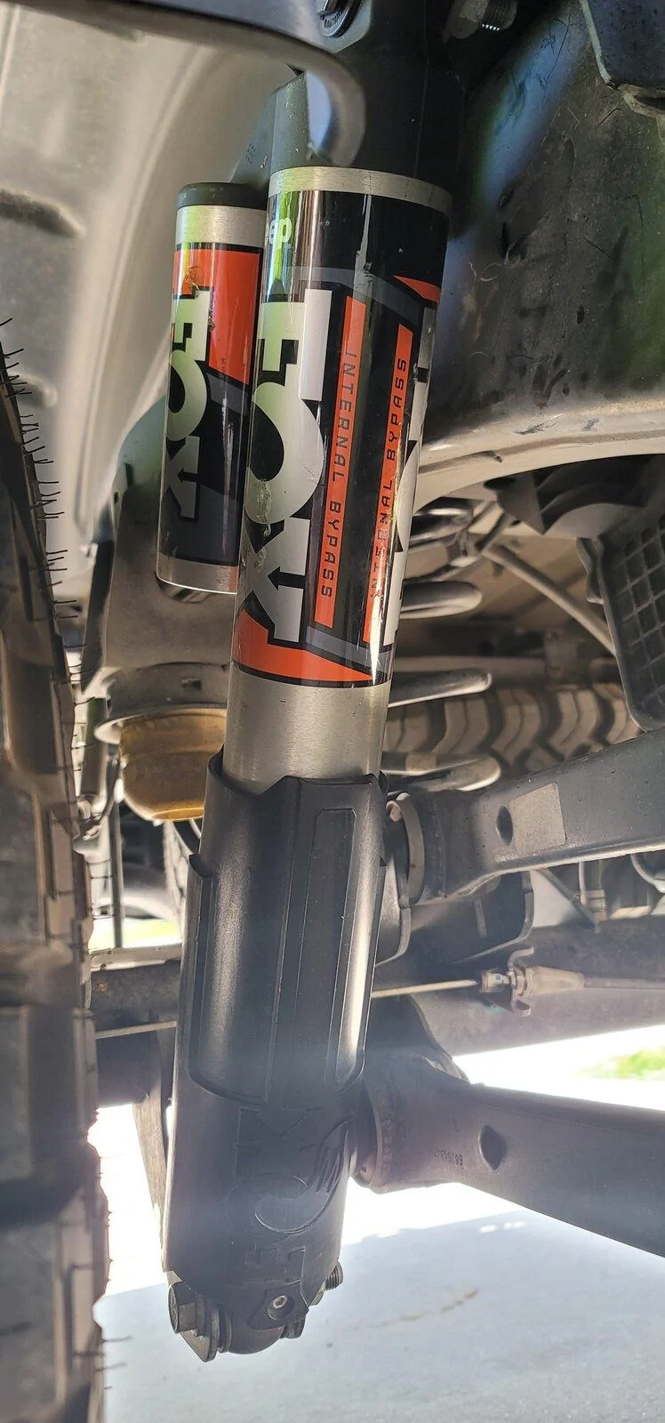

So I added my .5” spacers, now 2” total up front and .75” out rear. The Mojave springs matched up the Mojave sghocks make it drive much smoother. Did a quick route that involves broken asphalt and railroad crossings. Yeah much improved, worth 4-5 hours work.

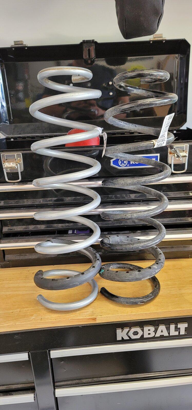

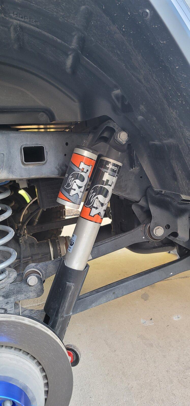

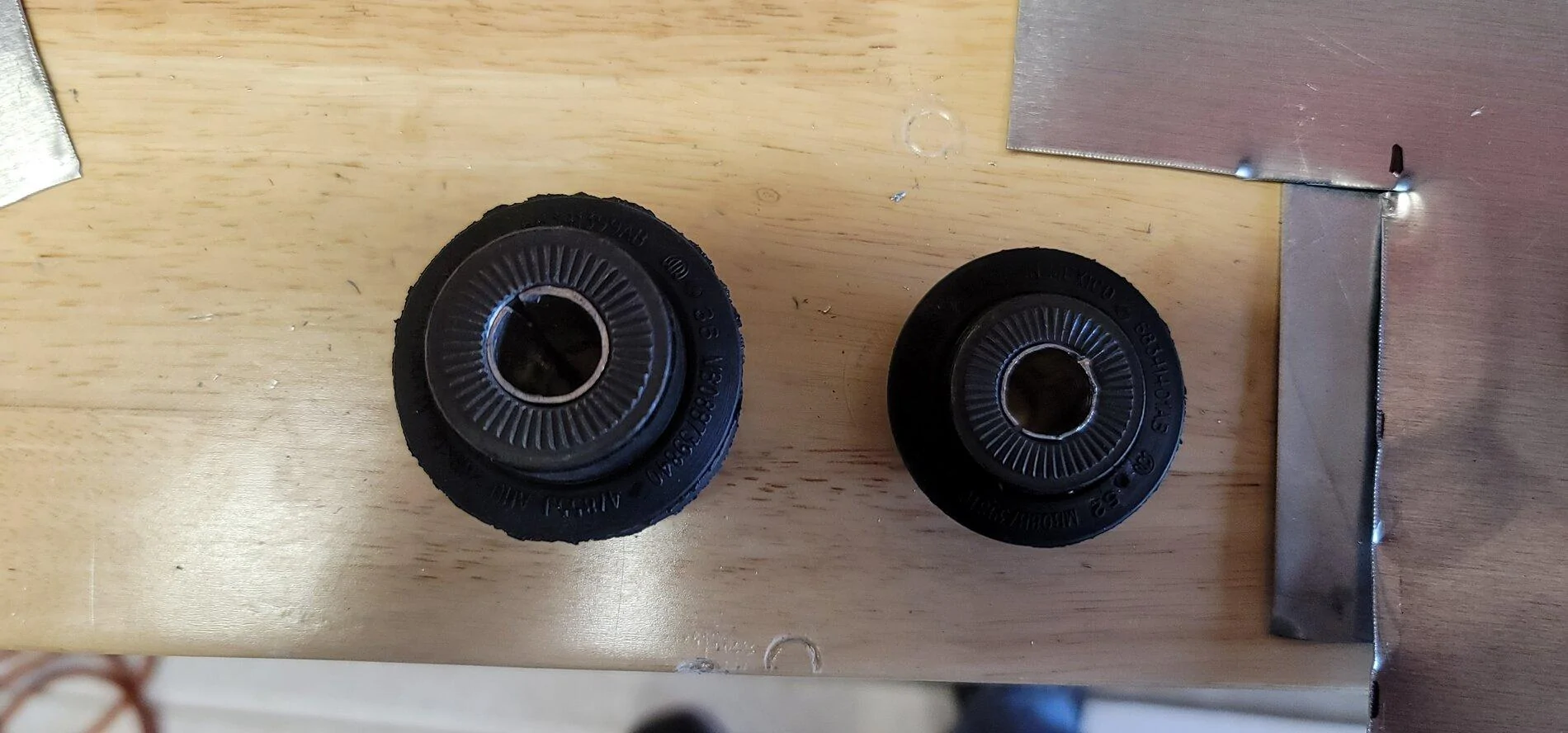

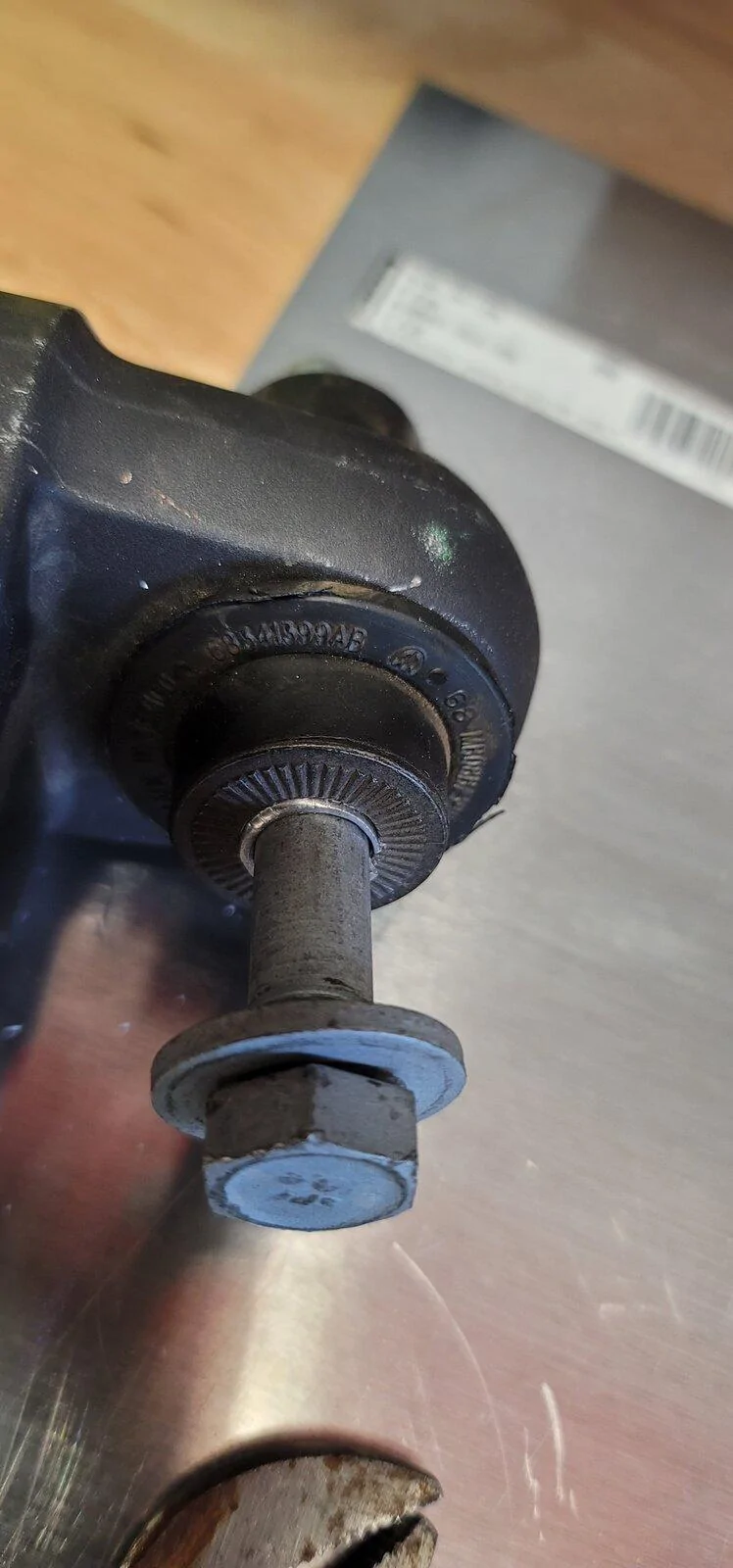

I have done this swap.. Springs and shocks both.. The rear shocks are a direct swap. The front you will have to make your own sleeve for the bushings since the bolts on the Mojave are bigger.. Noticed a 1" height in front and a much better ride.. The springs are the same length but the rates are different..

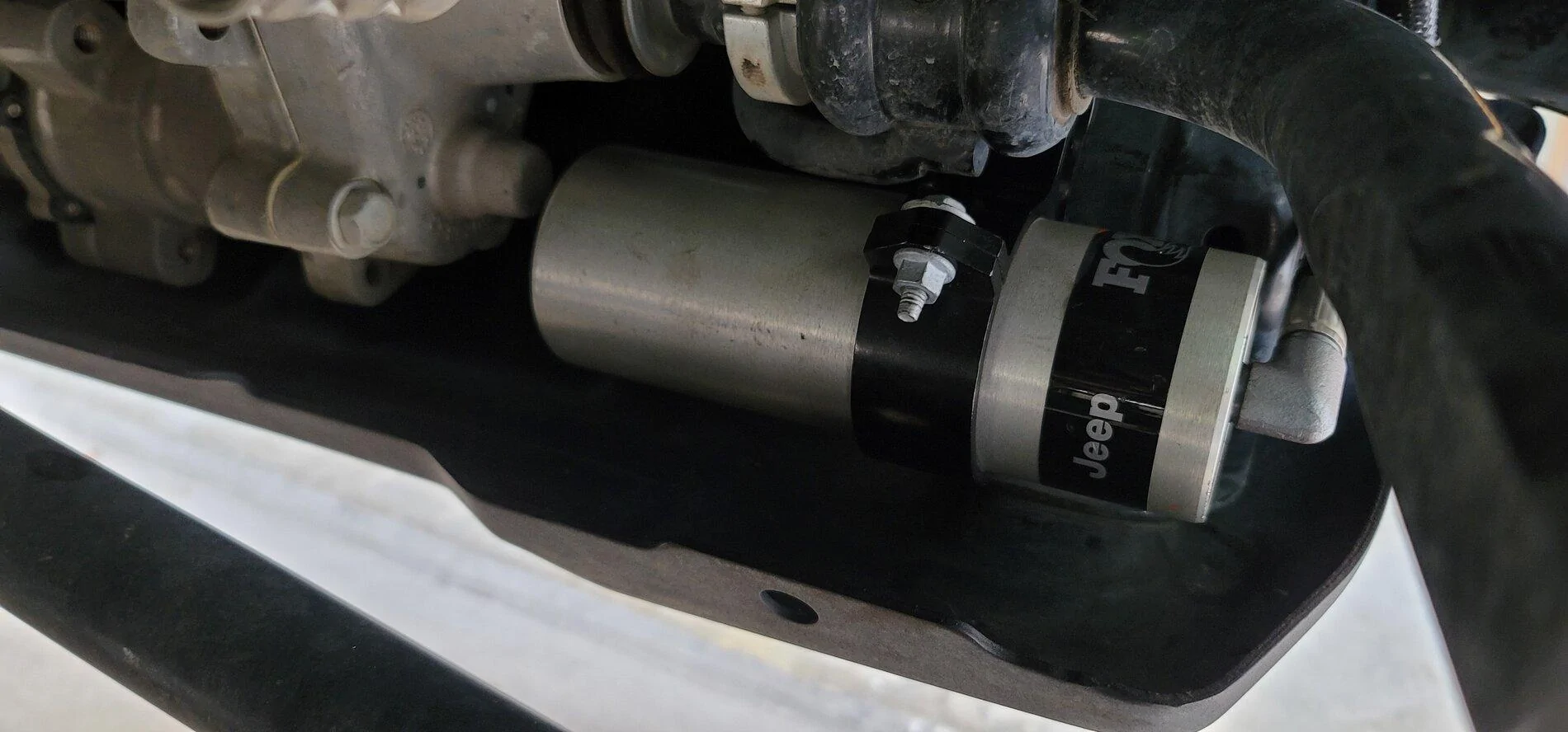

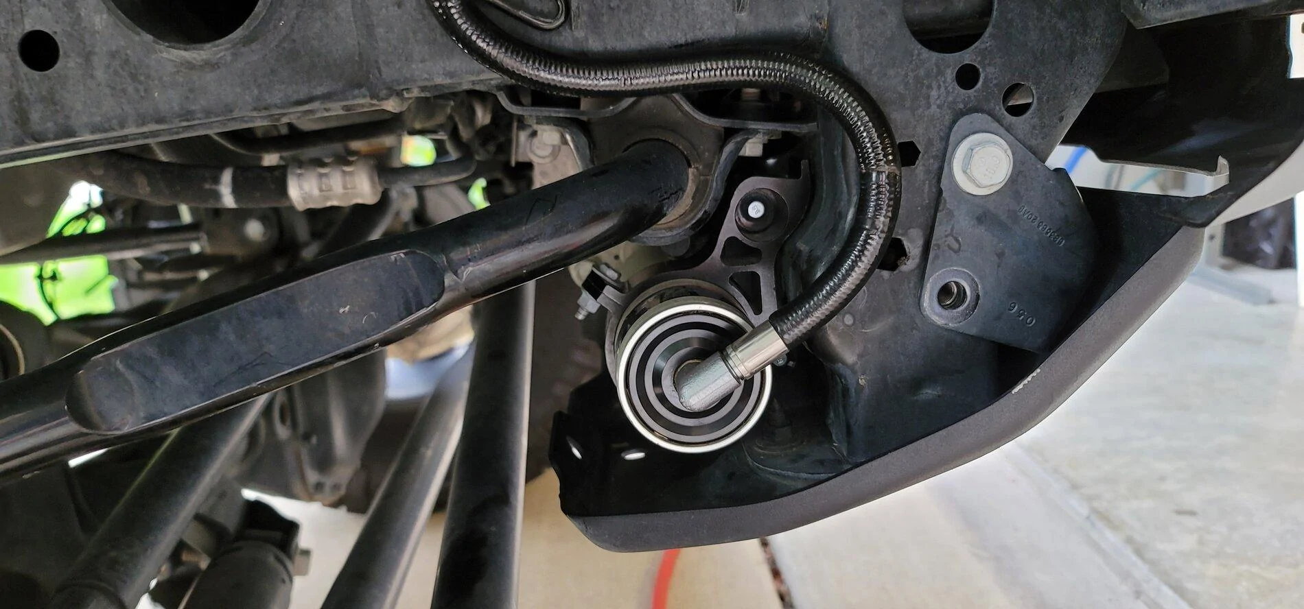

I was told the reservoir wouldn't fit in the Rubi because the disconnect assy was in the way.. Not the case.. Bolted right up!
Hope this helps anyone who's thinking of doing the same..
What did you use for a bushing?
