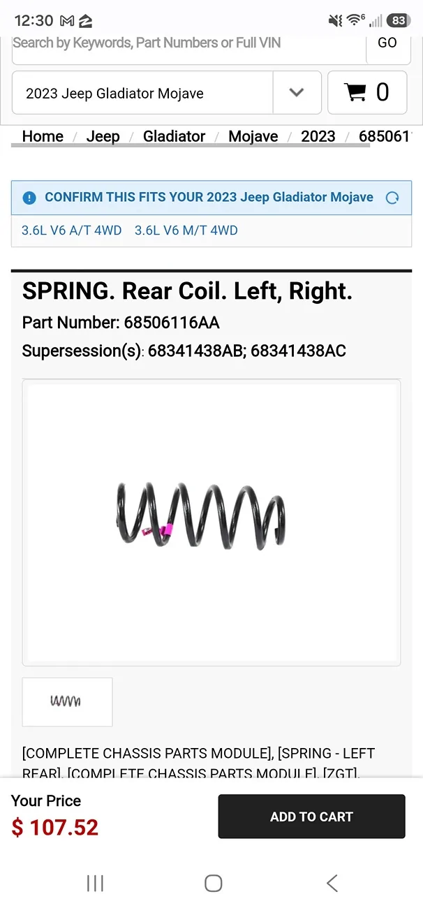

Stock? Mine are long gone, but the pictures from mopar show a single rate.
The ones I have are silver, have the plastic isolators, and are dual rate. I'm going to guess from memory thst they came from a 2020 truck?
I think those are the front coils. Rears are dual rated and you can see it pretty clearly in the pics. Mojave X rear coil part number: 68607529AA

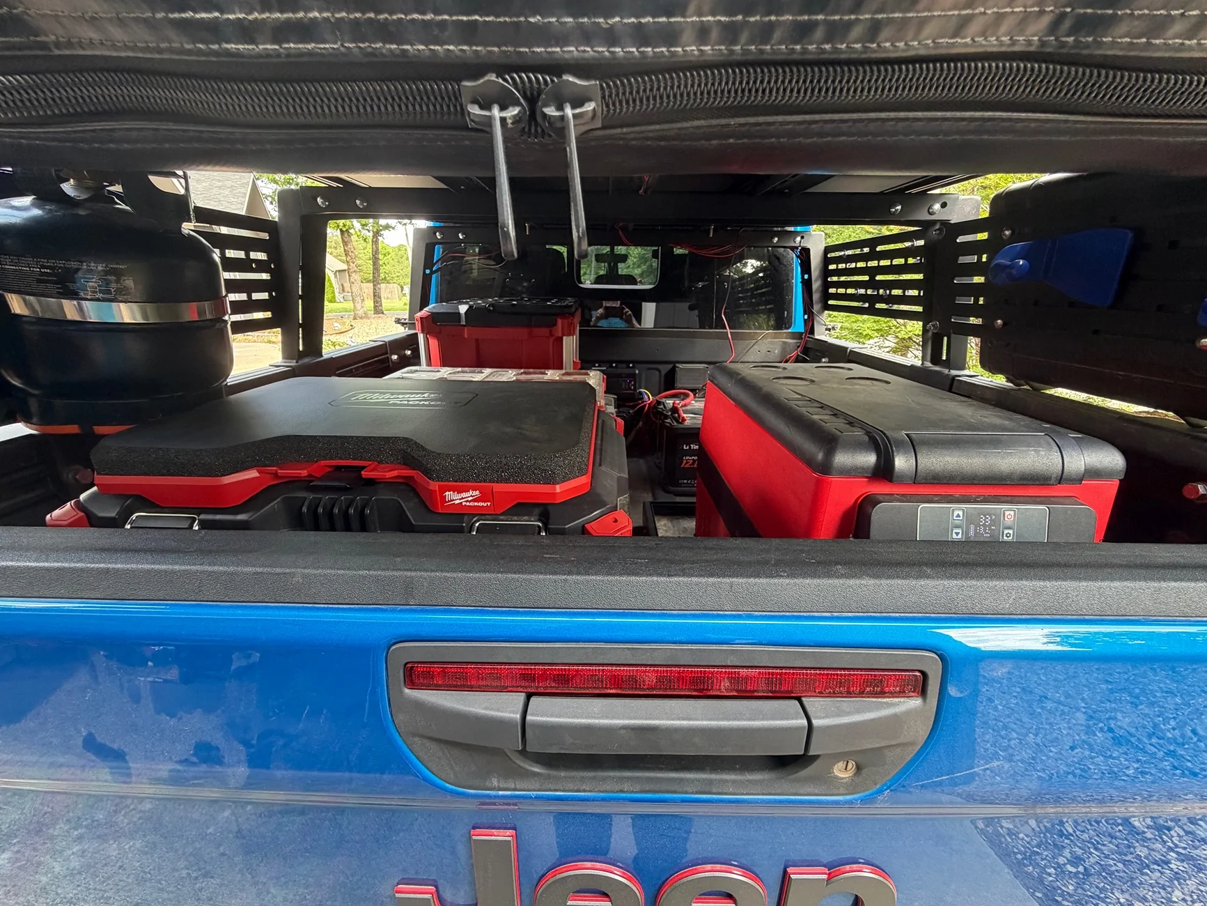

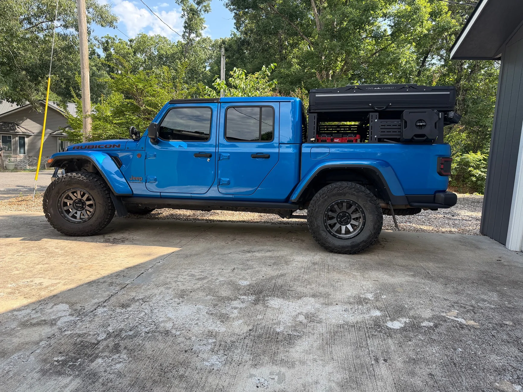

You had commented recently on my thread about stock heightish with heavy weights using Clayton 1.5” springs and falcon 3.3 shocks. Mines a rubicon, not a Mojave but if I understand right the rears are the same height, the Mojave just sits 1” higher in the front…I do have a 1” spacer in the front of mine and similar weight to you so things should be close to being comparable. The 1.5” Clayton springs have gotten me back up to stock height in the rear and I actually have a tad bit of rake but not much. That is just with the rear springs and the 1” spacer in the front. I have not installed the front 1.5” springs or the falcon shocks yet. I can tell you it rides much better than it was. I felt like I was pulling a heavy trailer everywhere with me before with all the bounce and roll I had. Now it just feels close to stock…I can’t wait to see how much the shocks help on top of the Clayton springs. I might have to add a small spacer in the rear when I do the front 1.5” coils, we will see.
the picture here is with a loadout pretty much ready to go camping. 160 pound rack, 250 pound tent, fridge full of drinks without food at the moment, fridge slide, full 5# propane tank, 2 100 ah lifepo4 batteries, 2 rotopax full of water, a box full of recovery gear on the side, 35” spare underneath, 1 box with kitchen setup, 1 box with misc camp stuff, 1 box with chainsaw and tools, 1 box with hammocks and zero breeze attachments, zero breeze in the back seat, a pop up firepit, portable toilet setup, Starlink, camp lighting, and a full tank of gas.

Now seeing the picture of your rig fully loaded (looks leve or just slightly lower in the back), I reckon I'll be somewhere in that ballpark when I'm completely kitted out.
