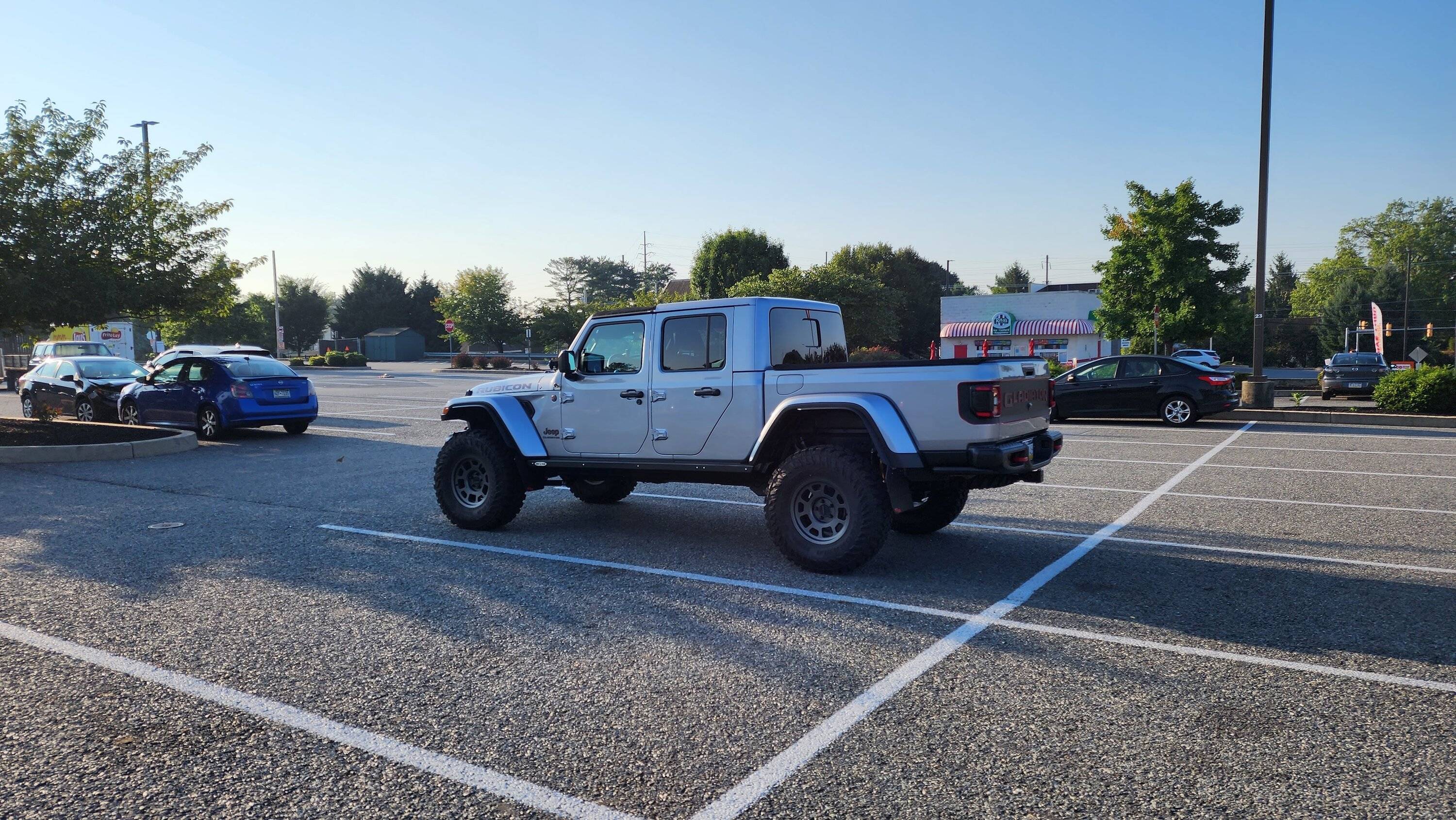

My experience - I ran the AEV 3-inch coils with Clayton arms, Teraflex control arm brackets, and Fox 2.5's. The ride is good, soft-ish, so I needed to increase dampening on the shocks. For my application, I ran into a concern where the lift from the coils was closer to what I've seen for a 2-inch vs 3-inch and the rake was really pronounced. I put a one-inch Teraflex spacer up front and it was better, but still had a good rake to it. My application was not a constant load (towing). I've seen these hi-cap coils on a JT with a SmartCap installed and that did not even it out much. YMMV, but they can definitely hold weight.
In the end, I went to COR's 3.5-inch hi-cap coils in the rear with the 3.5's up front and that works for what we're trying to do. The ride is definitely firm with the Clayton coils, but I can account for ride with the shocks.
Makes sense, AEV tries to keep close to factory rake, clayton takes about half the factory rake out.
Roger that, After talking with AEV and Clayton, they were both looking at keeping the factory rake in the JT with their high-capacity springs, but that might be at two different points (loaded vs unloaded). That said, there was quite a bit of difference of height in the rear when unloaded between the two sets (F&R). The coil designs are different and the free length between the two are a lot greater than a half-inch. The AEVs are what I'd consider dual rate vs triple on the Claytons, as disclosed.
Hoping this might be of use at some point for someone who tows and doesn't want to rely on airbags, which I used for some time, but decided they weren't getting the job done for me when towing.
