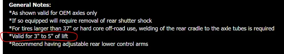

Side Note: RK does recommend bumping the rear springs up 1" for heavier JT's.
  • If building an "overland style" or heavily up-fitted build in the back, we recommend upsizing 1” in coil lift height for the rear.
