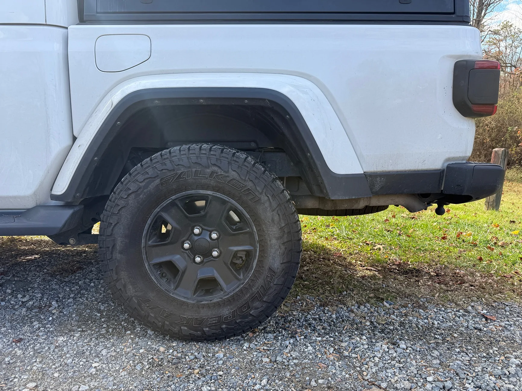

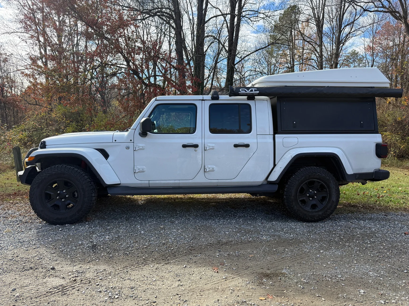

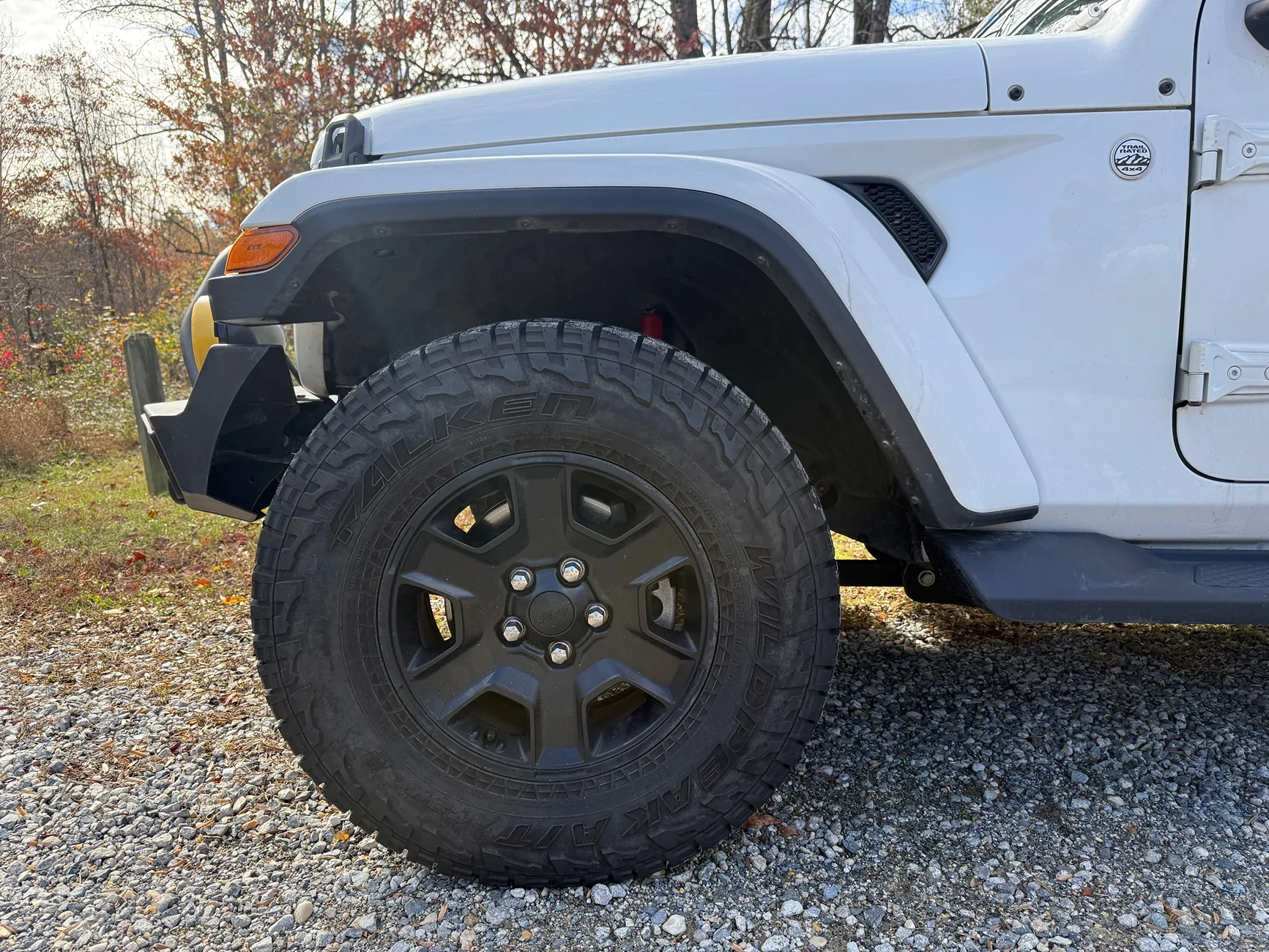

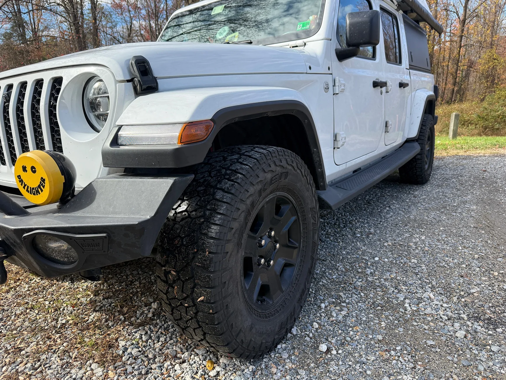

I have a 3.6 overland with Mojave front springs (stiffest oem JT option) and overland rear springs with airlift 1000 bags set to 30psi in them. The overland has the lower sport flares paired with factory mojave/rubicon 285/70r17 takeoffs. The mojave front springs netted 1.5” of height gain with my full width warn steel front bumper (no winch). I’ve been really happy with this setup, so I wanted to share the details. As it sits, there is .5” rake to the front. No problems with rubbing (I don’t disconnect sways). I chose to pair it with rancho 9000 front shocks at the stiffest level, which handle canyon roads amazingly well.
