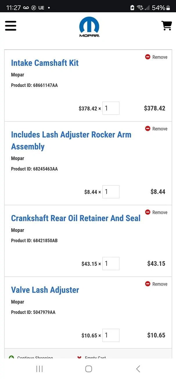

contact all mopar parts and tell them you need the cam kit for the right side and they will give you all of the parts, price and you will need the kit CTA Tools 1205 Cam Phaser Locking Tool Kit - Compatible with Dodge Pentastar VVL 3.6 to remove the cam timing chains. i am watching this issue with my gladiator as i found some metal particles in the oil filter on the last oil change.

Replace it, replace all the lash adjusters ("lifters"), replace the rocker arms. If it is indeed the right intake, Jeep sells a kit with all the parts except the lash adjusters. Those are $5 a piece tho. The right intake cam is basically a wear-item on these motors unfortunately.
