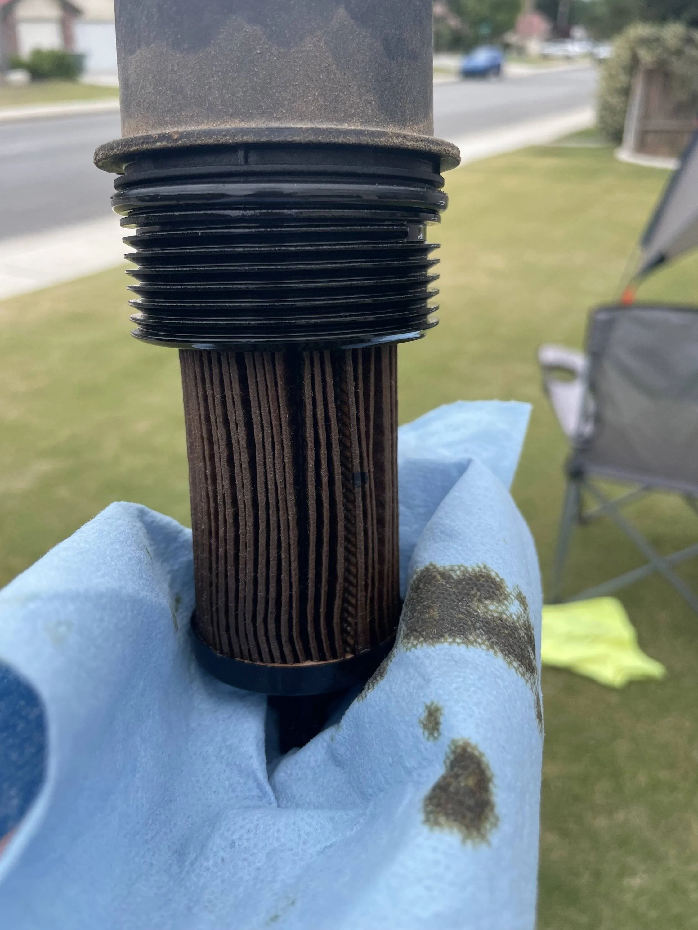

That filter is very, very old. It has 2 tears in the pleats on the side shown in the photo and big piece of dirt or whatever. If this is your filter you need to aske for it back so you can have it looked at by a third party. Yes, a good dealer will keep the old parts since you paid for them in the first place. The oil looks like it came out of a diesel rig since its so black. I have never seen oil that black in any gas motor.

I would ask them to prove that is your filter.......
AND..........to see the inside the oil pan and to remove the cam covers to see the so called sludge in there........even at 6,000 oil change interval there should be no sludge.

I’d also get an oil sample
And send to blackstone and get a TBN. That’ll show what condition the oil was truly in.
I change my own oil, photo document the oil being drained, oil going in and send a sample to blackstone.

Maybe someone changed your oil without changing the filter
This is my guess as well. I change my own oil for this exact reason. No one will take care of your car like you do. My guess is they changed the oil and left the filter. There have been many cases where people are billed for services that are not performed.

It would take more than ONE single miss on the filter change to show a mess like that with sludge.
Way back when, people used to do oil changes and change the filter every-other-time. It was normal, even recommended that the filter didn't need to be changed every time. Think of the times - the oil, the way cars were made and driven - and filters didn't look like that. Not in just one skip of the filter change.
If you changed your oil every 5,000 miles and someone else waits until the oil percentage is at 0, or around 9,000-10,000 miles, you would be saying that their filter would look like that or that 2 5,000 mile oil changes skipping the filter change once would be the same thing.
Sorry, that's not just skipping the filter change one time. If it was, that means every person who went the full 10,000 miles on an oil change would have black sludge and it just isn't so.
You'd have to go 10,000 miles between changes and skip the filter change at least one time to get like that. (I need to go back through all pages to see what oil was used as well - or how it was driven)
With today's oils and not if you actually warm the engine up and drive it for more than 10 minutes at a time you can easily go farther out without sludge.
There's still more to this story that isn't here.

I’ve changed oil filters on CAT engines that were cleaner than that one. Someone’s BS’ing you into paying for an engine.

Filters, though, are not the cause of sludge. You could go 20K on a single filter and not build up sludge. Sludge is from other causes. Filters don't create sludge.
