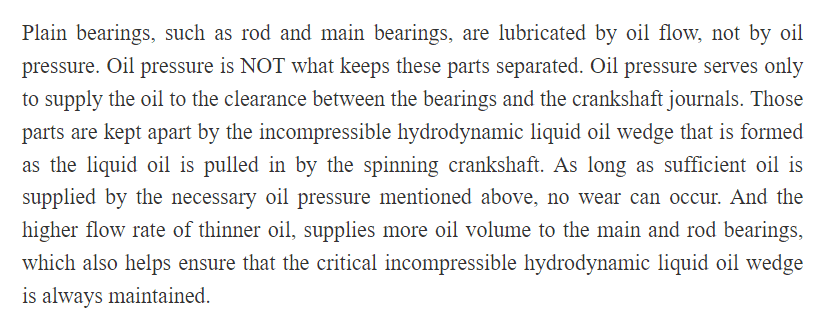

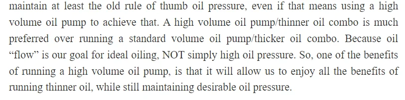

I've studied engine failures, engine damage, the effects of lack of lubrication and read many various studies on oil, engine protection and so on. It's one of the things I do - research, troubleshooting.
(I've included snippets from an SAE member who does oil testing and studies)
This is about protection - the oil wedge protecting between journal and bearing, and the film strength between cam lobe and follower.
Fluid can't be compressed so as long as there is oil between journal and bearing, it's protected.
In other areas, followers, cams, scraping and rubbing parts, it's the film strength. And that's nothing to do with viscosity. That's the ability to handle pressure.
We're not talking flow in various shaped passages, galleries, pipes or fittings. That's for exhaust, intake, coolant and so on.
We have a pressurized system with a flow far larger than prior factory oil pumps of the past. That's ensuring adequate supply. The pressures reflect that.

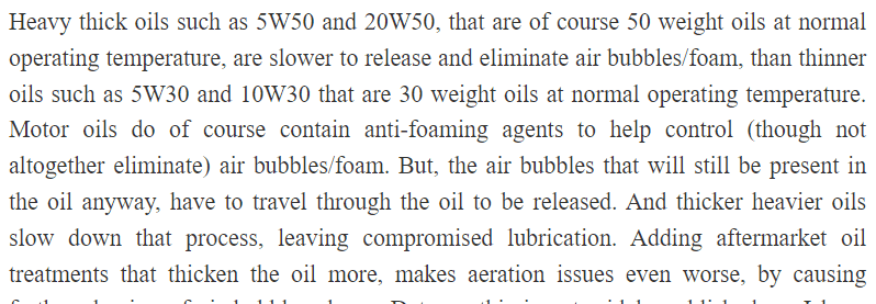

Running thicker oil has a side effect, too - trapping the air that is mixed into the oil by normal engine operation. Thicker oil doesn't let the air escape from the oil as quickly so it remains aerated longer - more air, less oil to each part. Thinner oil releases the air trapped by the windage, spinning and moving engine parts forming an oil mist in the crankcase.

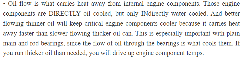

You increase engine temperatures by slowing oil flow as oil directly cools the internal parts, and you trap more air longer in the oil. Air in oil = not good.
