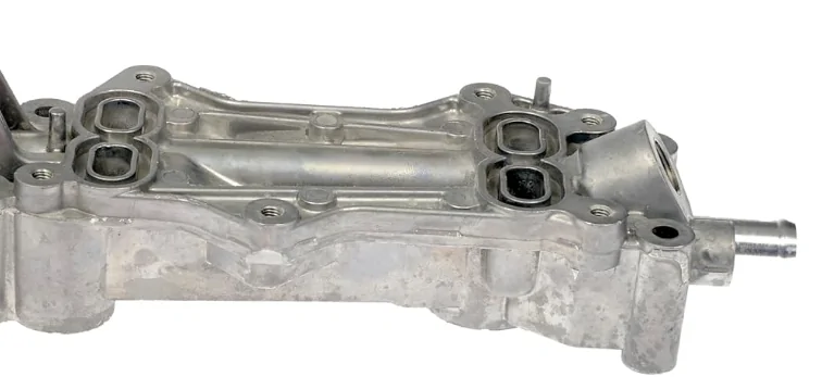

the dorman piece uses the old figure 8 seals, not the new design
The aluminum itself may help, but it's not a seal solution.

Figure 8? are you meaning octagon shaped?
No, like the figure or number 8
That center of the "8" is the problem area. The new MOPAR design has 2 distinct grooves, not connected to each other, so uses 4 seals instead of 2 shaped like an 8
Jeep Gladiator 3.6 oil cooler fail Screenshot 2025-12-13 204025

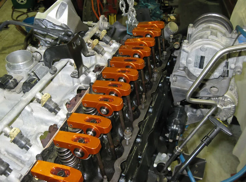

I never bothered with the drill. I either didn't prime that way, filling the filter manually, using assembly lube, or - using a speed handle and the appropriate bit.
Speed handle lets you know when pressure is built, the feel of the oil pump and so on.
In this one below - I hit 50 psi with that speed handle.
