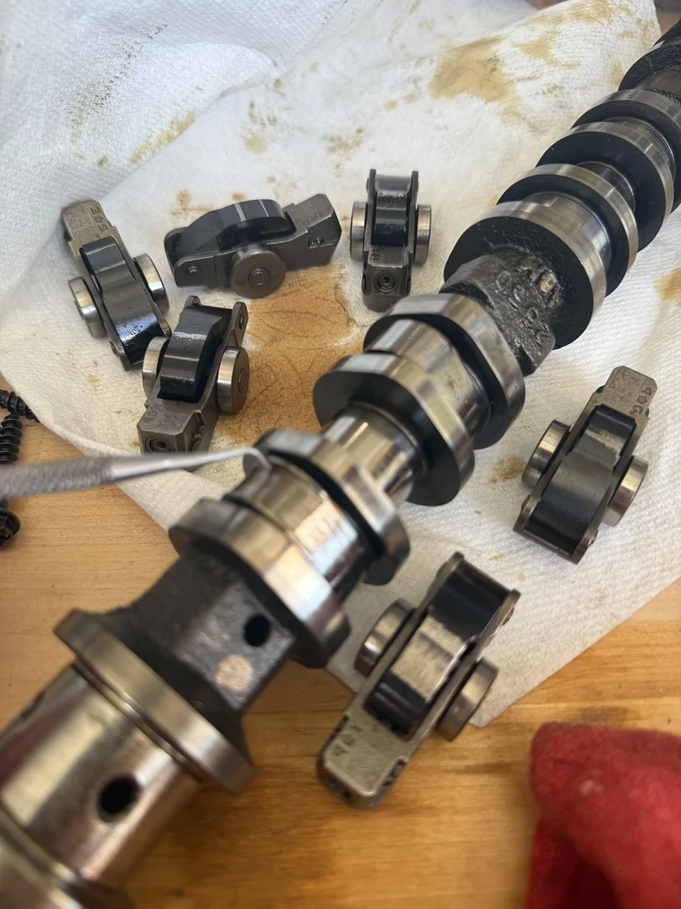

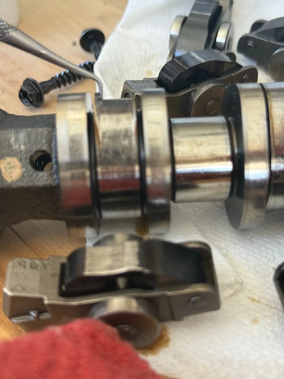

Update:
1. Cam kit came unexpectedly early, like 4 weeks early. We were on a short vacation when it arrived.
2. I found during later research that the cam phaser & timing chain tool kits are almost worthless because they're for VVT instead of VVL engines, so I had to order the $110 tensioner tool. The phaser blocks "work" - I just trimmed the upper and lower edges so it fits the radius better.
3. I thought about documenting the process for future reference. But I'd rather have unqualified success than documented failure. :D Plus I don't want the Internet to see my dirty JT.
Quick background: Last summer in the deserts of Arizona and California I picked up a miss. Thought it was bad gas. In testing it around, anything over 5k RPM would trigger a misfire in Cyl 1.
I parked it until I could deal with it. Over the past year it's been driven sparingly. About 2800 miles since last July.
The tech doc I have says "requires new xxxxx" due to differences in phasers
But you figured it out! Bravo.
