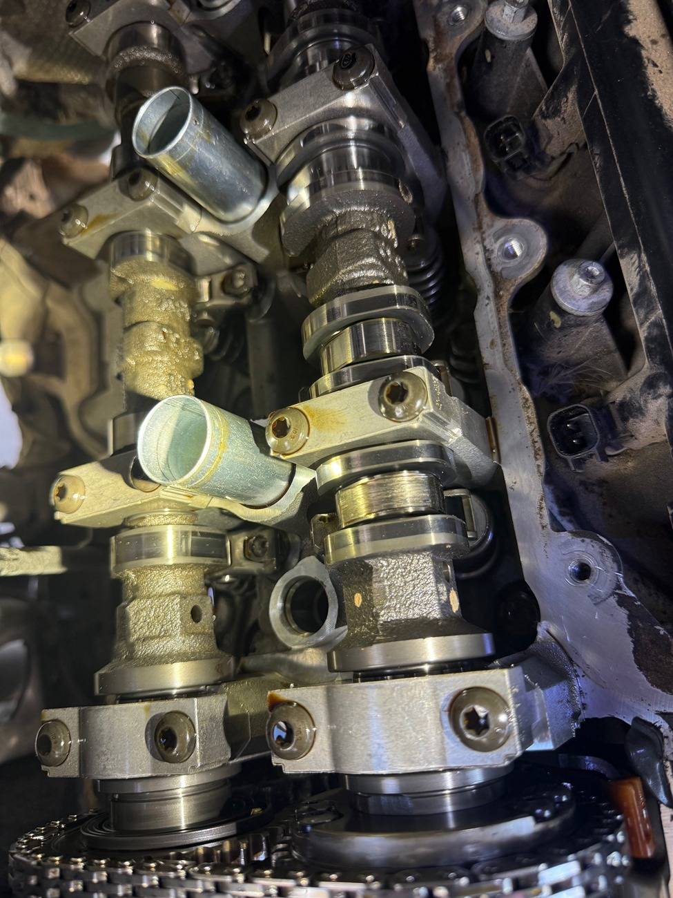

Hello boys, I'm baaaack.
Add me to the list. ~63,000-ish miles. At least there's no metal shavings to be found.
Jeep Gladiator 3.6 Engine Tick IMG_3040
If anyone's tracking symptoms:
It's always had a little tick/pressure sound.
Then came the louder tick around 60,000mi (missed it by *that* much) which sounded more like an exhaust leak - it never really got loud or fluctuated with RPMs.
Gas mileage is irrelevant; I haven't regeared after putting 37s on and lifting it ~3".
Tossed the misfire Cyl 1 code a handful of times. I was able to determine this misfire would happen at/above 5000 RPMs.
Power didn't seem to decrease. Once I found when the misfire would occur, I would drive it gingerly and sparingly.
When it happened, we were not in an area conducive to inexpensive mechanical aid. After a while it didn't get worse, so I just babied it until we got home.
251
40,625
54,356
They are there, small, in the oil filter for the most part.
Do two oil changes in fairly quick succession. Change it, drive it a bit, change it again.
It often won't - not as far as what you "feel", depending on how many were ground off and how far the cam profile is compromised. It will have more impact at high RPM than typical driving speeds.
You are in low lift unless it determines more power is needed, then kicks to high lift mode, but with one lobe of one cylinder compromised, it's likely not something you'll "feel".
