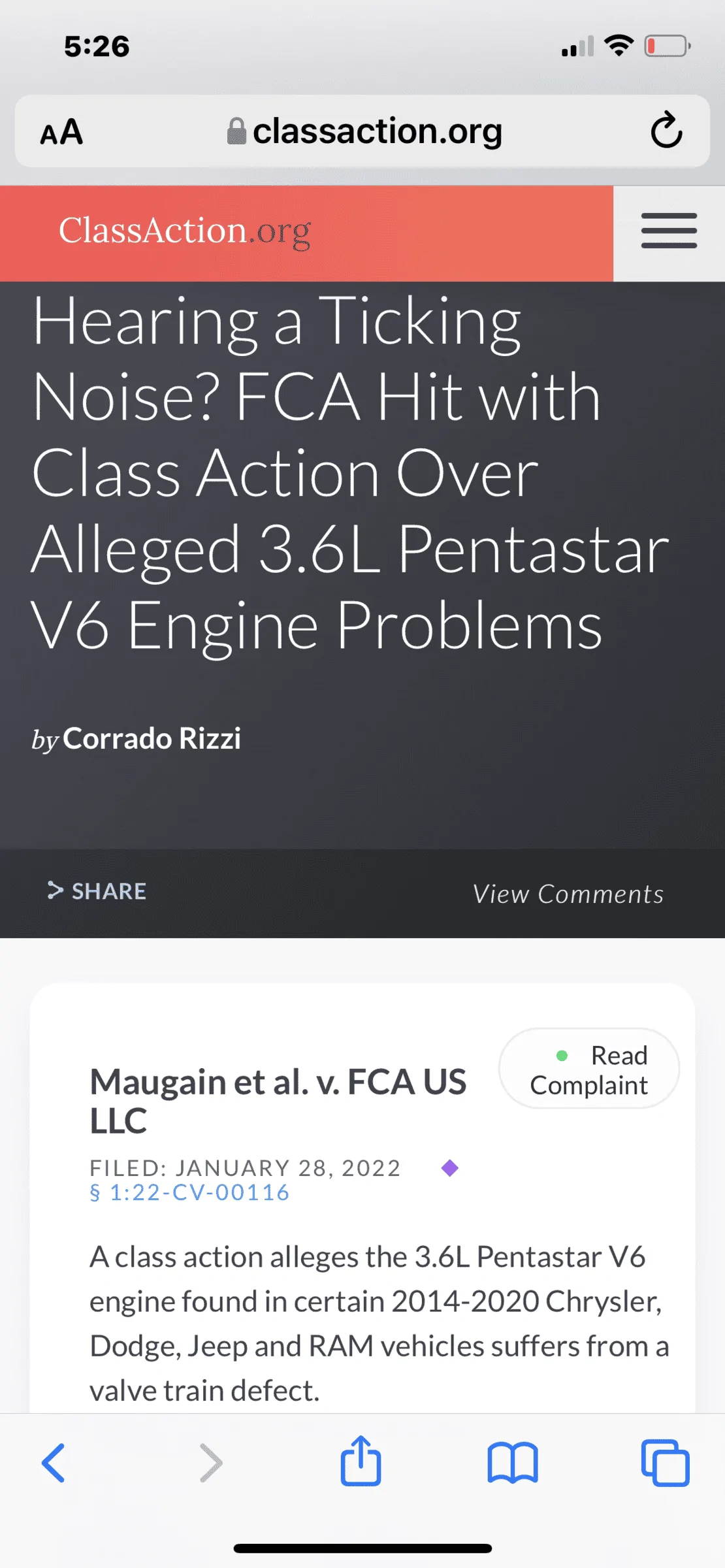

Yeah, that class action thing has been posted here in other threads - but their years just make little sense. Major changes were made to how things were handled in about 2015. There are millions of the 3.6 engines on the road and this makes it sound like you WILL have problems if you own one. Naw, we've owned several, nary a tick.
just be glad these arent direct injected
Another disadvantage of direct injection - oily deposits on the intake valves.......

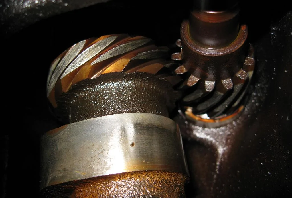

Poor maintenance ->
Jeep Gladiator Engine Ticking Sound cam-dist-gear-0055
Contrary to what people claim on the web out there, engines exist that aren't strictly roller type valve trains. These experience forces, frictions, similar to the "old flat tappet" engines of the last century.
That means maintenance is important, and the same things that caused issues in the past can cause issues today - manufacturing issues, materials not properly treated - nitriding, carburizing, induction hardening.............
Not sure what these would go through without digging, but is it the follower or rocker, or the cam itself? At least the old school cam design saw the lifters constantly rotating, these simply drag across the cam lobe (well, unless riding the rollers on the edge lobes)
One company has shown that your old school roller lifters with bearings were problematic so they went to a bushing type system. Too much concentrated force on the roller bearing needles.
