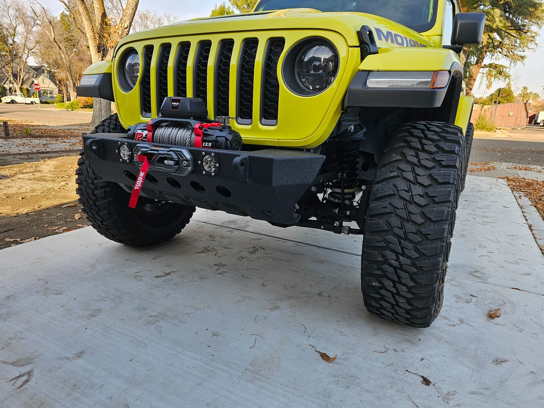

The reservoirs don't mount to the skid plate, they mount to the mounts above the skid. Do these have to be removed with the rough country bumper? If you can leave the frame brackets that the reservoirs are mounted to and simply bolt up their bumper and skid you're good to go. My aftermarket stubby bumper didn't come with a skid, but I was able to keep the factory skid and brackets so I didn't have to deal with reservoir mounts at all. Painted it with rattle can be liner as I wasn't a fan of the silver.

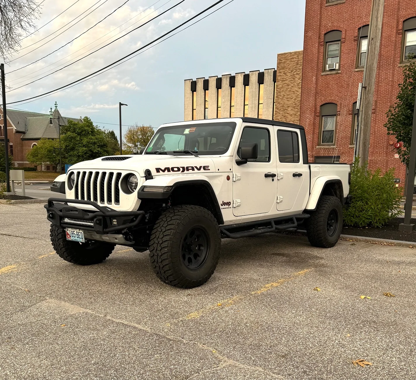

I have the RC front and rear tubular bumpers on my Mojave. I just used the factory Mojave skid plate and didnā€˜t need to touch or relocate the reservoirs. It looks better with the factory skid plate instead of the RC one in my opinion.
