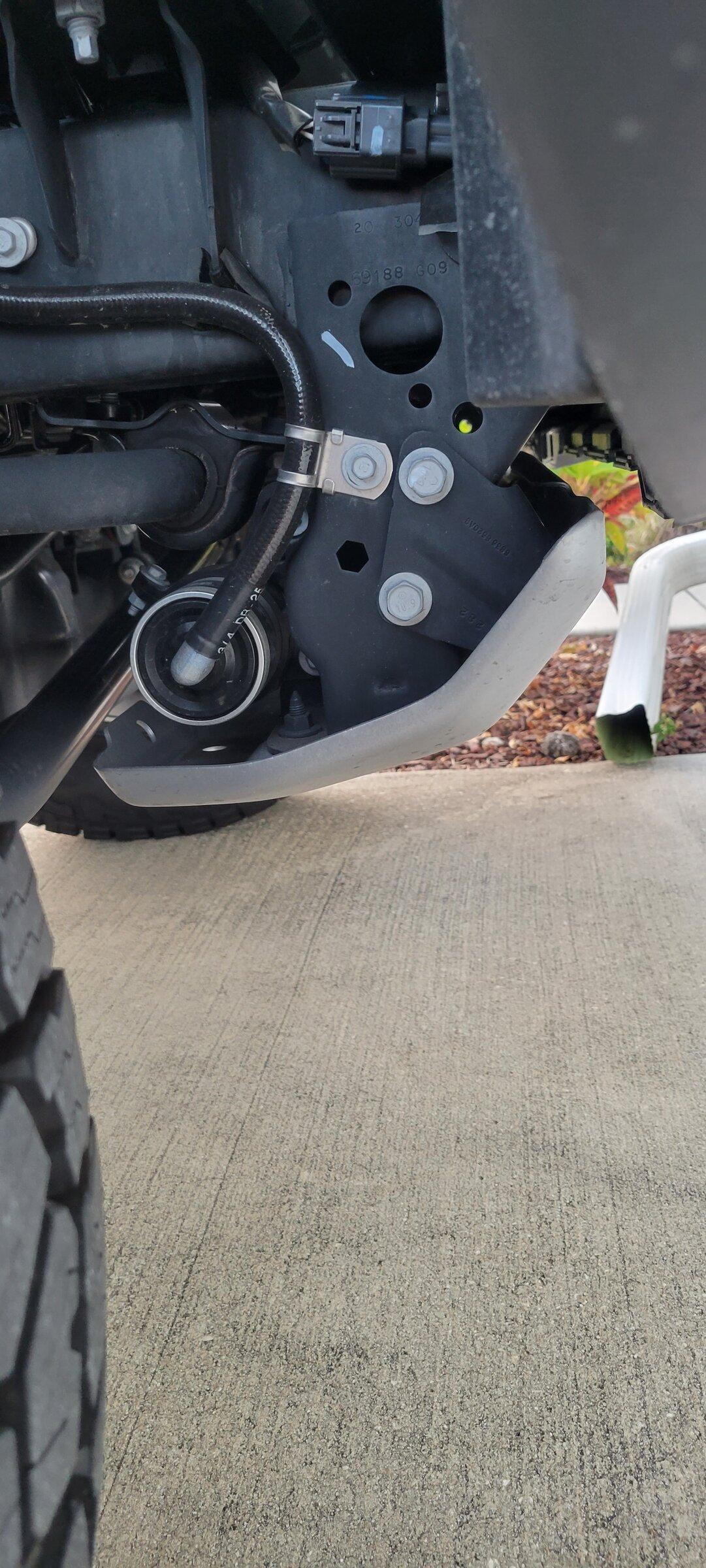

Sorry if this has been asked before. I read a 12 page thread about people putting Mopar steel bumpers on Mojaves and all the compatibility issues they had with the Mojave skid plate, but I never saw anyone address this specifically:
On my Mojave, if I put on the Mopar steel front bumper and skid plate, would that skid plate sufficiently cover the shock reservoirs like the Mojave plate does? I'm trying to avoid having to cut and grind steel if I can... lol
Pics would help if you have them!
Jeep Gladiator Rubi Steel Skid Plate + Mojave Shock Reservoirs? 20220109_172800

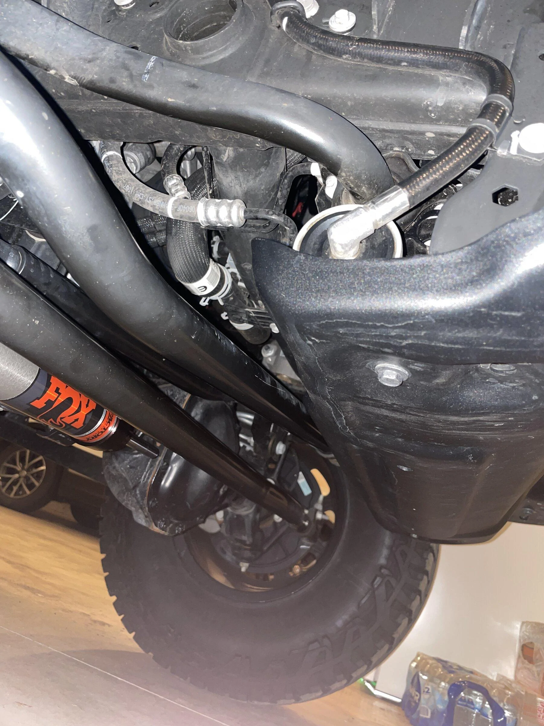

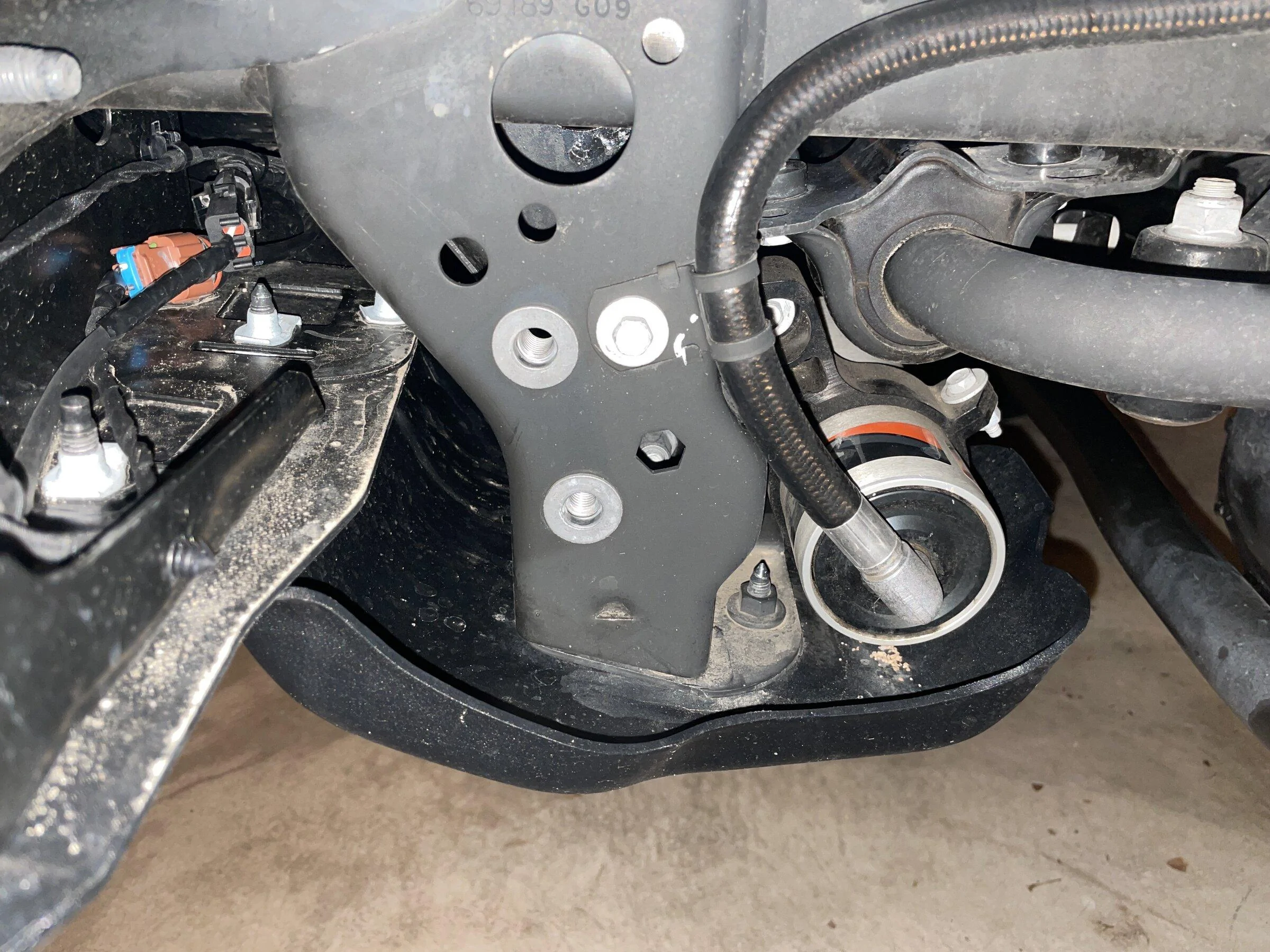

On my Mojave, I installed the Mopar steel bumper - then I purchased the rubicon steel plate, it perfectly protects the shock reservoirs.
I'll try to post some photos later, when I get access to my main pc.

The Mojave skid plate acts independent of the front bumper thus why it comes with the plastic bumper, unfortunately it does not fit (unless you cut it) to the Mopar rubicon metal bumper.
The rubicon metal skid plate attaches to the front bumper, and two mounting points on the frame so it's a different design, thankfully it protects the front fox reservoirs in a similar manner.

I’m wondering the same thing
Not at all. You pop the Mojave upper brackets off, and the Rubicon skid plate bolts up into the two lower holes where the Mojave skid plate was, and the rest go up into the bumper itself.
