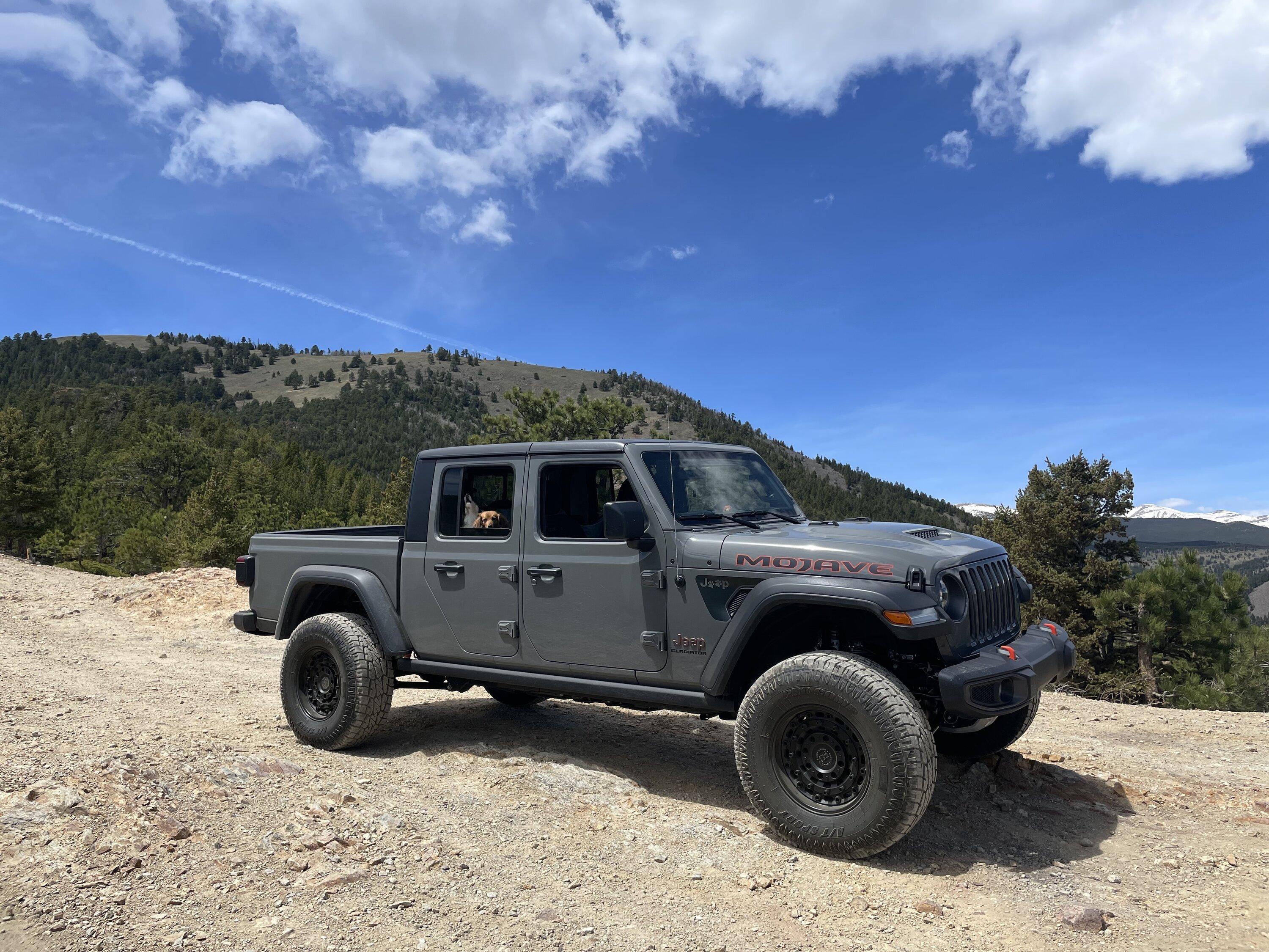

AEV 2" Spacer Life - 35x12.50R17 BFG KO2. I installed the longer MOPAR LCAs and an adjustable track bar. No feel in ride difference vs when it was stock.

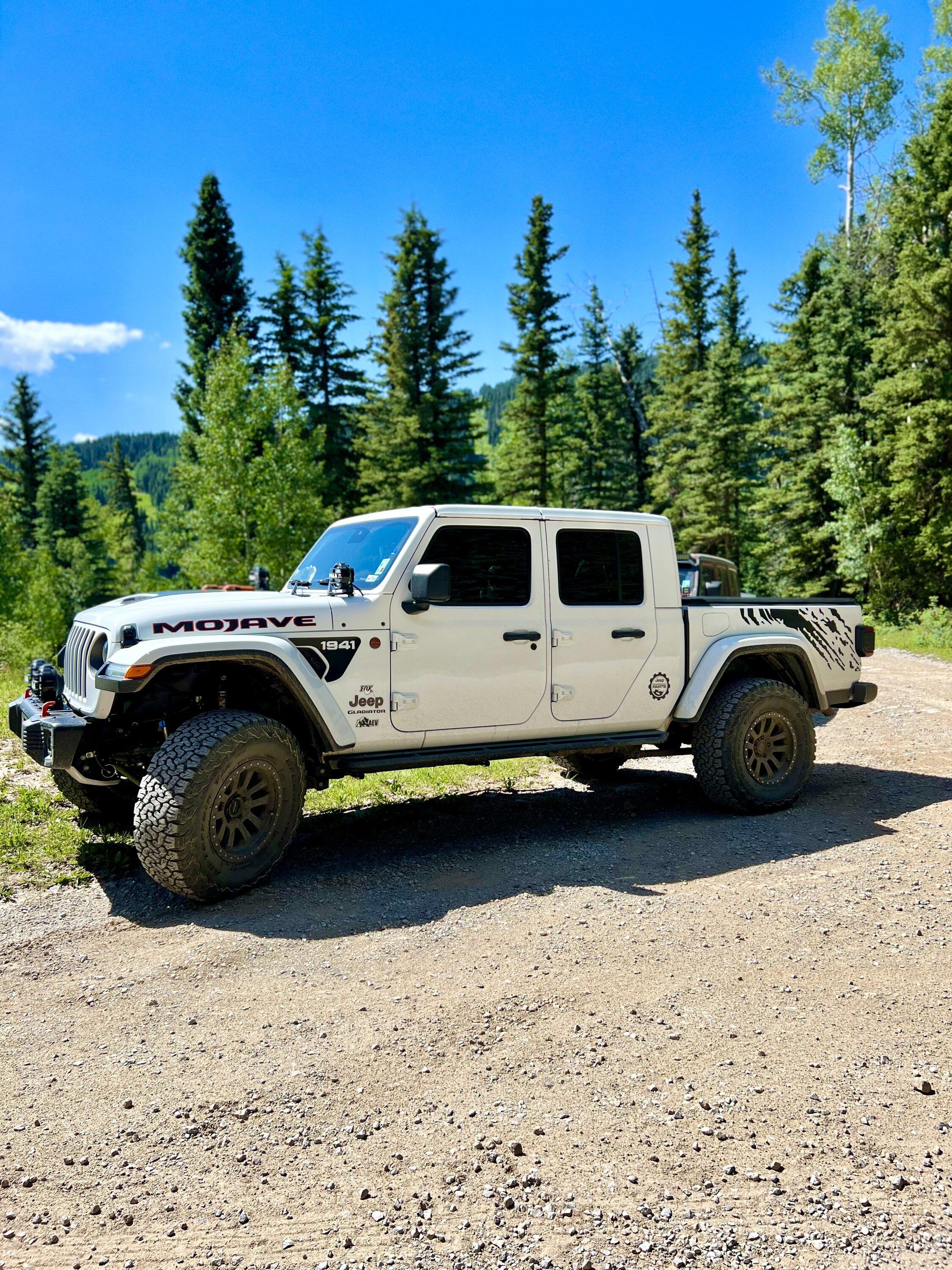

Yup, the only thing I did was correction brackets and aev spacer w/ 37x12.5.
Also added the autolynx quick disconnects.
Great looking Gladiator, did you have any issues with the reservoirs installing the steel bumper? were you able to keep the Mojave skid plate? or did you put the Rubi
No issues. I swapped out the mojave skid for the rubicon. It protects the reservoirs quite nice. Everything is straight bolt on, no need to cut anything.
and i like the black instead of the silver skid plate which is a plus

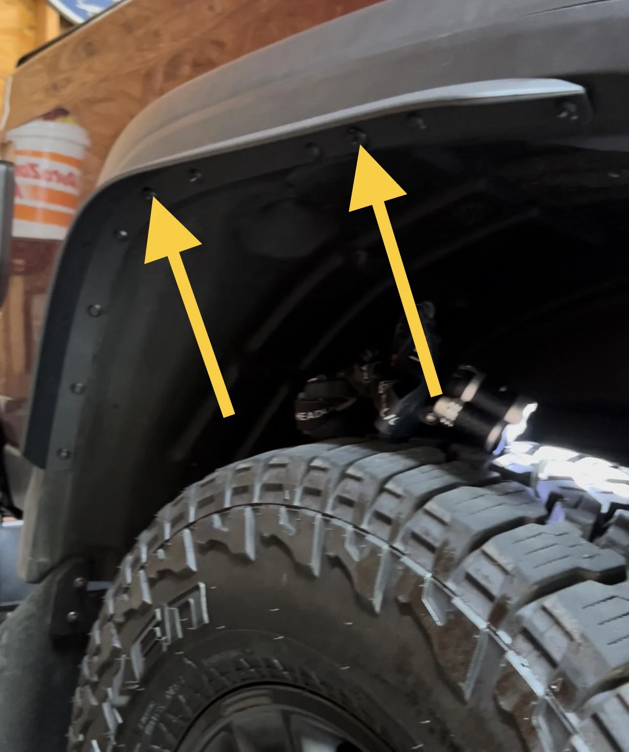

Where did you get the fender flare extensions ? Can we use the wrangler extreme recon ones in the rear ?
I got the flares from All Mopar Parts, they are *only* for the Wrangler. There are quite a few threads/ posts on how to utilize them for the rear of the Gladiator. Some guys have cut the inner “lip” to get the bend radius, some have used an extra set of fronts and modified by cutting them shorter.
All I did was align them and add two extra rivets to tighten them to the fender flare (with the arrows). I drilled out all factory rivets that would be behind the flare and started with riveting the one closest to the front of the cab, then worked my way to the rear.
However I had to drill all NEW holes through the fender flare, as only the first one aligned with a factory hole (it would be really hard to find where to drill new holes in the extension, but maybe it could be done vs drilling additional holes into your fender flare). But as I worked my way down, I just kept holding the flare extension TIGHT to the fender flare to ensure I had a snug fit, then drilled pilot holes, then holes to size for the rivets. Hope this helps.
Sorry for the crappy pic, I took it from a video I took lol.
