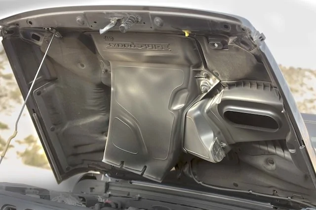

The wrangler 392 and the gladiator Mojave share the same hood. The difference between the two is that the 392 has a functional hood scoop and the one on the Mojave comes from the factory non-functional. Sure we can remove the hood liner and mod the intake to be functional, but does anyone sell a kit that does everything for us? My biggest issue would be water ingestion, (which the factory Mopar intake handles).
Jeep Gladiator Mojave ram air intake 3 Rubicon 392 photo J

That looks like it'd require relocating a lot of the air intake system.
