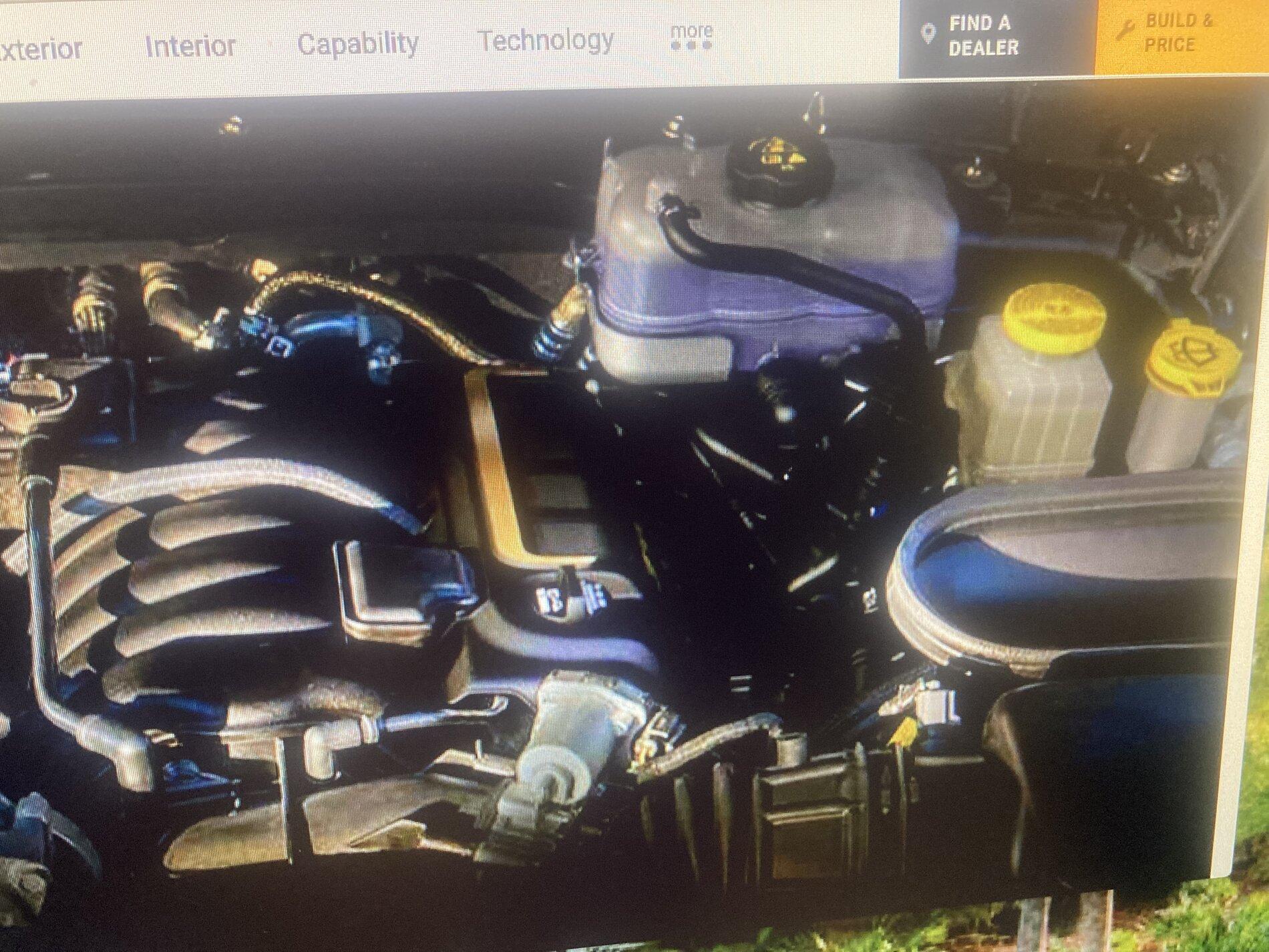

Jeep Gladiator Hood scoop Cold Air Intake (CAI) System for MOJAVE AC412274-35AE-47EF-B39D-450532AFD78D
Lower right corner of picture is the 392 air box where hood scoop directly provides air to engine.....Jack
