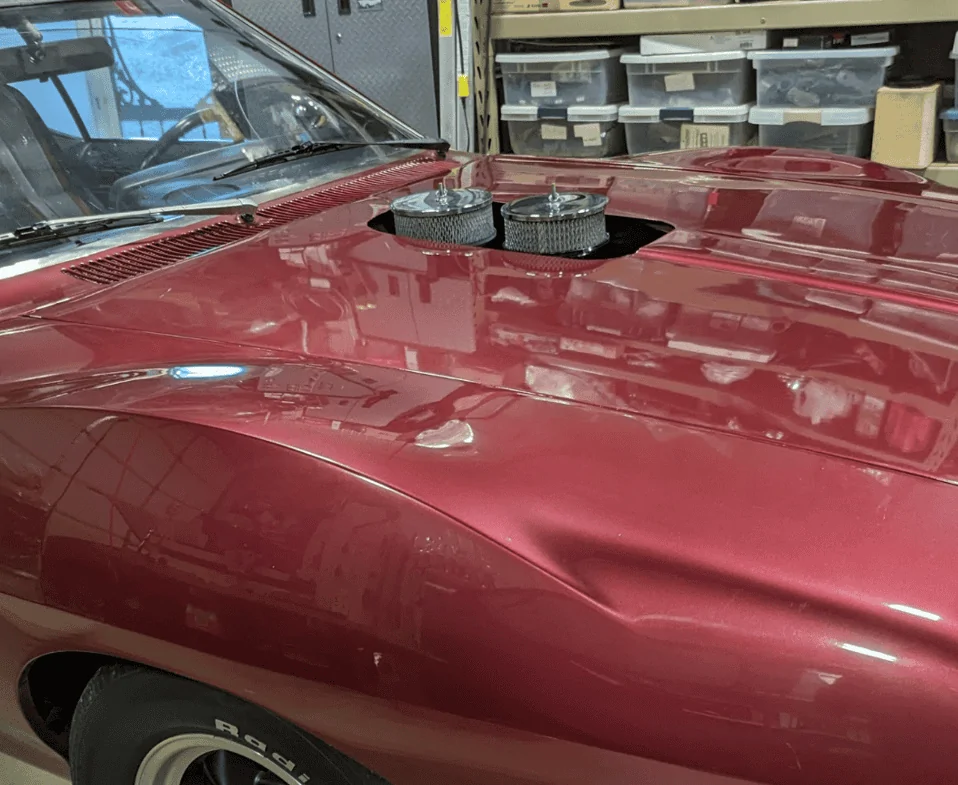

The filters below are supporting a bored 360 ci engine (more like 367 now) putting out close to 400 hp - so you would figure 367 cubic inches at xx rpm would pull yy cfm and figure air filters and carburetion for that.
The 3.6 liter is about 220 cubic inches. A fraction of the engine below.
Of course the throttle body and intake manifold come into play in the 3.6 engine
