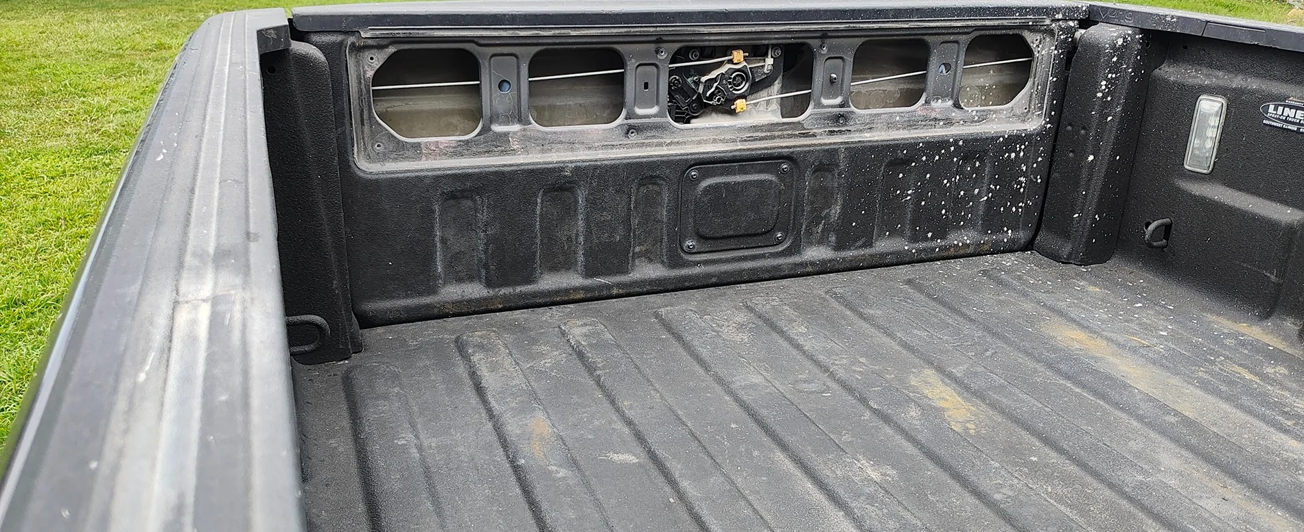

There was a tsb on a couple years of tailgate. The mechanism is kinda sloppy, and I can tell on mine the bed and tailgate aren't totally square with each other. With the gate down, one of the cables is always a little slack despite sitting as level visually determinable. Sometimes I have to close mine twice to get both sides to latch, I suspect the plastic 'things' that adjust the latch rods. This picture might help, had to take a piece to the shop, bed liner started flaking. The yellow pieces are the ones I suspect.

I bet they are square to each other. You more than likely need to adjust the striker pin on the bed. I did that in the first few days of owning mine new. The left side would latch sooner than the right. So i adjusted the striker pin and now both sides latch at the same time. As for your cable, you can also adjust that on the tail gate.
Thanks for the advice, it's never been a big enough PITA to get after it, might be next on the list after the busted u joint and windshield.

Fair point, I'll go back to the latches and if they're dialed in properly, then I'll go after the yellow plastic cubes from my earlier picture. They hold the actuator rods that unlocks the gate, plastic threads vs metal threads.... Just saying
