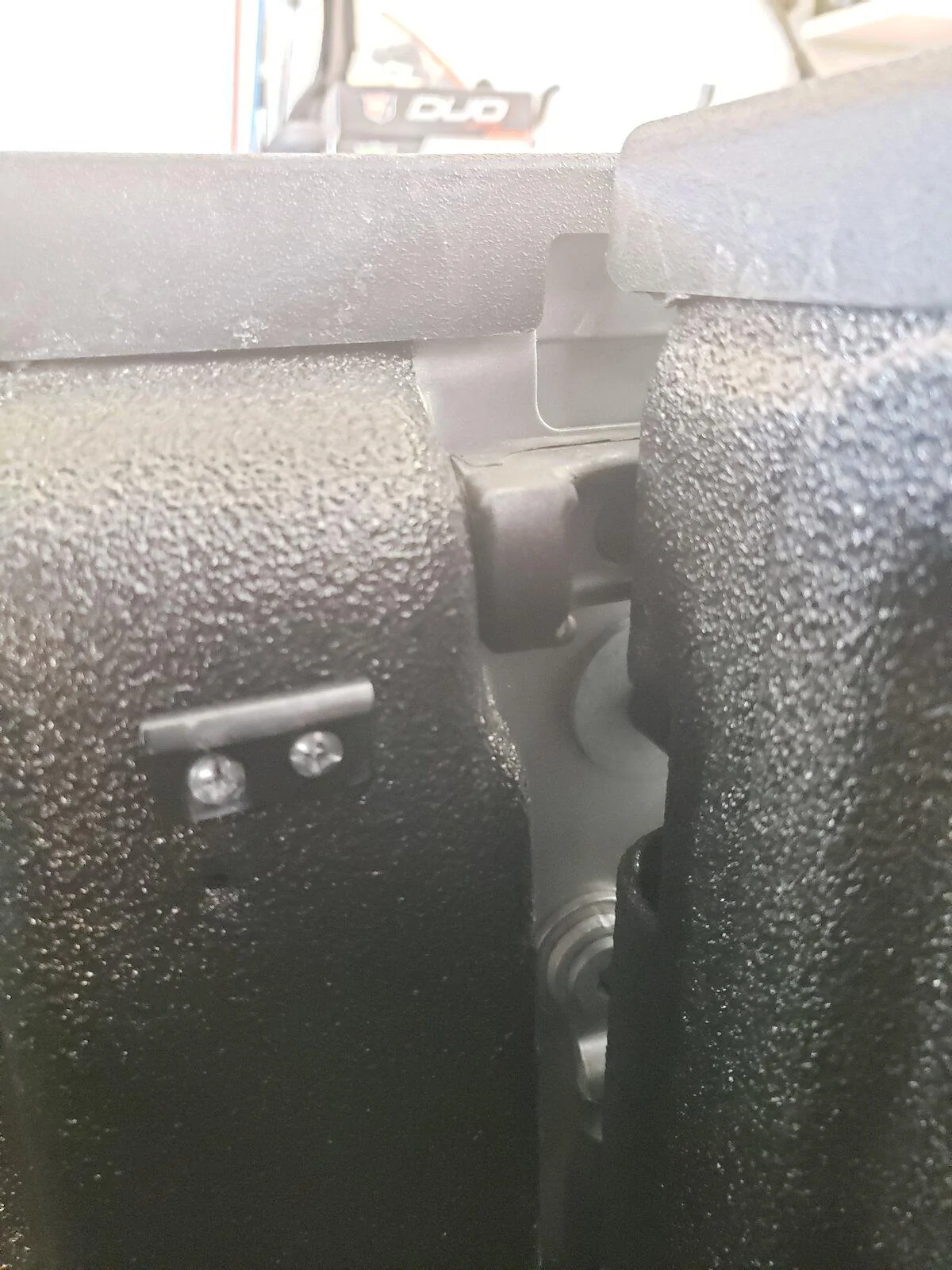

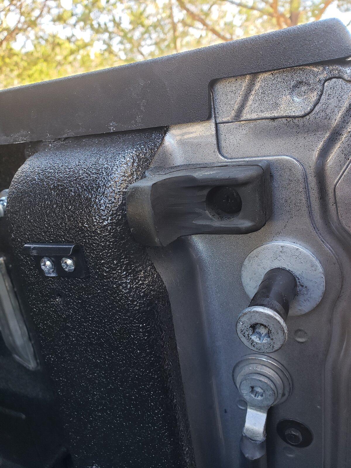

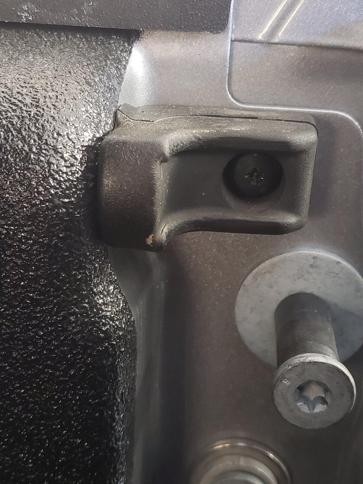

Hey y'all. I know this is an old thread and maybe this has been answered elsewhere but I was having the same problem and I think I found what it was.
By chance do those who are experiencing this have sprayed in bedliners? What i found was the thickness of the liner bumps up against the rubber bumper thus not letting the latch lock securely. It does seem more prominent on the right side as mentioned already.
I took a Dremel to the rubber to just knock off the extra ribs and my gate now closes smoothly and latches every time.
Hope this helps someone with the issue.
